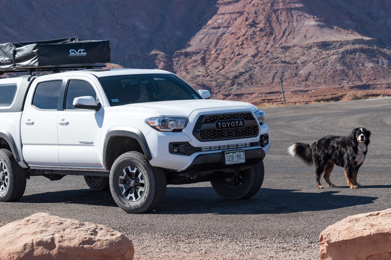

    All the things...click the link in sig
    Thanks, its a working progress!

    what lift are you running? truck looks great!

    thanks - Bilstein 6112/5160 Combo with Medium Duty Dakar Leafs - ended up with about 1.5 inches all around after settling. Rides great!

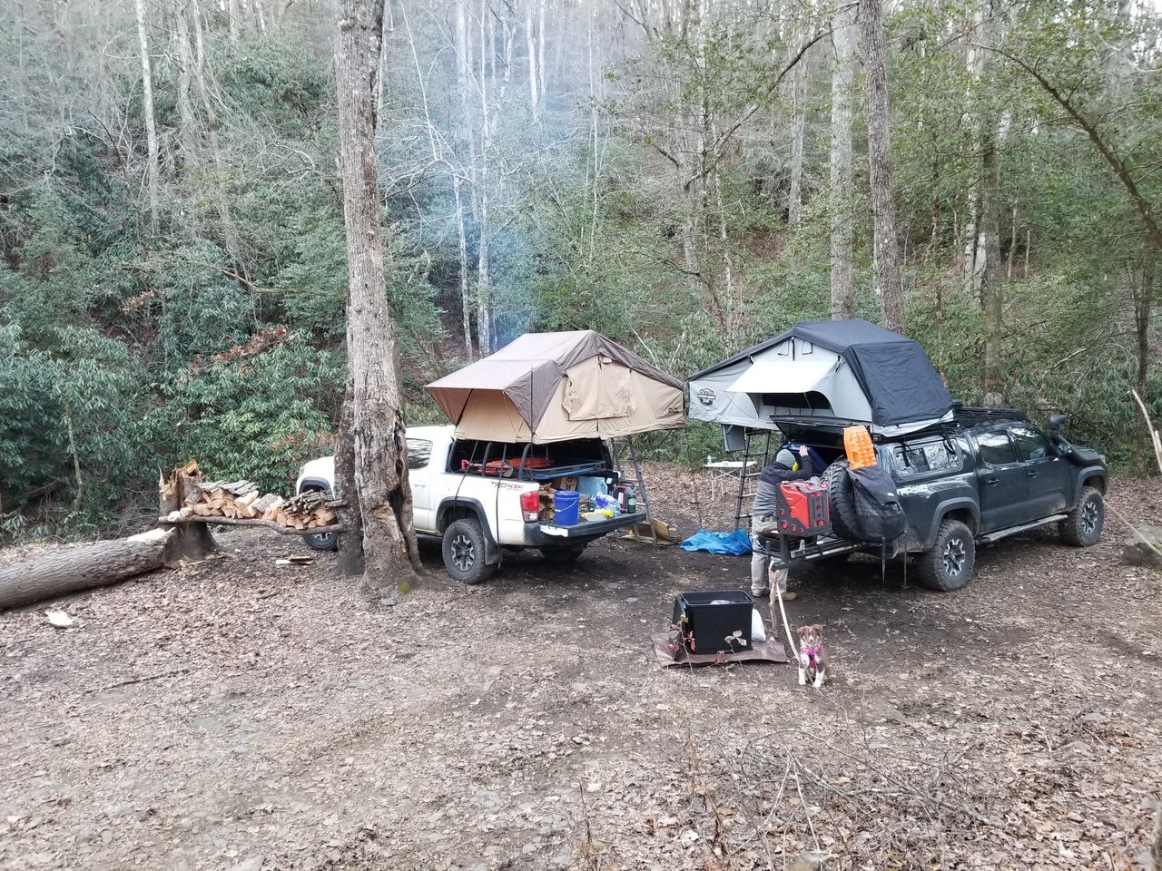

    To do it right, you need heavy leaf pack.
    upTOPOverland_Drew likes this.

    I run dakar heavy duty leaf pack. When loaded with 200lbs or over the ride is smooth as butter. The newer HD leaf pack does not squeek like the older ones did. I am happy with the performance so far.

    The Black truck is similar in weight you're talking about. It took a full heavy set of OME to level. The white truck has medium OME20171230_165905.jpg
    HeadStrong Off-Road and Mountain like this.
