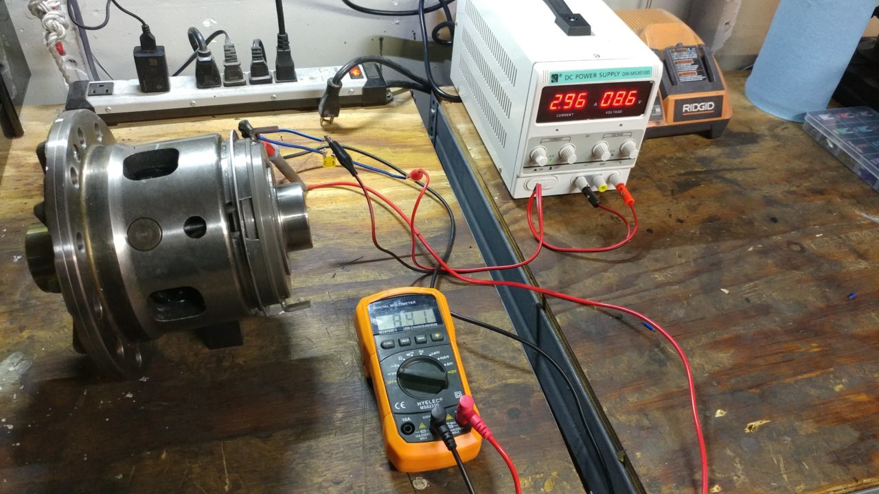

    Alright... first night of testing is complete. I had good locking action at 3A and 9V all the way up to 4A and 12V. I watched heat and resistance for about 20 minutes with no appreciable change even at the higher amperage. Resistors, diodes, and potentiometer on the way. I will get this on the bench later this week. Steps in the right direction.

    While holding voltage at 9v, how does current compare locked vs unlocked?
    (With 9v applied, Does it stay at about 3 amps if the teeth are aligned vs unaligned?)
    If current stays pretty constant regardless of locked or unlocked, I would definitely just go with resistor (and diode) with relay control.
    Nice benchtest

    Worked through a few more tests last night, no change in amperage at all when locking even with teeth non-aligned. I held it for 2 hours at 3.8A and around 9V with no issues. Just waiting on a few parts to finish the full test wiring.

    Sounds great. I would get a resistor dialed in to give you roughly that with the truck running at about 14v.. rig up a relay and a flyback diode and do it.
    Way to jump in, get some parts and try it out.

    Well, a bit of an issue today. It must have been too cold the other night in my garage to provide reliable temps. Today when running 3.5A and 9ish volts, the locker gained 2deg F over 10 minutes but built no resistance. I think I will need to run it at 2.5A and 8V to keep temps down, that seemed to be the right mix of locking and temp control.
    25A resistors aren't enough, will need to go with 100A for temp control.

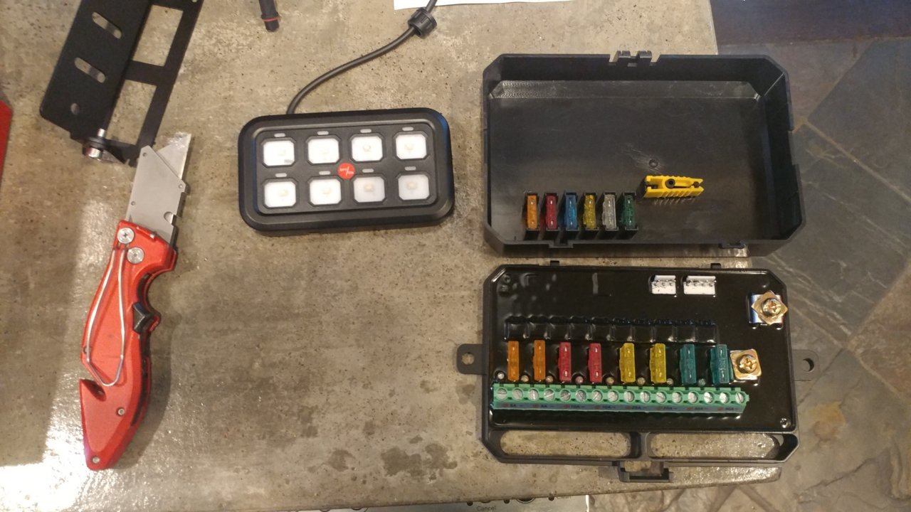

    Well residency is killing my free time but I bought an off brand switchpro to test out. The 5A slot is perfect, sending just under 5A and 12V. I will put in a 1.5ohm 100W resistor to knock it down just a bit but this should be the ticket.
