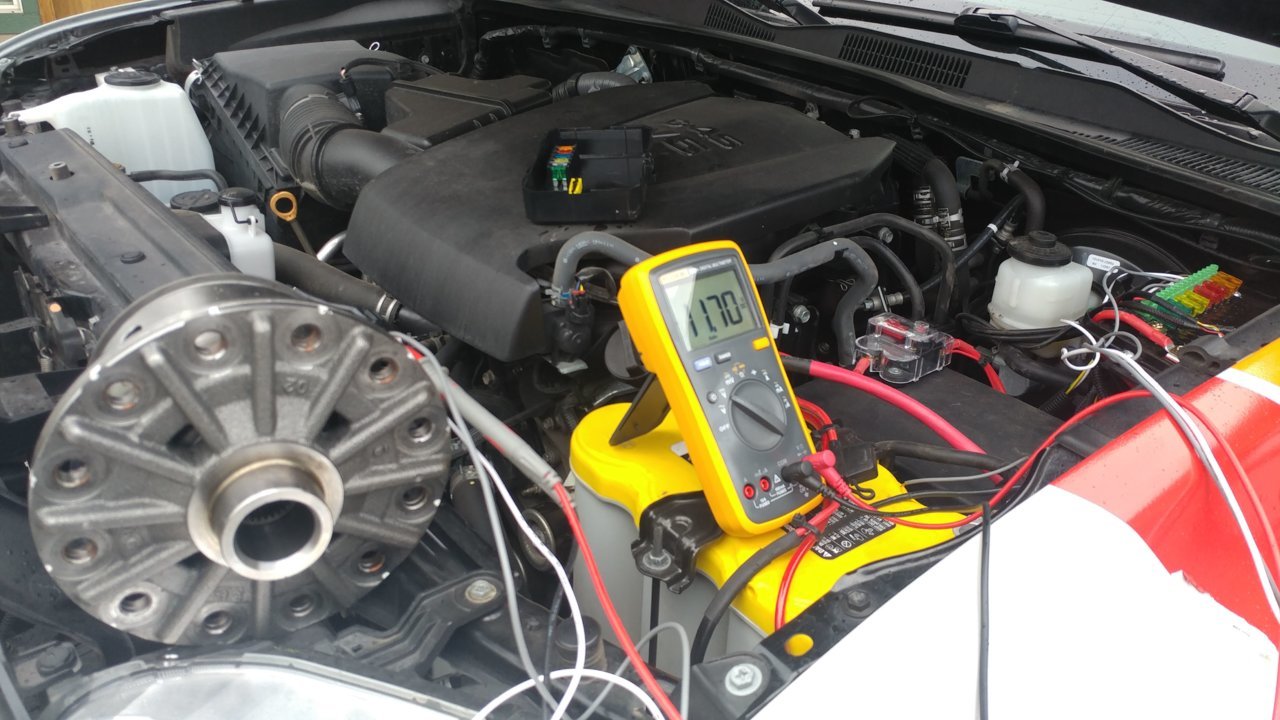

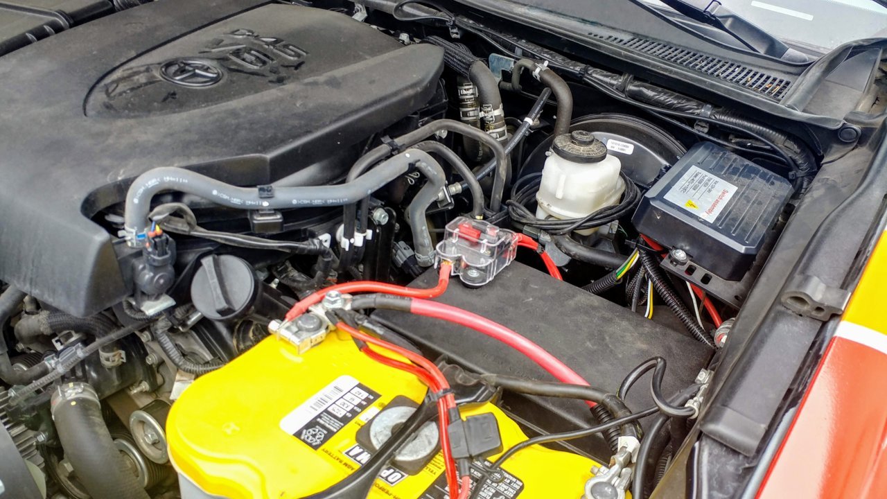

    Alright, snow has finally melted enough to get some work done. Final test today before the locker goes in this weekend. Everything looks good off the 5A circuit with good locking action and no overheat issues. Still trying to source the correct bulkhead fitting for the 3rd member.

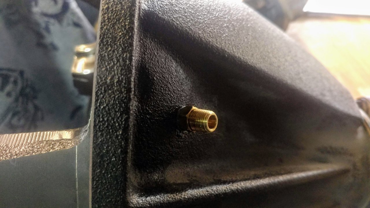

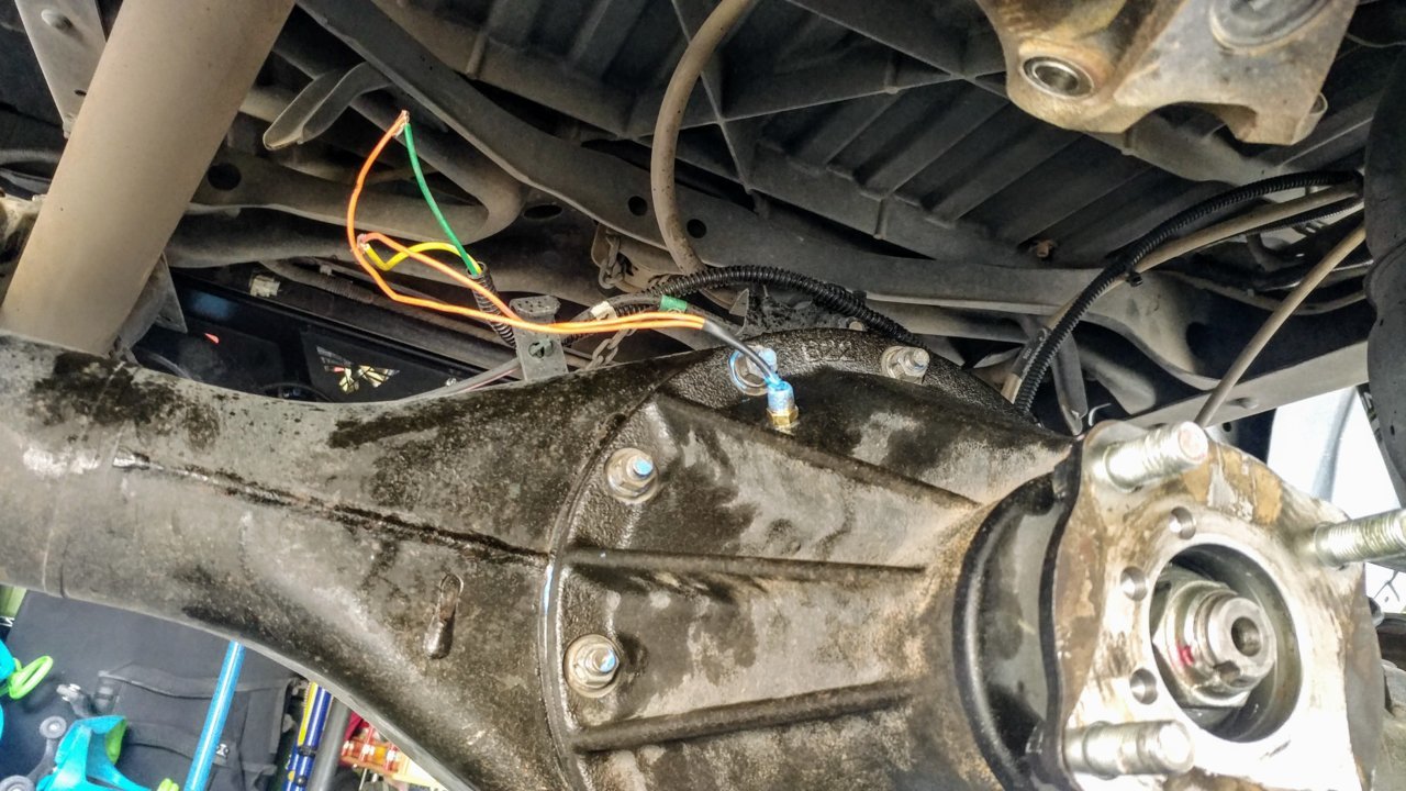

    Next, I tapped a 1/8in NPT connector into the housing for the wires to go through then filled it with RTV once they were run.

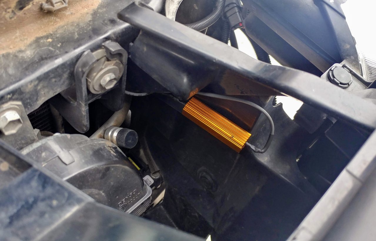

    I ended up putting the resistor right up front in a high airflow area. I will need to watch it for a few weeks so make sure it is not melting the plastic around it.
    Testing the locking mechanism at 3.5A, everything locked up well with no issues engaging
    Just ran it around the neighborhood and the locker works great, full wheel hop on every corner with no disengagement. I cleaned up the wiring at the diff and now have a push button locked rear end to any speed I want!

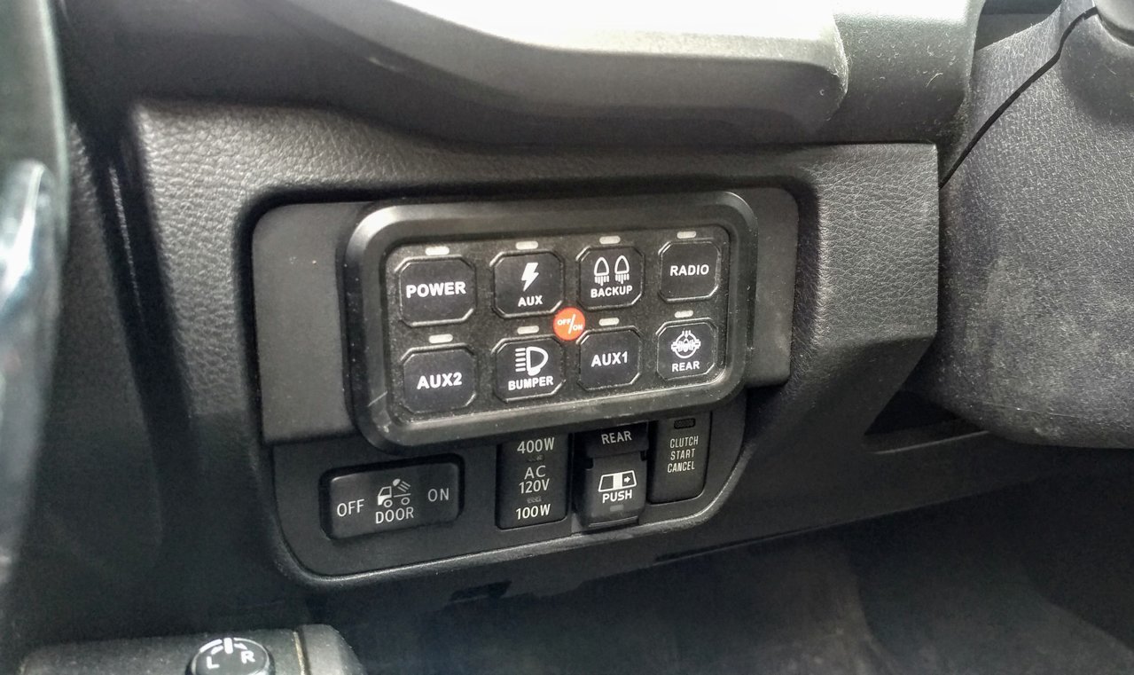

    Nice work! Where did you put the switch? Make sure that if other people drive your truck they don’t accidentally hit it or know to go no faster than 3-5mph when engaging

    Here is the switch setup, fits perfectly in that useless hole in the dash on the left of the wheel. I might put a gate over the locker button just for that reason.

    Not useless, it’s for a brake controller

    Don't run a brake controller and will not need one, so this was a much better fit for that hole. But now I see why that was there.

    I have a second gen and used the factory switch (also left of wheel) to control my Eaton locker and I’ve been thinking about a safety for it also. Haven’t come up with an aesthetically pleasing guard gate for it yet... I might just get a toggle switch I can hide somewhere to kill the locker switch instead

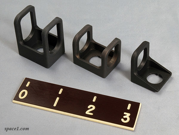

    Yeah, I have been thinking about how to do it and think I am going to glue a 3D printed version of the orion spacecraft ones on there. Something like this:

    So no cpu cooler for now?
    What ohm resistor you running for now?

    Icon stage 4 +3in with spring pack, OV Tuned, total chaos UCAs, Victory 4x4 strike front and rear bumper, Warn 9.5ti winch, full CBI underbody armor, AP kick out sliders, softtopper canopy, method wheels, BFG AT KO2, leather seat kit, Safari snorkel, 4.88 gears, MBRP cat back exhaust.
    Correct, couldn't find a decent spot to mount it and it took up a ton of space. Ended up going with 100A 1.5ohm.

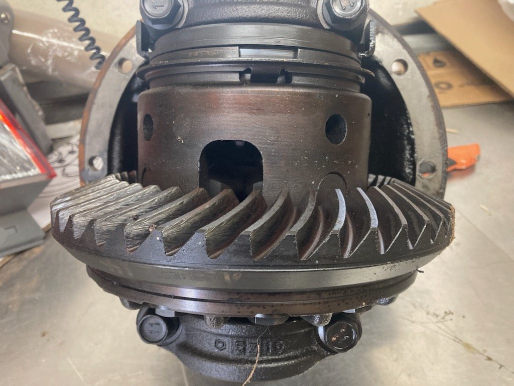

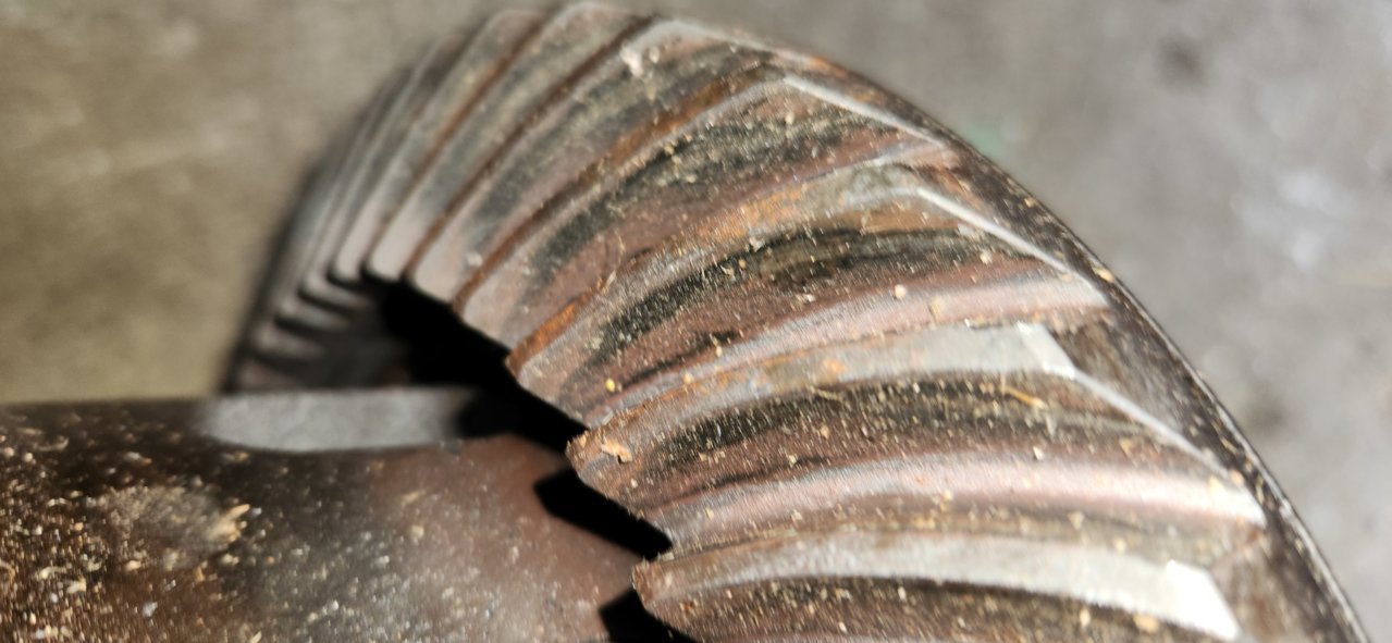

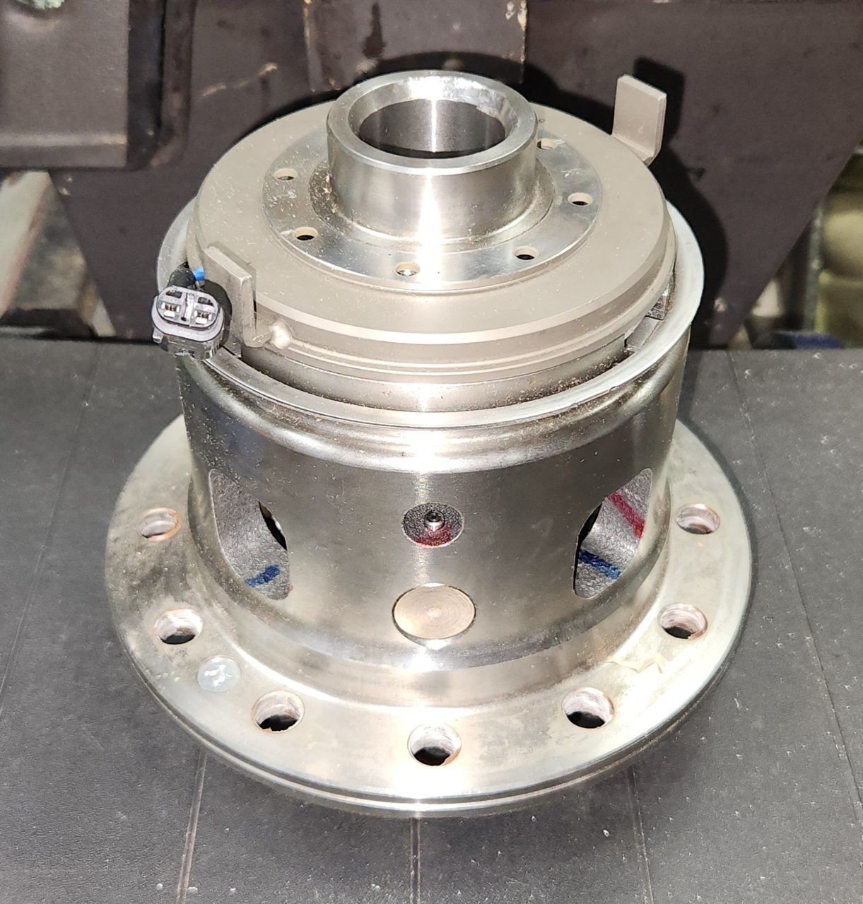

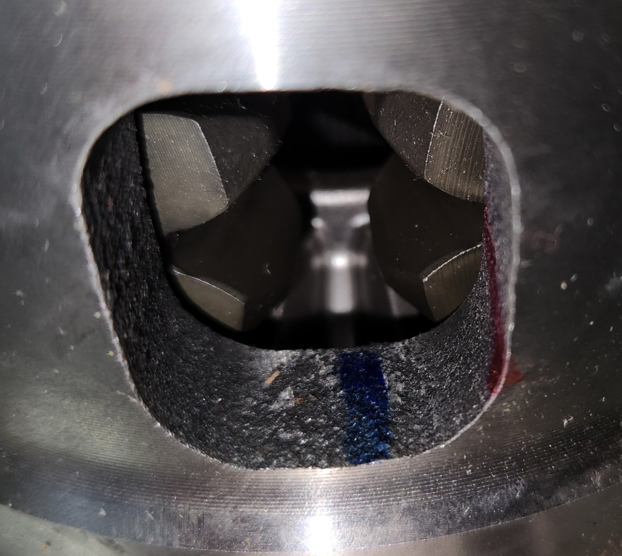

    I have had Drive Train Specialties in my bookmarks since I read this thread. I randomly click on it and check out the factory E-locker... this past week, there was a change... it was priced at $209.95. So...
    I might have ordered one.
    This thing is clean, I see no wear on the side gears.
    So now I start my own testing and see how I can make this work in my truck. I also want to source the factory electrical connector that goes into the third member. Looks like on my days off a trip to a dealership parts counter.

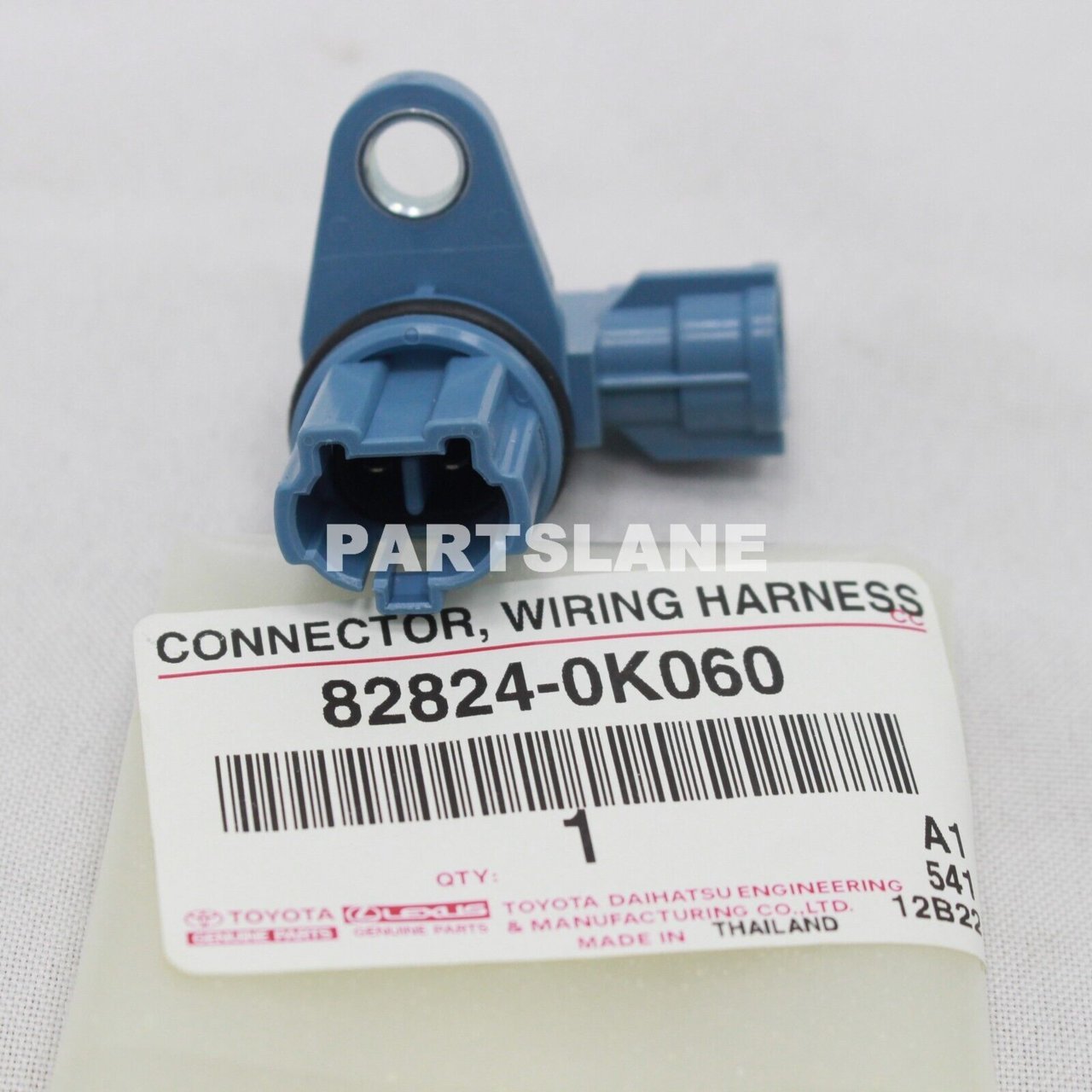

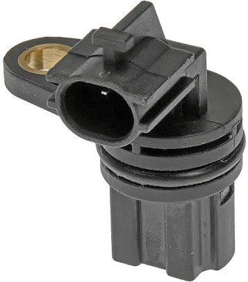

    I did some pretty deep searching, but I believe I finally have a part number for the electrical pass thru connector.
    It also appears that this one from a Jeep :bananadead: will also work. This a Dorman 600-250. Only the external plug is different.
    I will visit the dealer Thursday and see what the original is worth.

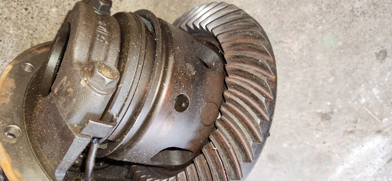

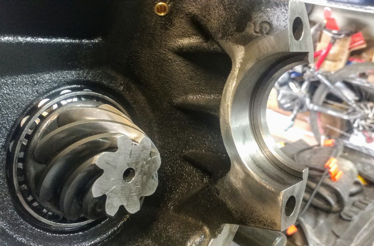

    So I haven't gotten very far with this, and it will be a slow go... I want to do this right. With that in mind, I picked up a core third member from an autowrecker. ( Check you diff fluid! This is most likely the cause of the accident!! )
    I wanted it for the case and the case is fine. This way I can have the correct wiring pass-through and also the locking feedback. This unit is seized, so I can tear down the locker to see how it works and use it to test thermal build up. I will post pictures and test results as they come. I might start a new thread for the tear down of the locker itself.
