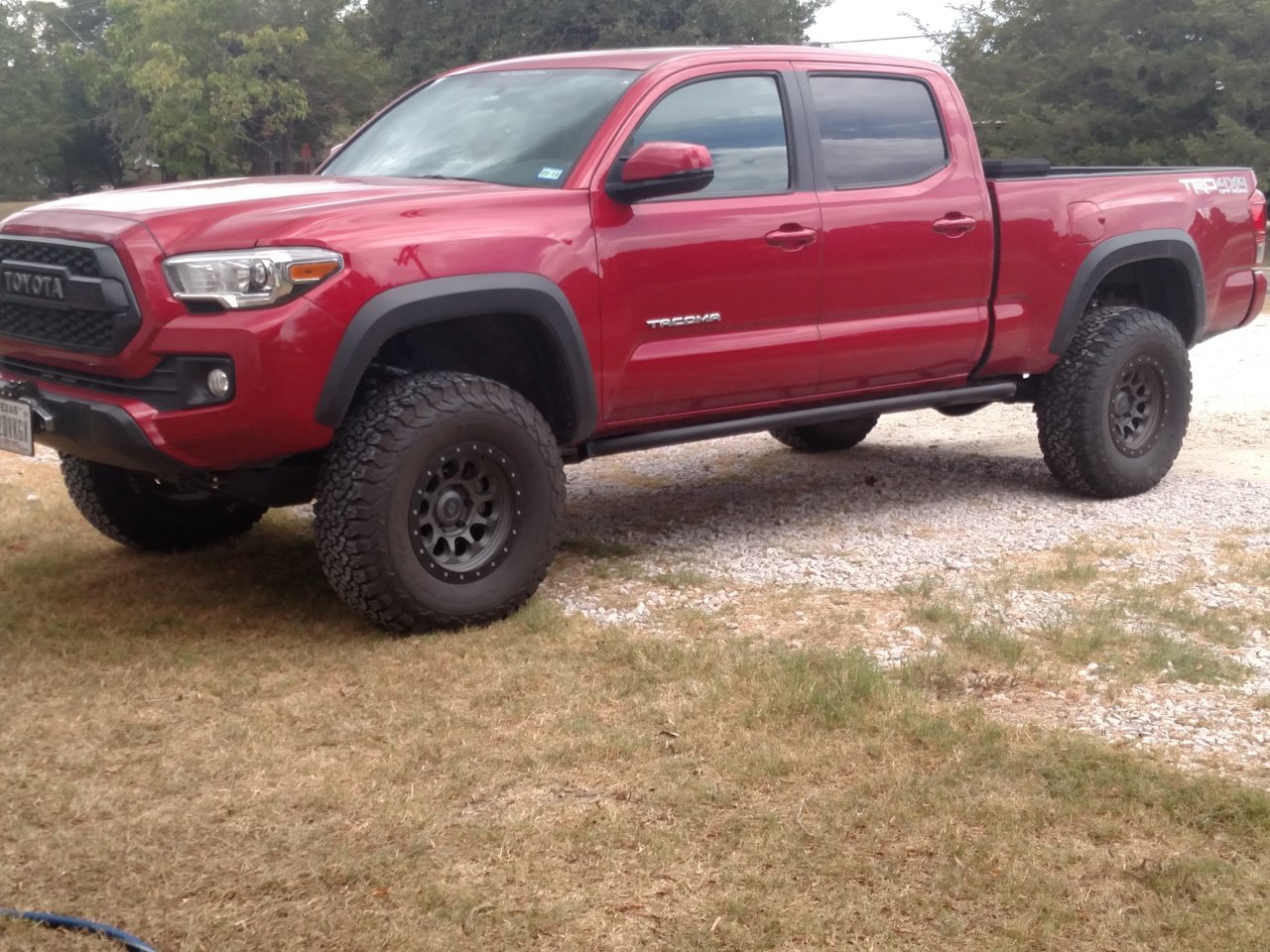

    IMG_20190402_165120795_HDR.jpg Because it may take forever to finish but it will get there eventually.
    Current Pic.

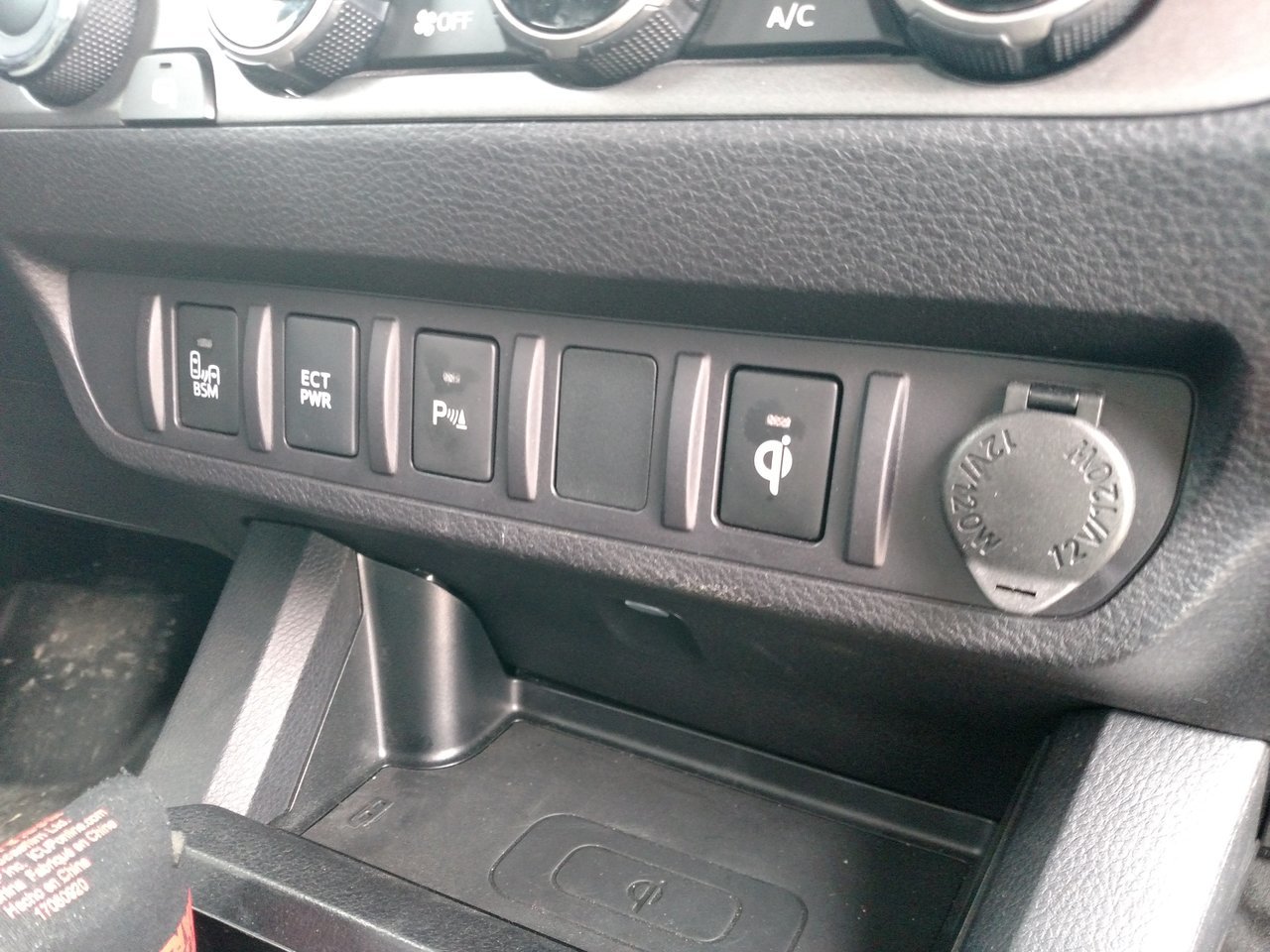

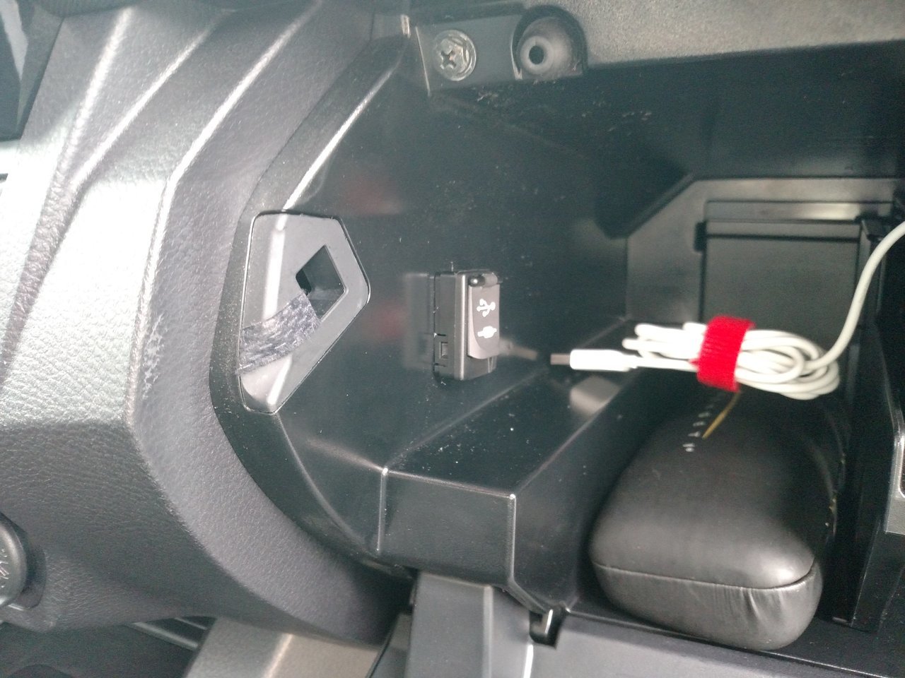

    Small but satisfying mod. Because the damn USB blocks the cupholder when in use. Not anymore! :thumbsup:IMG_20180205_160358844.jpg IMG_20180205_160419806.jpg

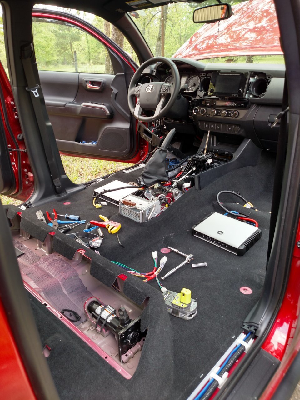

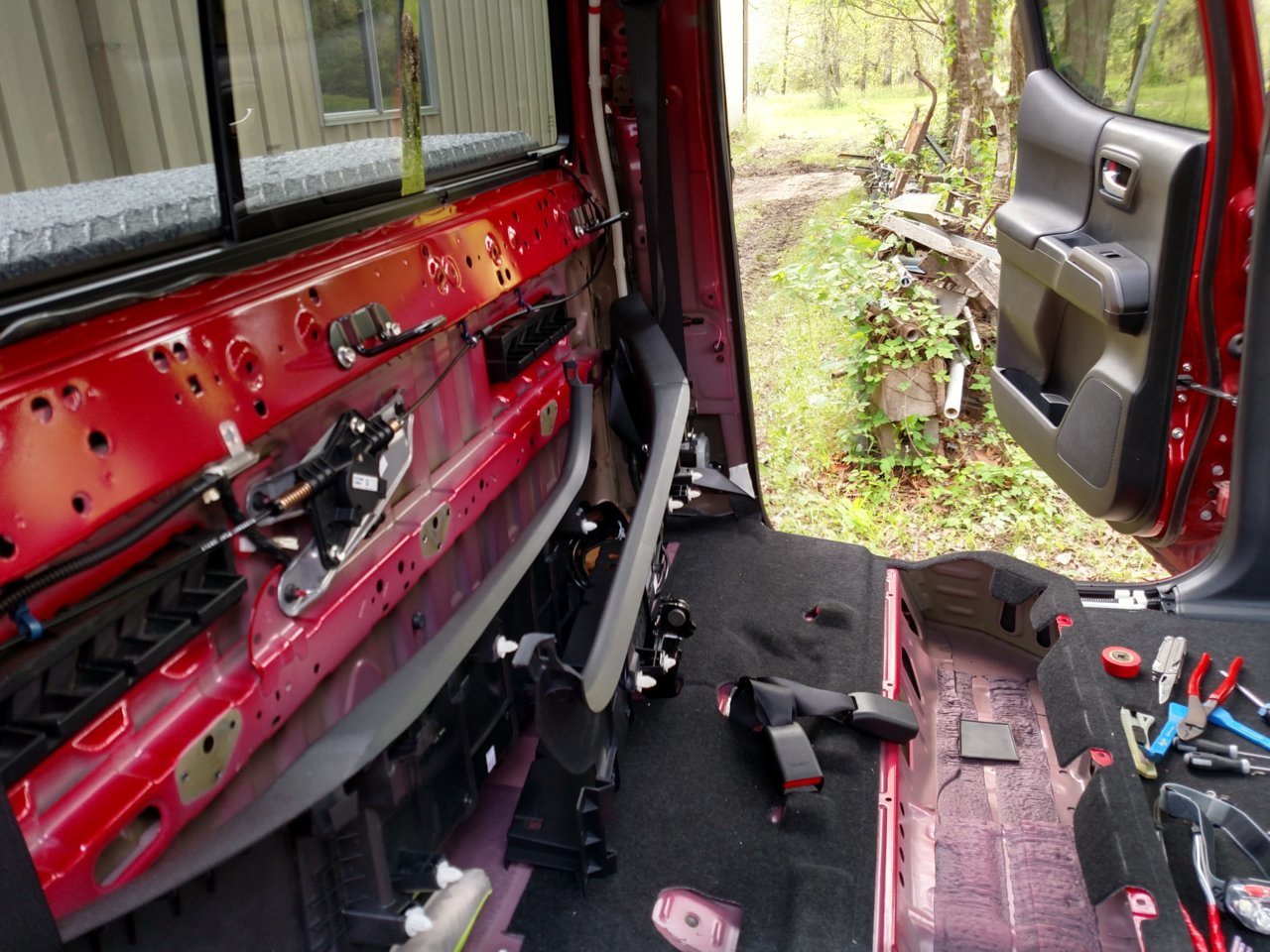

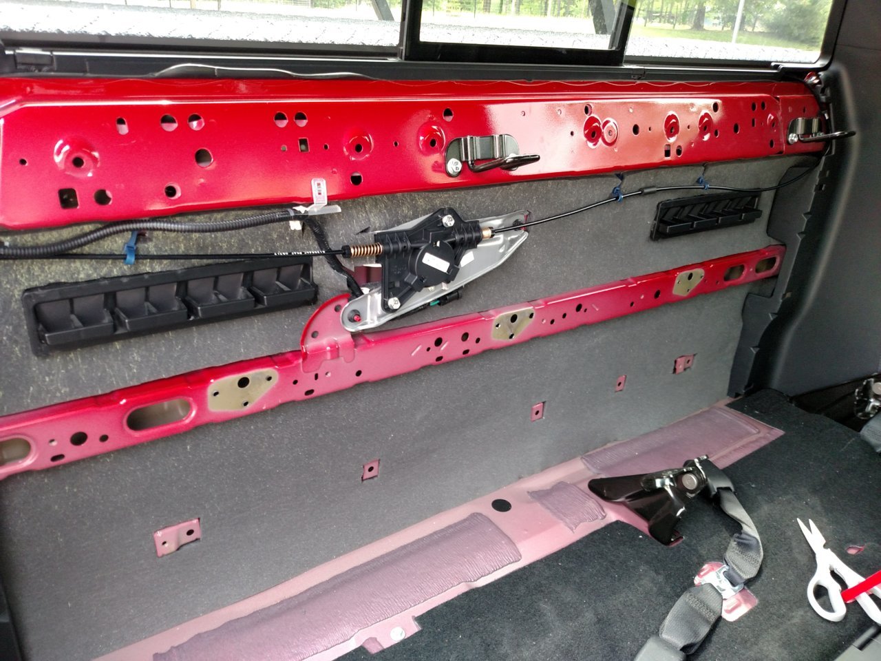

    Completed my Audio build finally! Went with:
    Stock Nav Head Unit (for now)
    Focal Access 6.5" components in doors with tweet's mounted in dash and on top of flat portion of sub box.
    JL Audio 10TW3 d4 subs (x2)
    JL Audio HD600/4 amp on Highs
    JL Audio HD750/1 amp on Subs
    Sub box and all installation built/completed by myself.
    Started by removing the interior.
    Installed the amps under the seats and installed the door/dash/pillar speakers.
    Added sound deadening/insulation pad to rear cab wall.
    Re-installed factory rubber mat on back wall then carpeted the wall and exposed floor where factory cubby's were.
    Built/carpeted and installed sub box then put all the interior back in.
