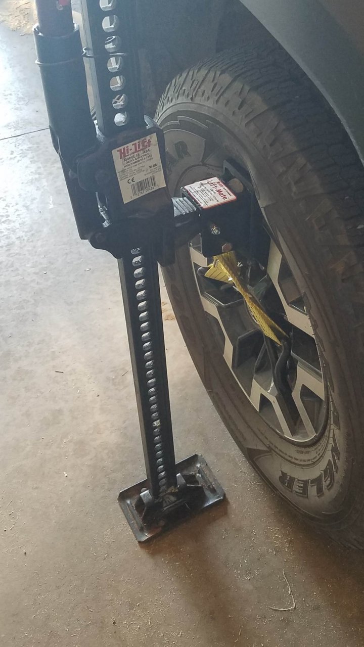

    Side note, got the hi lift mate for hi lift jack. works well on the wheel of ORoad it seems.
    One day would like frame mounted sliders....
    Gotta watch front caliper. Haven't tried rear disc clearance yet.
