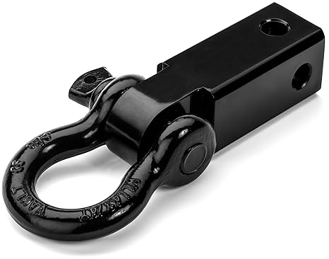

    First taco. 2017 Off road dbl cab short box. I drove Silverados for 17 years previously. used front hooks and rear tow ball with straps with the Silverados when stuck.
    will use the reese hitch shackle for rear tow option. Took a peek under taco and it looks like a small hook and a hole on other side on the front. When stuck here it is typically in snow and will be a violent snatch strap jerk to get out. Is there a thread on options for snatch strap with taco OR? I saw ARB frame mount shackle thread. But is stock able to handle a decent snatch strap front recovery?
    Also, looking for a 30' snatch strap. Most say tow strap online. Suggestions?
    Thanks!

    I would not use the hook up front, unless it's a dire emergency. Get the ARB mounts, or get a Warn Semi-hidden bumper with proper recovery points.
    (Not my truck)
    For the rear, do not ever use the tow ball. They can snap off and becomes a flying projectile. Get a proper rear shackle mount. They can be had for fairly cheap.
    Alesimo, Dctaconny and BillW like this.

    Yeah, never attach a strp to a tow ball as they could shatter. Have never seen one do this personally, but it is best to get a shackle receiver like M603 posted or one like below:
    https://smile.amazon.com/Custom-Spl...-2-spons&keywords=custom+splice+shackle&psc=1
    https://smile.amazon.com/Factor-55-...1535119772&sr=1-10&keywords=factor+55+shackle
    Ooppss.. Sorry, you replied before my post.
    There is a hook in the front, or you could go with an aftermarket front bumper like Phsycle posted.

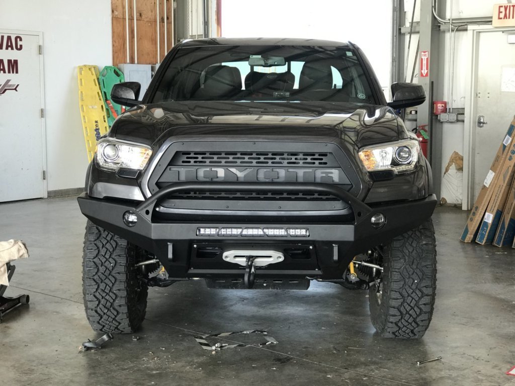

    This tacomaworld forum is awesome. Does that black taco with license plate covered have the Warn semi hidden bumper on it? Looks like a good great option with the bit of radiator protection (deer numbers up...). AND would be way easier for wife to hook strap up if she got stuck.
    Good point about rear ball. Never thought about it becoming a cannon ball years ago. MANY crazy recoveries using it. But will switch to shackle mnt. Came across a logger who had a chain come thru rear window while pulling out a vehicle. Subdural hematoma, eventually died. So ya, the cannon tow ball would be worse!
    Must say it is pretty chicken shit of Toyota to not have robust recovery points on a $36-38K OFF ROAD truck. Love the truck tho.
    Thanks everyone

    Yeah, few years ago, I saw a video (that was quickly taken down) in a foreign country where they were doing a recovery using the hitch ball. Snapped clean off and ended up killing some kid standing near by. Very sad. Recovery is a dangerous game.
    I do miss the stout front recovery points I had with the F150. But there are plenty of options for the Tacoma. Yes, that's a Warn bumper. It's obviously got a winch mount as well.

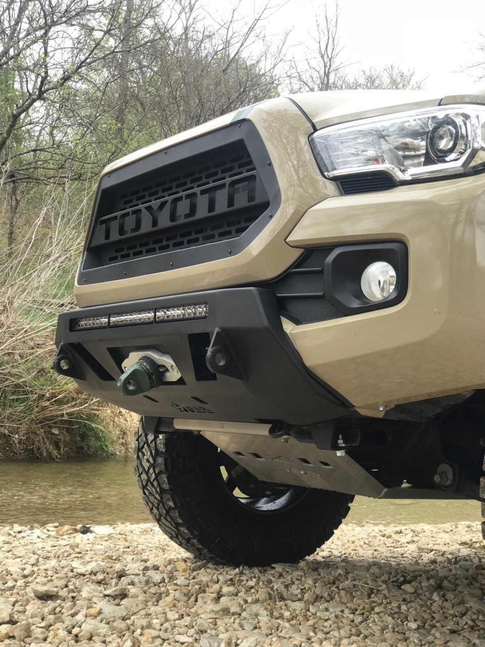

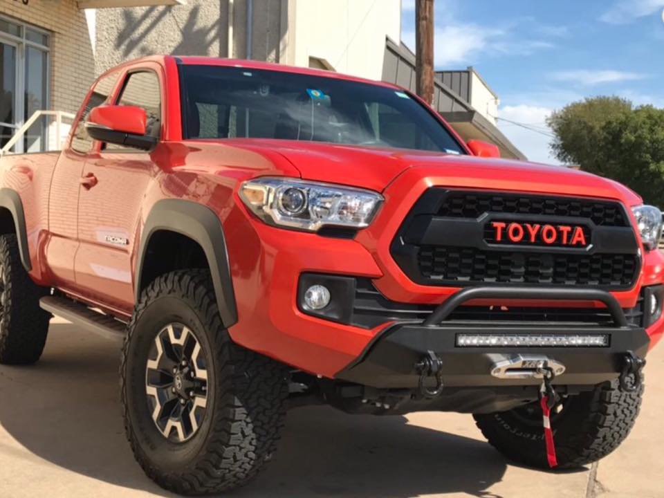

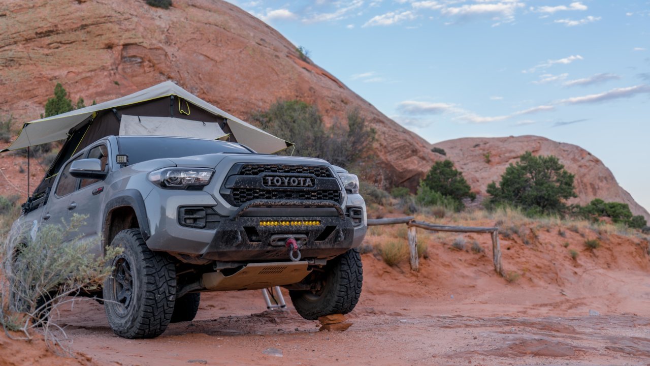

    There's also other clean designs, depending on what you want to spend. You can get them without winches if you like too.
    20799781_10209730999774768_1206827730696972796_n.jpg Cement-Tacoma-C4-Fabrication-Lo-Pro-Winch-Bumper-3.jpg IMG_0765.jpg IMG_0780.jpg and there's always a whole bumper. Haha

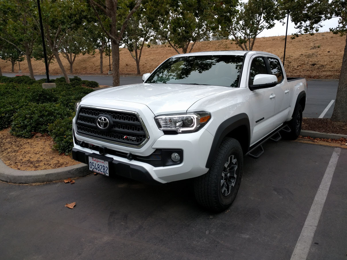

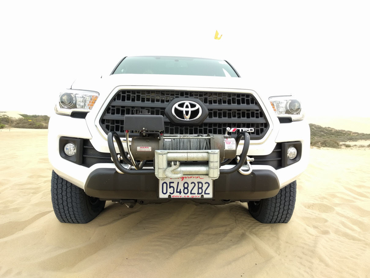

    Second for the Mobtown recovery bar. I use mine with an 8000lb Warn winch on the front and if necessary I can pull the winch off the front and mount it on the rear.
    On the back I use a Smittybuilt Beaver Step and a kinetic recovery rope.
