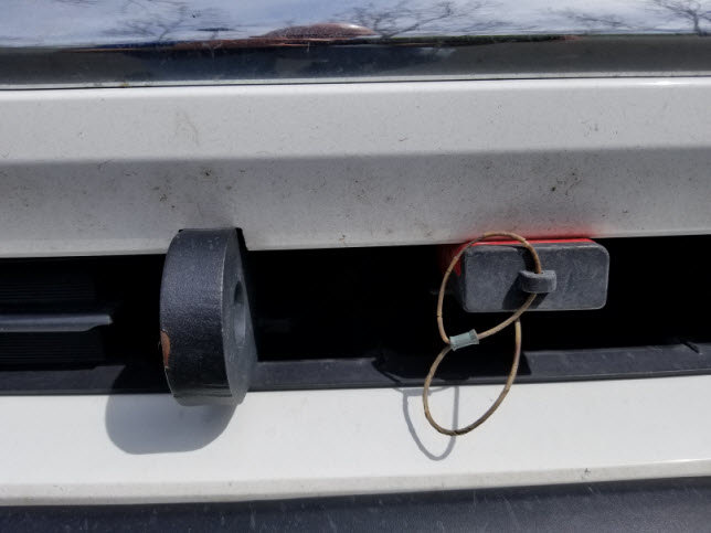

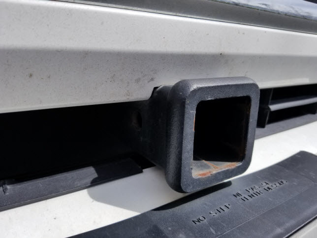

    wow. now that is definitely a plus for the mob town. did it mount easily? do you have tow package with trans and oil cooler radiators?

    Does it have a tow/recovery rating?

    It did. You pull the bumper, pull the aluminum spacers between the frame and bumper, bolt the recovery bar to the frame, and mount the bumper to the recovery bar. The recovery bar takes the place of the spacers. You may need to do a bit of dremel work to get the grill bezel to fit.
    Yes, I have the tow package with coolers.

    It’s rated up to a 10,000 lb winch and has a tongue weight max of 500 lbs. it’ll handle the same as a plate bumper would.

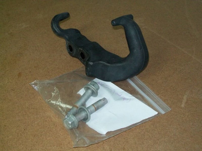

    So on my ORoad there is a passenger side large hook and small hook. Driver side has a loop, is this the delivery/transport point (not to be used for anything like towing etc.)?

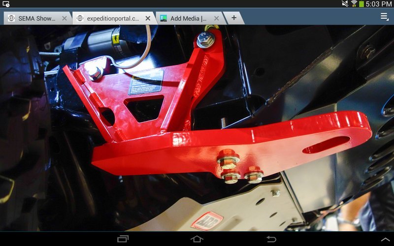

    Looks like my Offroad hook attaches with 2 bolts? The arb looks to use those 2, another next to it, and 2 more up on the actual frame?

    I have seen that hook bend straight when being used as a recovery point. You need to get something that you can use with a d-ring shackle.

    pics of both

    loop on drivers side is not to be used for anything right?

    I never used it, not sure I would trust it.

    Looks like the arb might be for me. Is the ARB the go to recovery hook? I see others for less $.
