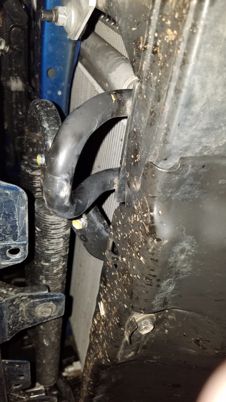

    The passenger side hook is a tow hook not a recovery hook. Its not meant to be yanked on hard but pulled on gently and consistently. The loop on the driver side is ONLY meant as a tie down point and nothing else. It will rip off pretty easily. With that said I have used a tie down loop and towed a car using it, it was our only option and he needed a very very light pull and I still dont recommend ever using it in that method. Even a light tug could rip it off.

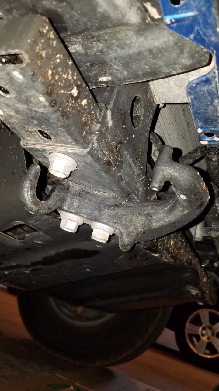

    thanks. So one should get an aftermarket hook replacement if yanking outta snowbanks etc? This is a weak sauce move by Yota putting one weak point on the front. And it seems to be just two bolts on the crossmember and not the frame (the hook)?

    That hook looks good enough for some extraction work.

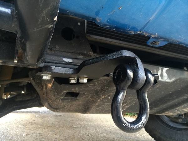

    False. I've seen that hook bend straight. The safest recovery is a closed system I.e. d-rings
    This is what I used before my front bumper was installed
    eddyizm and Governor like this.

    interesting. i thought it looked good initially also. but several say they have seen them fail. Does the one in the pic attach with 2 oem holes and a third, all on the cross member?

    What is that setup on the quicksand? Brand? I'm looking for a low profile and not-too-heavy solution, and this looks like IT.

    From the logo its a c4 Fab Low pro.

    What tow hook is that?
