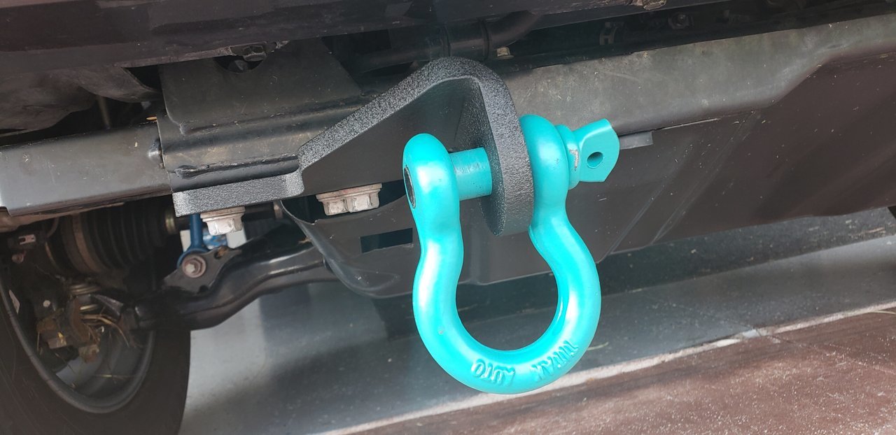

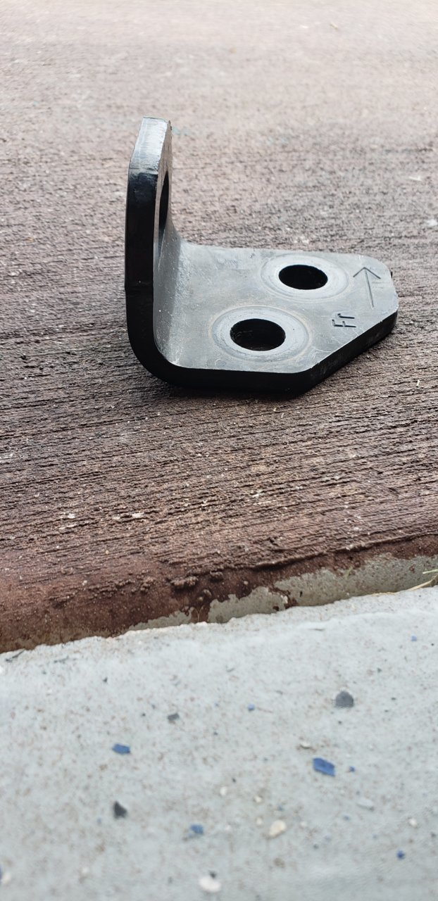

    Nothing wrong with BP fabrication and not as expensive as ARB. Took the stock flimsy one out.

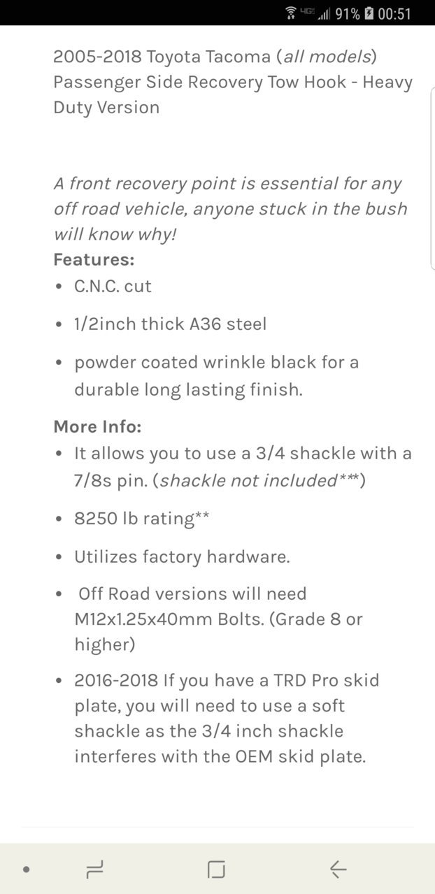

    Will that one work with the TRD Pro skid plate?

    I’d look at the ARB one. Or Mobtown has a recovery bar that is frame mounted I believe. The one shown above seems rated for the weight, but my personal preference would be to have some lateral bolt points as well. Not saying it won’t work at all - recovery is just one area I like to overdo things a little.

    Thanks. I'll be going to 4wheel parts tomorrow. They can order it. I'm hoping it works with the TRD skid plate.

    The bpf hook mounts to the frame in existing holes. It’s a very solid unit.

    Yes, it is very solid.
