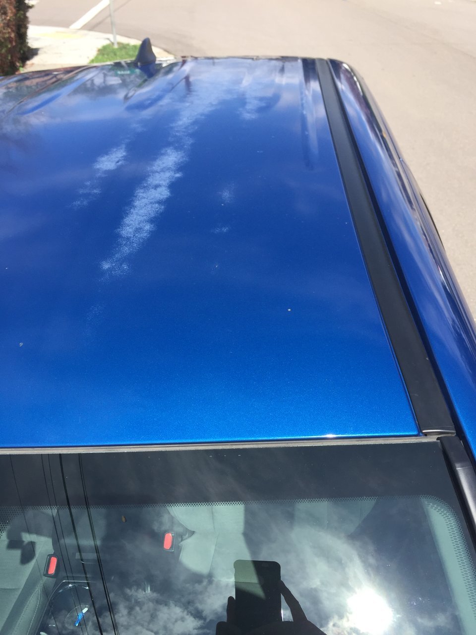

    IMG_0990.jpg Has anyone else had a problem with their paint. I have a 17 dcsb in Blazing Blue Pearl and the clearcoat on the roof is already fogging white. This truck isn't even a year old and only has 9k on it.

  2. Feb 26, 2018 at 4:28 PM
    tuanhuy0301
    tuanhuy0301 Well-Known Member
    Oct 3, 2017
    #231913
    154

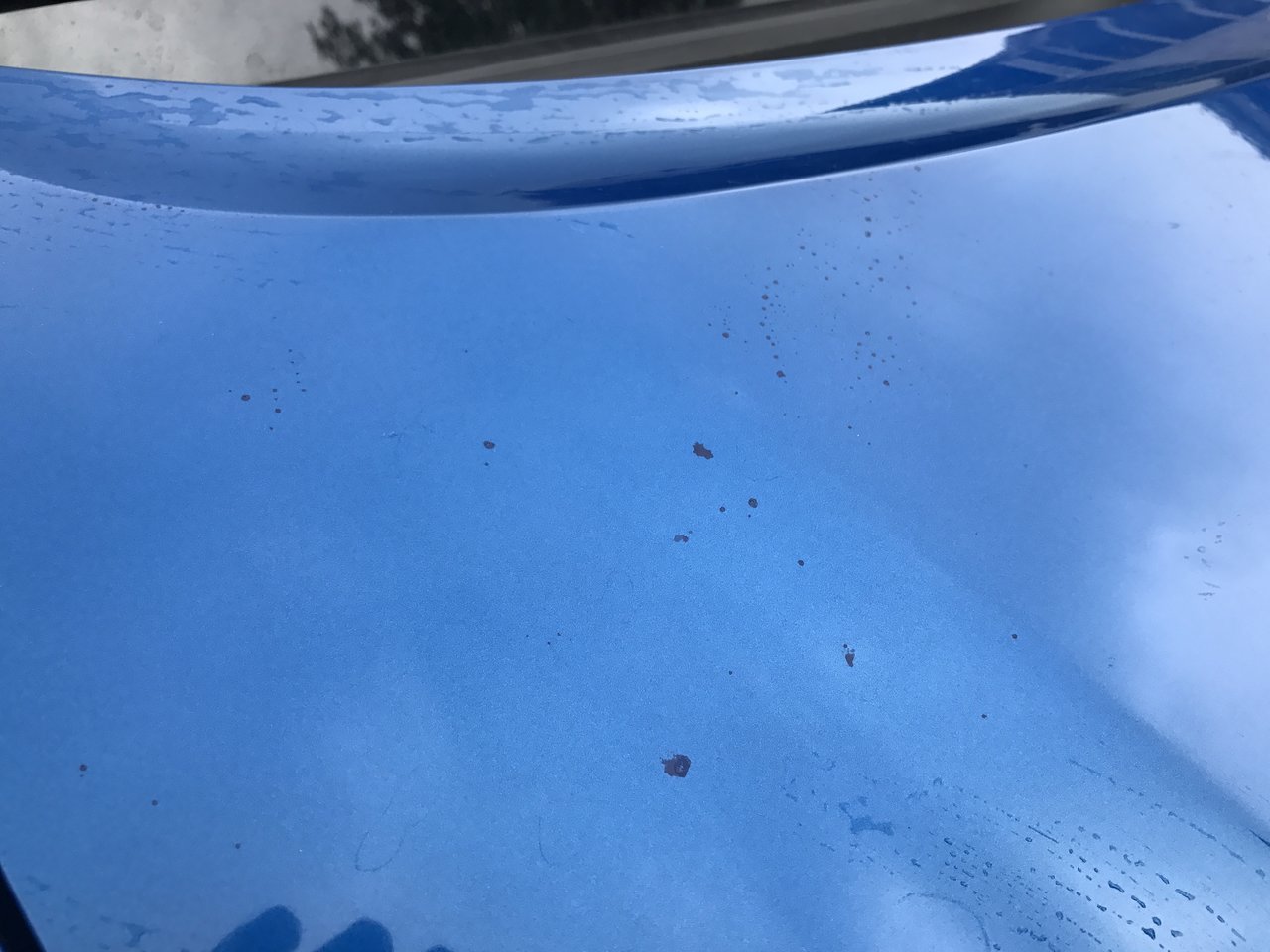

    Haveing problems with my 2017 blazing blue paint is changeing color under clear coat now. At first they said it is rail fall out and would clay bar it did not fix now getting more spots and got to fight local stealership

    This is the pic of the stuff under the clear coat
