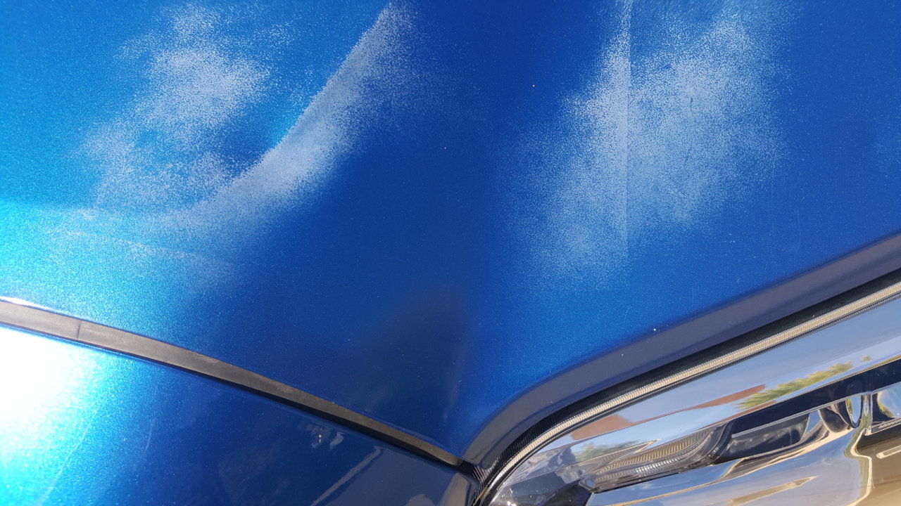

    2017 DCSB Taco 2wd
    A ceramic coating is great protection from contaminants but can’t change the chemical composition of the clear coat. These “clouds” that are appearing on many of our trucks are not on the surface so it doesn’t matter what products are used, this is why Toyota is repainting them under warranty.

    After dropping my truck off at the dealer. They called back and said they will be sanding and painting my entire truck. Dropped off at dealer on Sept 28th.

    Damn @Johnnymoe, all I got was the hood, roof and tops of the fenders! Hope it's worth the wait to get the whole truck painted.

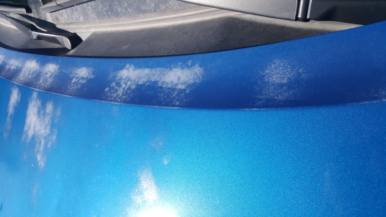

    I honestly think they should respray the whole truck. It fades on the roof and hood first because it's in sunlight the most, but soon the sides will fade too and who knows, it might be outta warranty when that starts.

    I've got the same issue, but worse. 19k miles on mine.

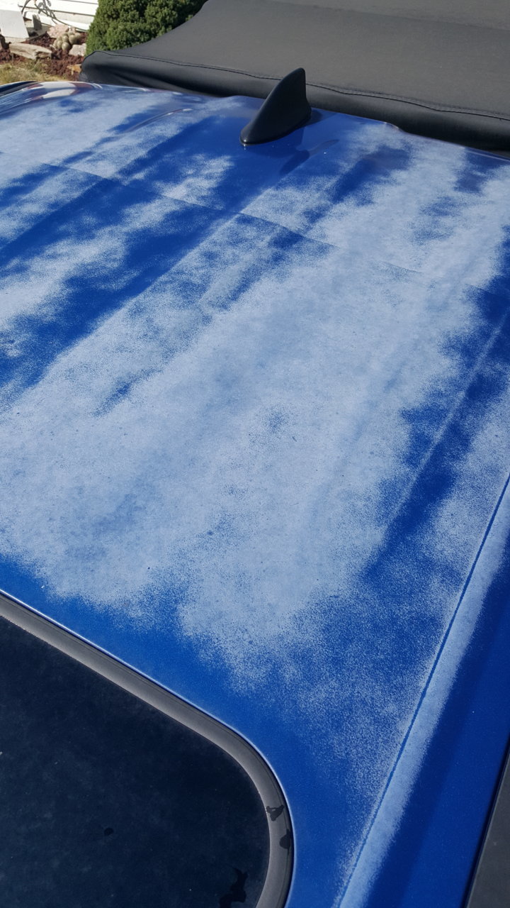

    wow that looks like a clear coat issue

    Dealer said they saw the same use for the first time about a week ago. Toyota rep checked that one out and they will re paint. Hoping they will do the same for me.

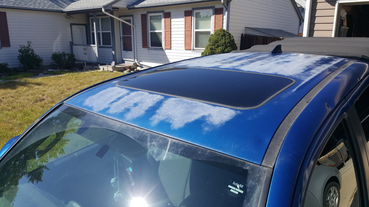

    My 17 taco has confirmed bad paint at 22k. Warranty for paint is 36k. The clear coat which protects the acrylic blazing blue was too thin. In process of having Toyota repaint at local shop.

    Wow, that looks like a 30 year old Chevy.
