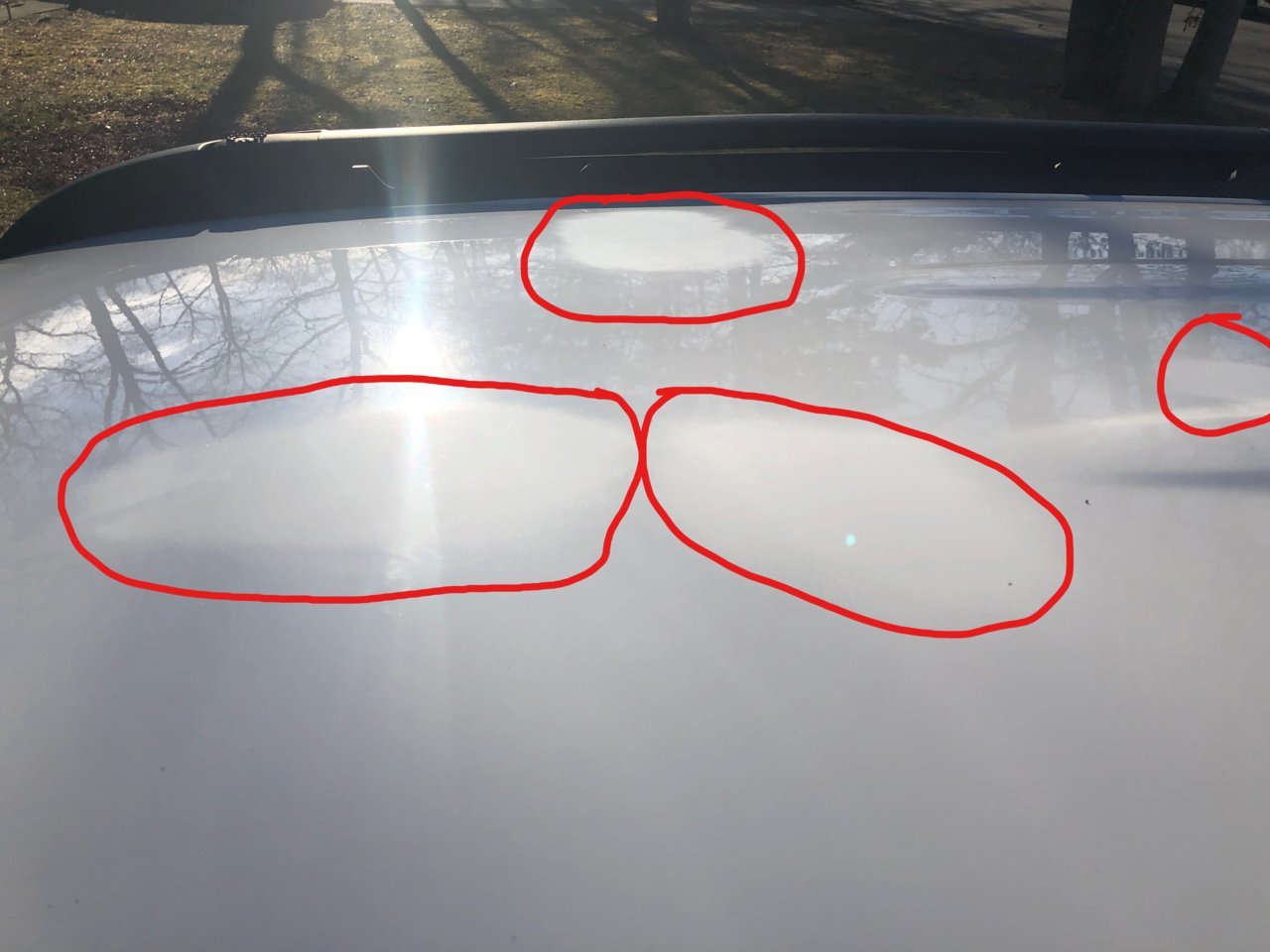

    firewood scratches, Labrador hair/slobber, American flag sticker, Total Chaos bed stiffener, Scepter H20 can, onboard air
    those are clouds

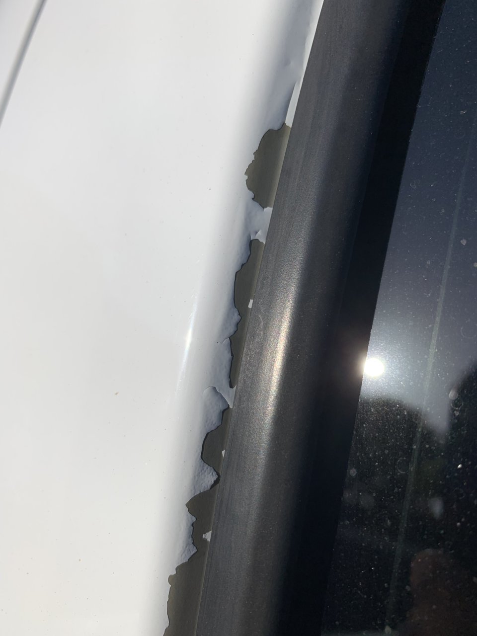

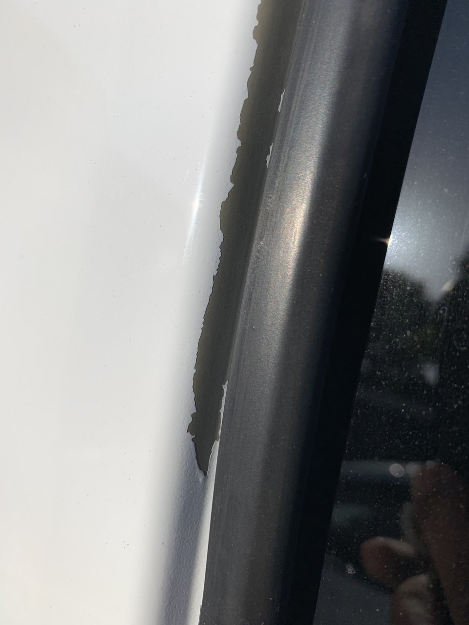

    Took it to the dealer and all he did was take pictures and said he has to send them to Toyota. He said all the would probably paint is just the part that’s peeling. Still haven’t heard back.

    They will paint the door only. Once they do make sure color matches to the truck. If you notice slight color difference ask to repaint whole side. I have seen many cars with fender or door not matching or aging same as rest of the vehicle. My 2017 OR paint became chalky on roof and hood. Toyota rep had to look and measure pain before approving repaint. Now I am waiting for dealer to arrange date when to repaint it.

    Took it to Mossy Toyota in San Diego. They sent pictures to Toyota USA. Toyota USA stated that this is not a warrantable defect. But they said they would “Do Me A Favor” and touch up the paint that is peeling. The other side is in the first stage of the same issue but they said that they will not paint it because it is not Flaking as bad as this side. They said they would do a “Goodwill” and paint the flaking side. WTF “Doing Me a Favor” it’s not my fault the paint is flaking. I am highly disappointed in how they are handling this issue. Not a “Warrantable Defect” what is it then. Anyone know how I should handle this please let me know if I can escalate this issue.

    Is your vehicle still under warranty? If so, then this sure looks like a defect in workmanship. My first piece of advice would be to go to a Toyota approved body shop (collision center) if you're dealership doesn't do body work and get them to assess the issue and what caused it. If they tell you that it's due to a defect in either the paint, the clear coat or the application of either then it's on Toyota. Open and shut to fix it completely and correctly. If it turns out that it's flaking because of something that you did or someone else did then I'm afraid it might be on your dime and your next call would be to your insurance company I'm afraid. You might want to contact your insurance company first and get their opinion. Let them chase down Toyota. Just spit balling here. I'm dealing with a paint issue myself right now and not getting great results from Toyota either. Waiting on test results to come back from my Body Shop's lab on what they find in the paint, clear coat or both. Good luck bud!

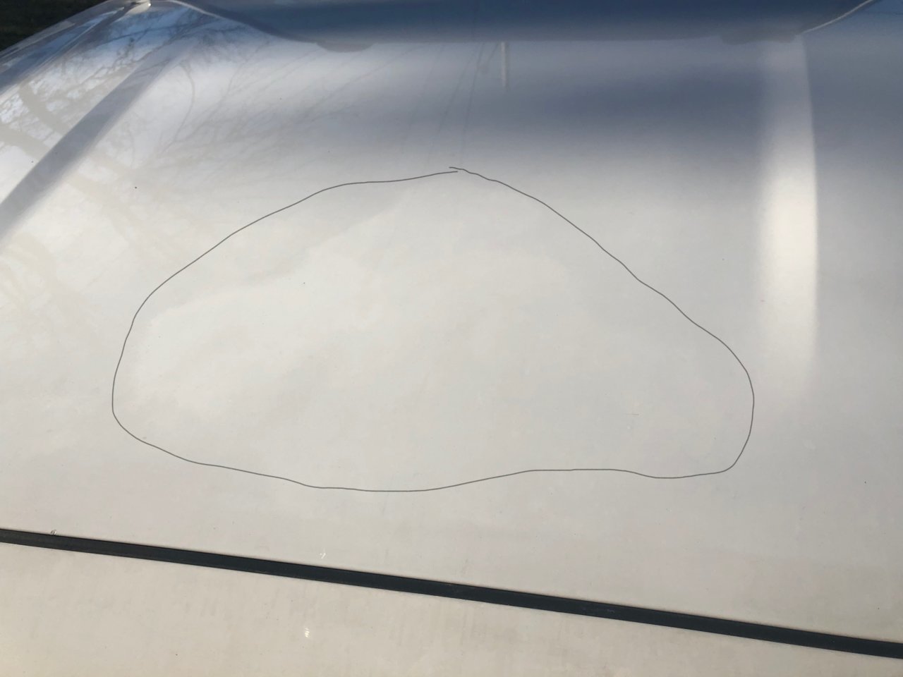

    my 2010 now has the same problem on the roof (so far). What did you do about your problem? thanks

    Hey Oshnjoe, I'm right in the thick of it now with Toyota. They've created a Case number for my issue and they've contacted me a couple of times for additional information so I'm now officially on their radar. So far they're not budging on only agreeing to fix the affected areas. I've brought my truck to a Toyota Approved Body shop for an estimate and he took a sample off of the roof and sent it out to the Valspar Paint lab. Should have the results back in another week and then he'll be able to finish his assessment. Also just noticed this past weekend that the areas on the hood are spreading quite rapidly. Still not seeing anything on the Doors or fenders yet but I'm pretty certain that it's only a matter of time. I only know of one person in here that was able to get Toyota to repaint their entire vehicle for this same problem and I'm hoping that they'll look at his case and do the same for me but who knows. You're the first person that I've heard of with this issue on one that's not a 2017. So far the pattern has been 2017 Tacoma's in BBP color exclusively. Are we talking about the same paint issue? White cloud-like blotches appearing on the hood and roof?

    Yes, absolutely the same problem but so far limited to the roof. The color matched A.R.E. cap I've had on the truck since nearly day one is perfect (paint wise) so I don't get it that the truck's roof paint is failing. I will likely be calling the Toyota Customer Experience line shortly. Will likely get blown off, but have to try anyway. Good luck with your case.

    On the OP's paint issue it appears the clear coat has degraded prematurely due to UV or maybe contimanents or pollution. It clearly is failing prematurely. Curious as to what the lab finds.

    TRD Pro Grill, TRD Pro Exhaust, TRD Pro Intake, TRD Pro 4 Runner 17" Sema Wheels. Morimoto Led Headlights, Morimoto XB Leds.
