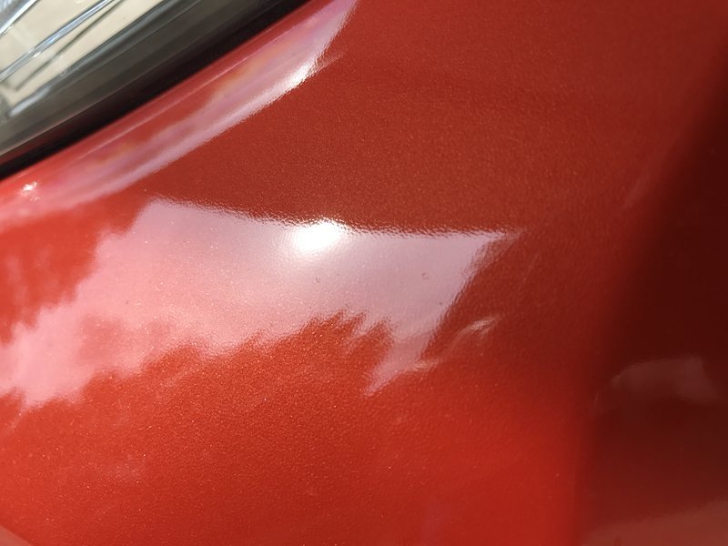

    Not my truck as mines pretty dirty with salt and sand here in Ontario but similar to this and it does not bother me it is a truck and I plan on using it as one and off roading so not a concern. Also only noticeable from close up

    that is actually quite normal for new vehicles. they are sprayed by a robot and once they dry that is what we are left with. you should see some other manufacturers paint jobs. Dodge in particular. my boss has a $72,000 Ram 2500 Longhorn and his is WAY worse than yours. only way to fix that is wet sand and buff it.

    That pic appears to be of the front bumper cover, right under the headlight. The bumper cover is textured plastic, which is visible under the paint. Many vehicles have that. Now if your metal fenders or hood have that, then yeah, that's bad.

    Probably a transportation claim or lot damage repair

    He's mistaken the last of the single stage paint jobs went with the 80s . Theyre all base clear (2 stage) or base /mid /clear (3stage) color now . then there is e coat and sealer below that in most cases.
