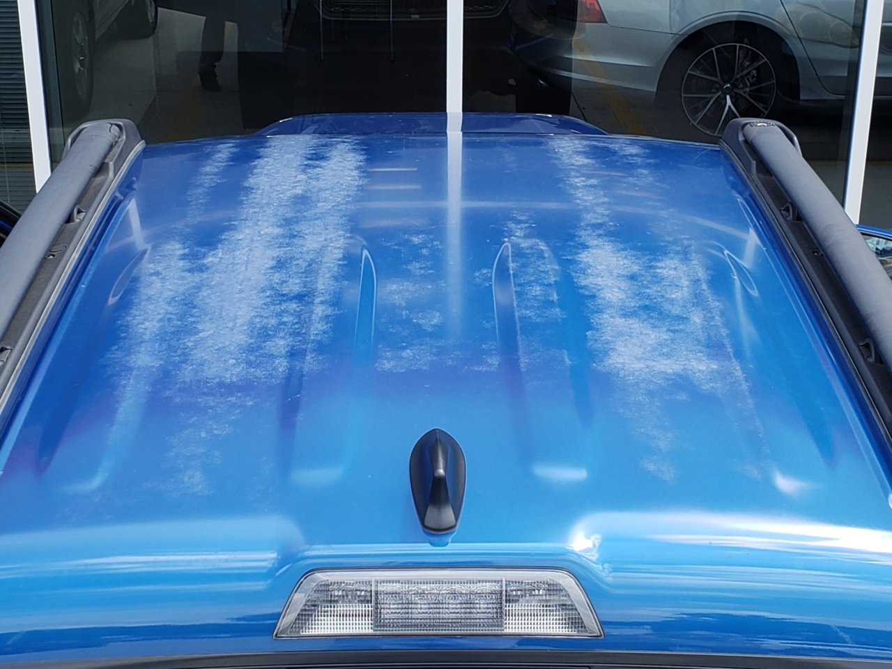

    Apparently the clear coat on my roof is toast on my 2017 BBP DCSB OR. Took these photos at the dealership today...the tech said he has to send photos to Toyota to see if it's covered under warranty.

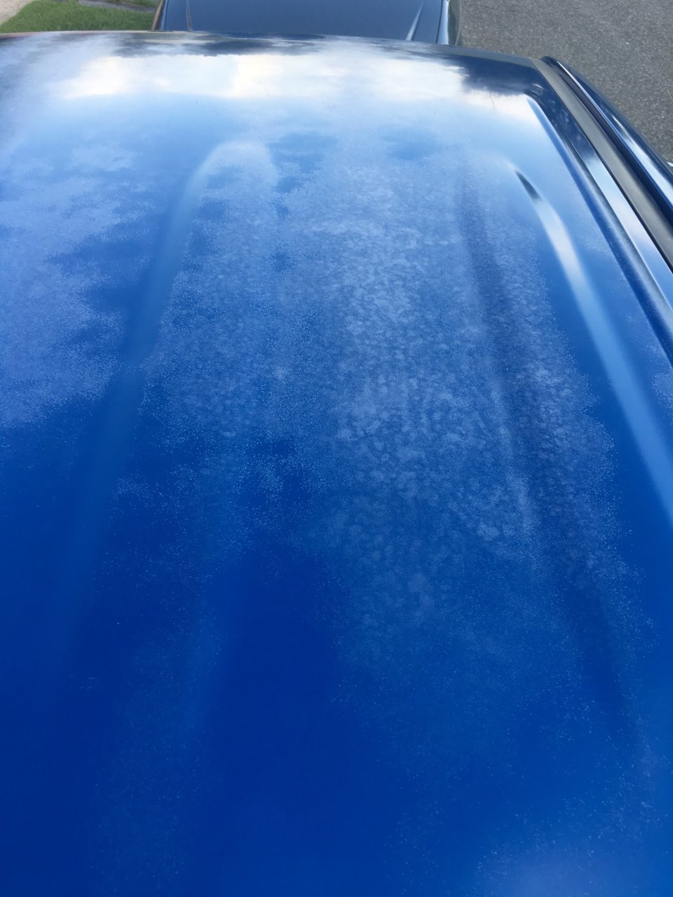

  14. Sep 3, 2018 at 1:09 PM
    #154
    Johnnymoe
    Johnnymoe Member
    Sep 3, 2018
    #265046
    5
    Maryland
    2017 blue DCSB Tacoma 4x4 SR5
    Did the dealer fix this. I also have a 17 blue tacoma and my roof is like yours and I can see the hood is starting to do it. I attached s pic of my roof below

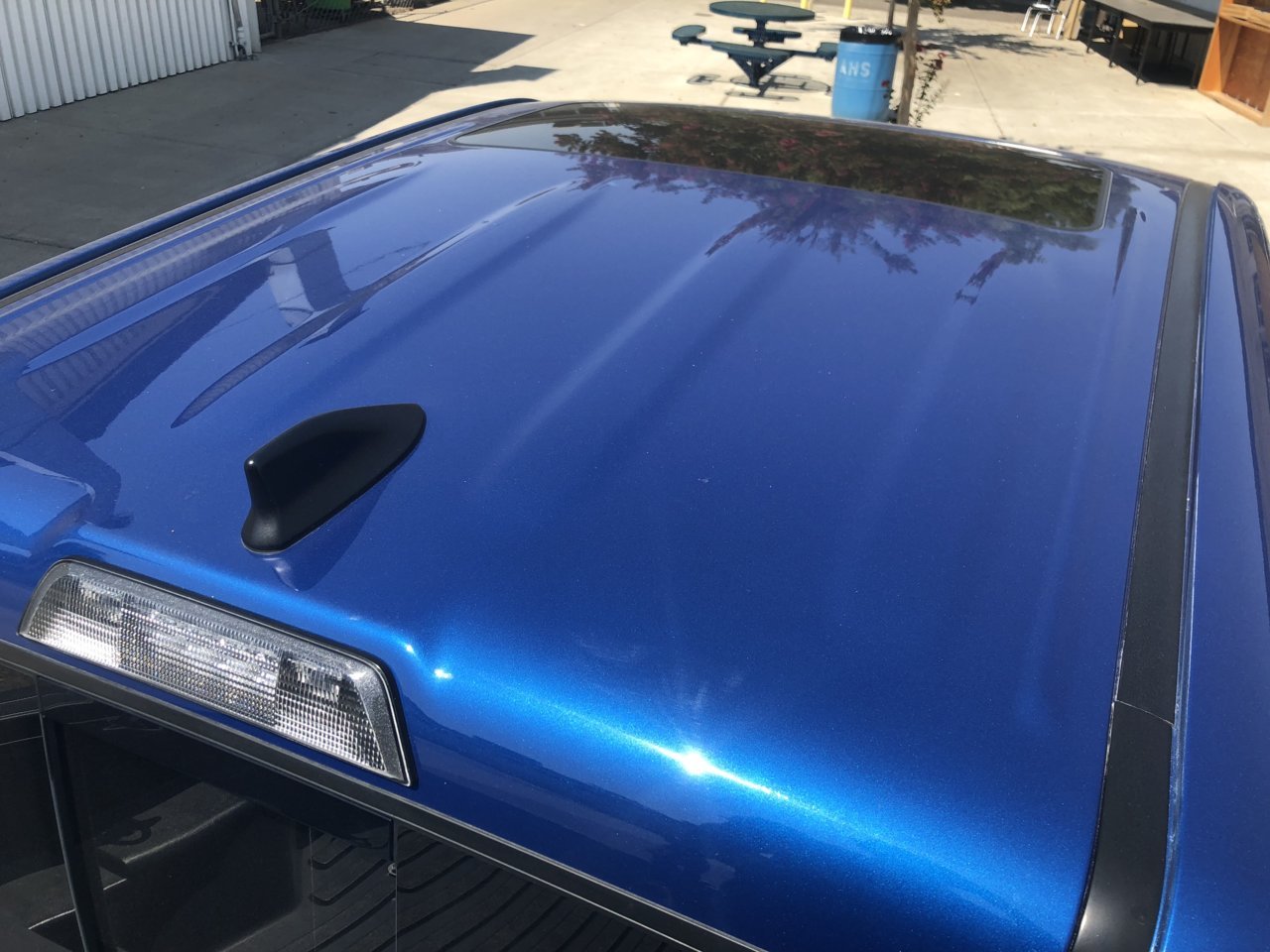

    I got mine all fixed under warranty. It looks as good as new, but still worried it may begin to fade somewhere else. Everyone should be covered. Do not let them tell you otherwise. IMG_1953.jpg

    The dealer called and said they'd cover it under warranty. They are sending it to a body shop for paint this week. My concern is that I get the roof fixed and then my hood goes after I roll past 36k miles. Guess we'll see...

    Exactly my concern. I took it in two weeks ago, and I noticed when I dropped it off that the section above the doors was also beginning to fade. They agreed to fix that too, but they said if I had any other problems I would have to get approved again. I am seriously considering getting rid of my 17 tacoma because of this issue. We'll see what happens.
