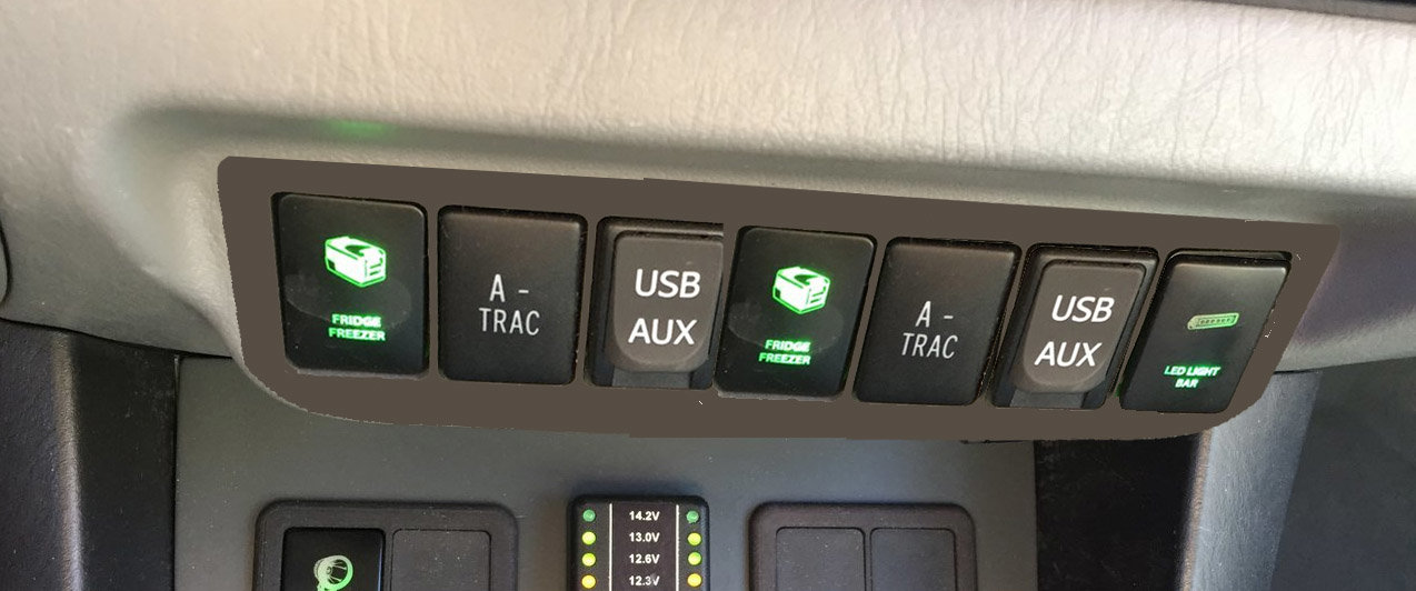

    to replace/extend/overlay the existing switch location-
    here is a 'mockup' image

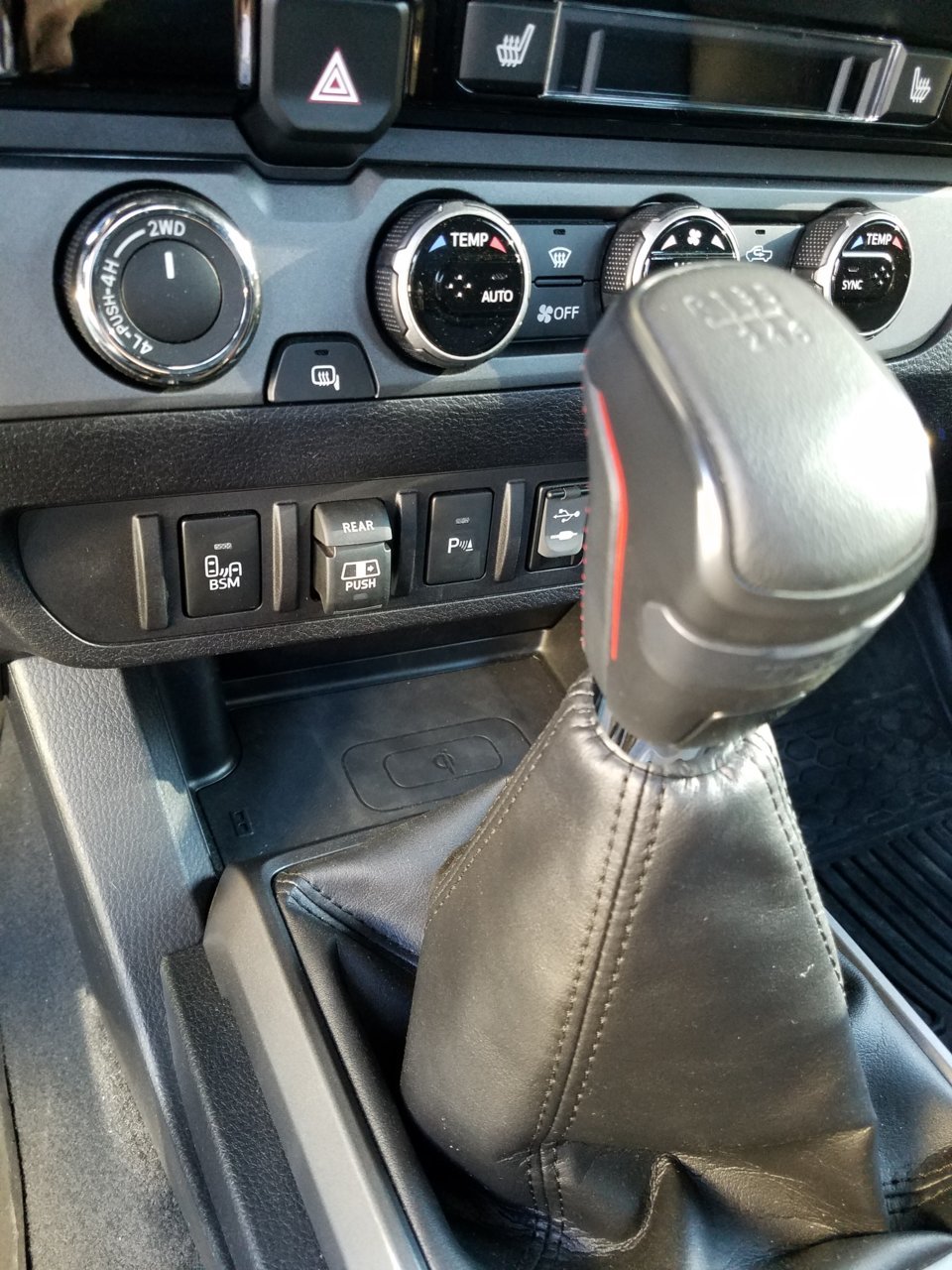

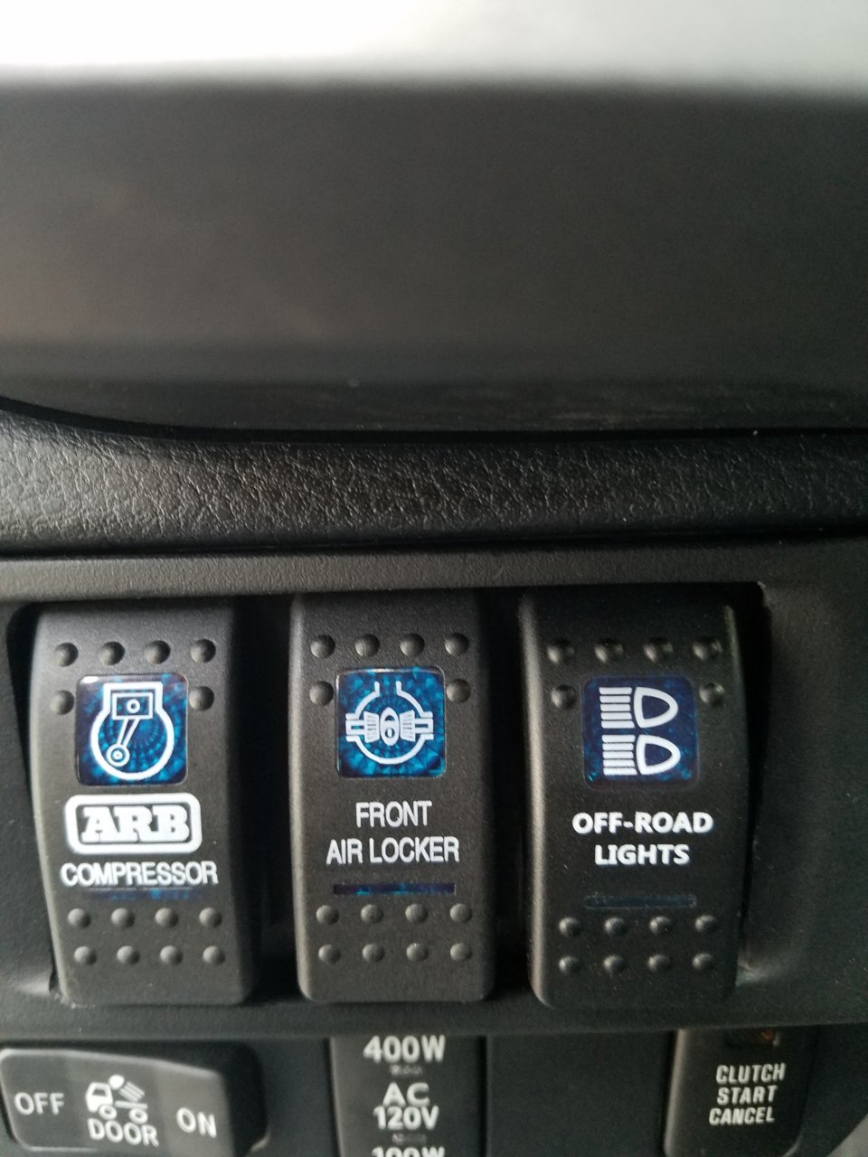

    No you don't! The factory center switch panel will accommodate the rear window switch. I found this out when I messed up the cutout for the rocker switches I was installing in the cubby above the rear window switch. I ordered a new one but the one I received did not have a place for the rear window switch. Turns out Toyota has discontinued this part. So I went ahead and ordered the 2018 center switch panel so I could install the rear window switch in this location like the 2018 Tacoma's (I have a 2017 Pro). Well when I removed the original center switch panel I went ahead and tried to see what would happen if I slid the rear window switch in the one open blank spot on this panel. Guess what, it snaps right in and works perfect!
    For anybody else wanting to move the switch to this location, Lowe's sells a 18 gauge 5 conductor wire by the foot for $.54/FT . I purchased five feet and maybe used a total of four feet for the install. Couldn't be happier with the location of the switch either. Easier to reach and my wife can open it now from the passenger seat.
    SO NO NEED TO SPEND OVER $100 ON A NEW CENTER SWITCH PANEL!

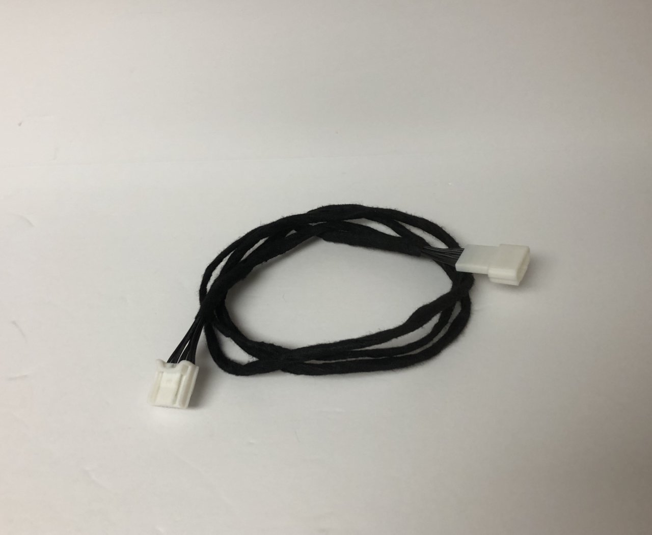

    • We could gladly make an extension harness if you guys would be interested so you don't have to cut/splice anything. Not sure what it would be worth price wise but I'm sure we could make it happen just need a length estimate.

    That would have been nice to have as it would have saved me a little time and made things a little "cleaner." I would have paid $20 or maybe even $25 for a plug and play extension harness.

    Thanks for the input! It would likely come out slightly higher than that but were in the right neighborhood. I’ll test it for length tomorrow and go from there
