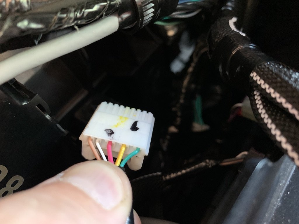

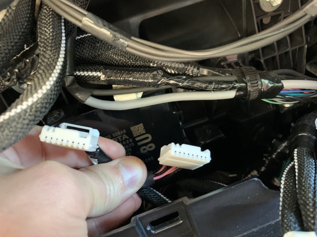

    Confirmed, fitment is the same. OEM has 5 pins connected, whereas 12voltsolutions has all 8 wires in place.:confused:
    Left is OEM, right is 12VoltSolutions extension harness head
    OEM has these 5 pins wired up. 12VoltSolutions has all 8 pins wired.

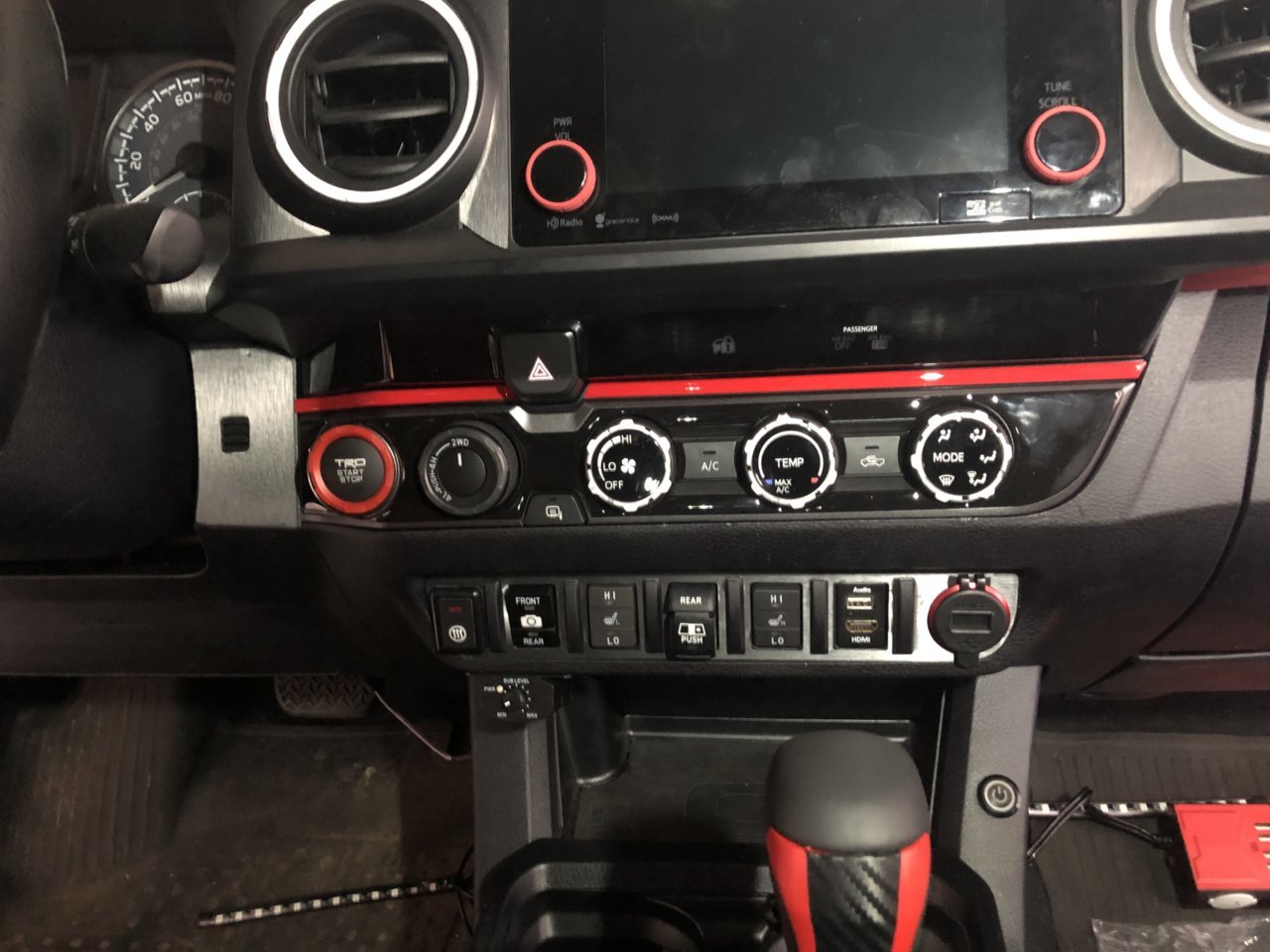

    It's been driving me crazy that the rear window button, which gets used every time I enter or exit the vehicle, is in the most inaccessible location behind the shifter, while the BSM & wireless charger button, which will literally never be pressed, are in the most accessible slots.
    Today I decided to swap them around.
    Took a little longer than expected, since Toyota put grooves in the switch to prevent them from being moved (I don't understand what they have against this), so those had to be shaved off, but it was otherwise pretty straightforward.
    I was concerned that it wouldn't work without the little bevel they put into the factory slot, but there's still plenty of room for the button to be depressed.
    The wire is a little tighter than I would like, so I'll probably grab an extension harness if i can find one! I don't really want to splice wires while it's still under warranty.
    While I had my hands in there, I also took the opportunity to unplug the light in the wireless charger cubby (aka the really expensive pen & spare change holder).
    I was going to move the USB port over towards the cigarette lighter, but apparently they used a different sized slot for that.
