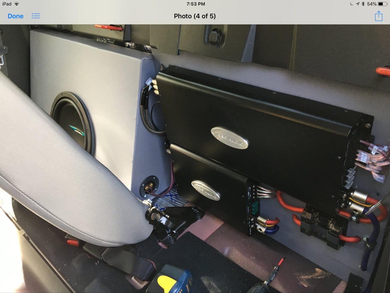

    This is what I did in my '17. Image Dynamics IDQ-10 in a 1cu ft sealed box stuffed with polyfill. I recommend it.

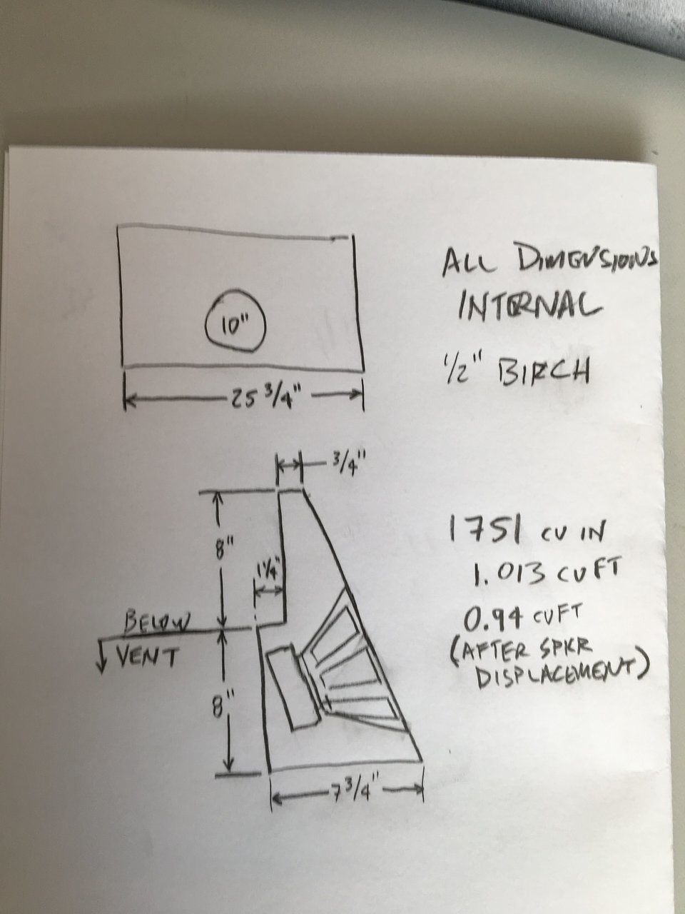

    I made the box. 1/2" birch plywood. Wanted 3/4" but to get the internal air space couldn't do it. Wrapped in vinyl.
    Here are the dimensions I used:

    I used 6mm (1/4 inch) plywood in mine, but then I also layed down a layer of fiberglass inside along with some 1/2 square sticks for extra support.

    Yeah I had to do some bracing inside. The fiberglass is a great solution. Might take mine out and lay some fiberglass all around the interior. Great idea!
