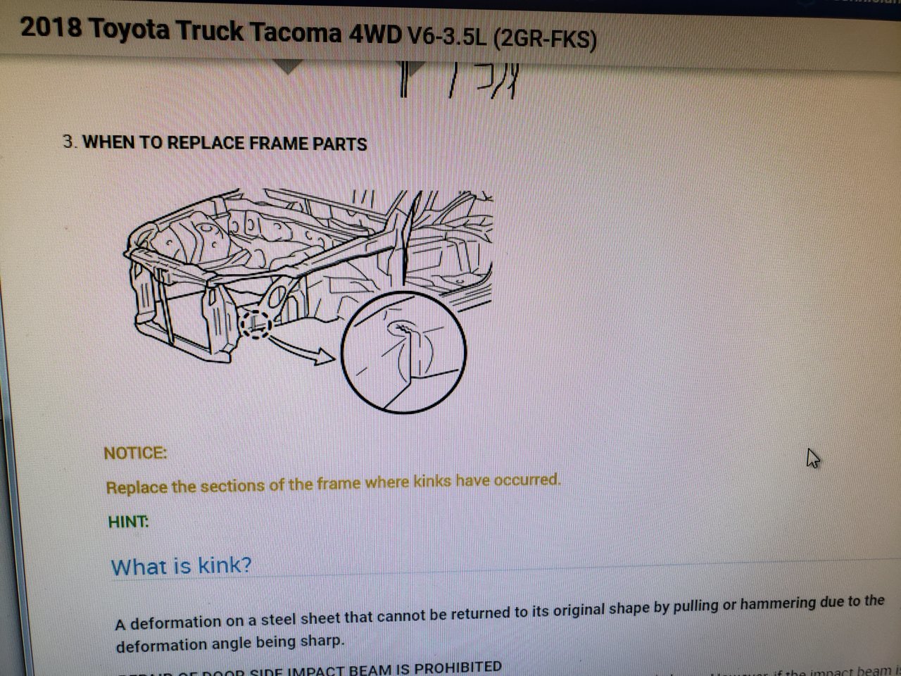

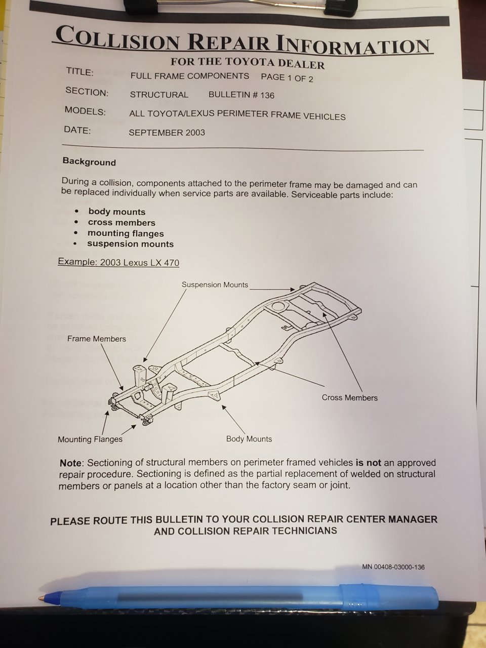

    Toyota does NOT allow their frames to be straightened with any heat. Has to be a cold repair. Also if the frame is buckled, they require the frame to be replaced.
