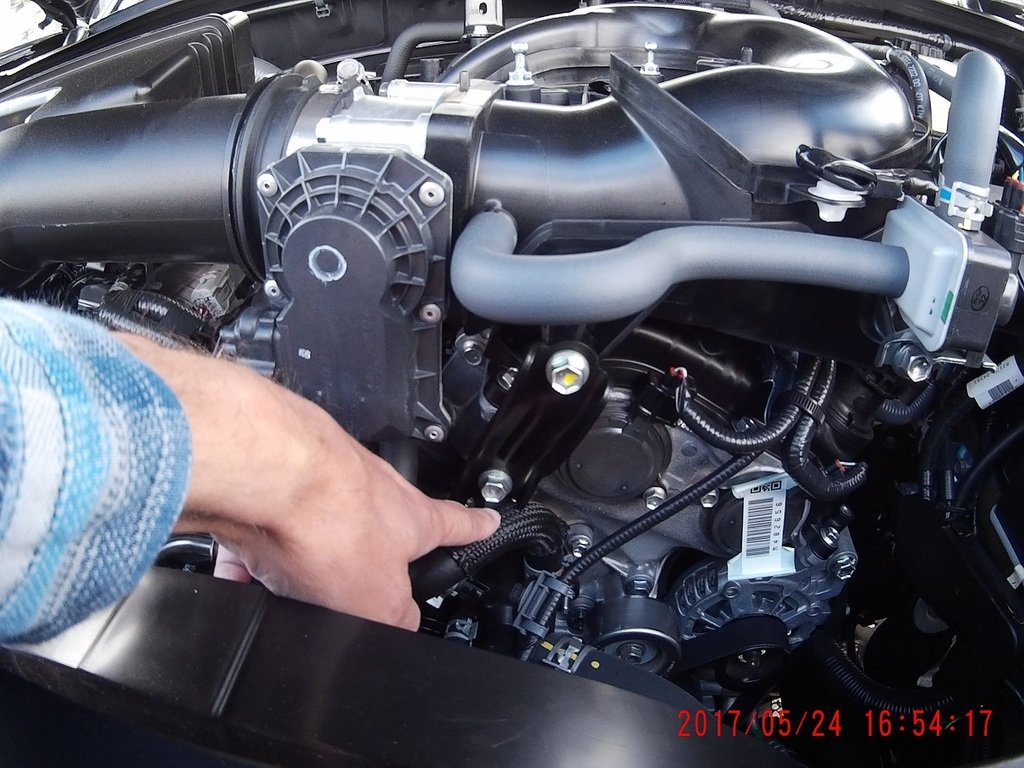

    Is this the spot where a TW member mentioned potential issues? He made some modifications to a bracket or something to give more clearance... I still haven't looked at my truck in that spot to check the clearance, thanks for the reminder

    OPs leak is not the same thing but since you brought it up, l did check that bracket on my truck and ended up having to take it off and grind it down.

    Shakerhood what bracket you talking about can u post up pictures.

    It is right on the front of the engine with a small hose under it, Toyota is obviously aware of it being close tolerance as they put some abrasion sleeve over the hose but the clearance on mine was only the width of a piece of paper. When it stops raining l can try and snap a pic but it is also on here somewhere in another thread if you need to see right away.

    Here is the Bracket that rubs on that Hose, I ended up grinding a bit off of mine as I could only slide a piece of paper in there.

    I pulled it away with a zip tie,the easy way!

    No, he said his leak was at the back of the engine under the Intake, I was just showing the front where a future leak could happen.
