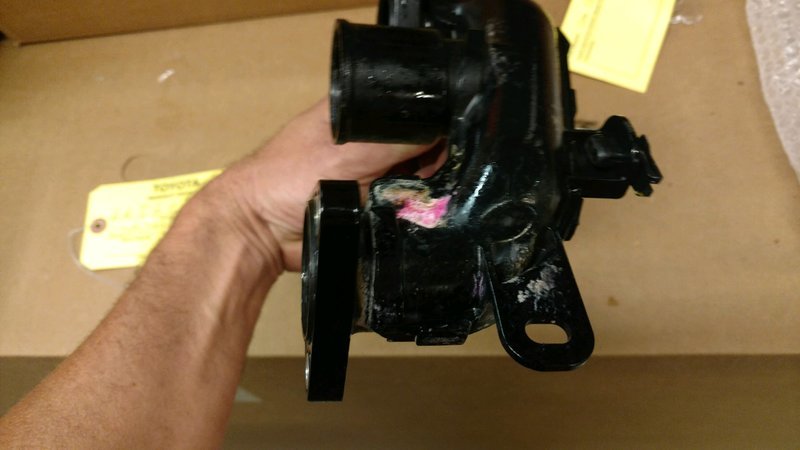

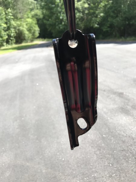

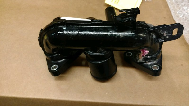

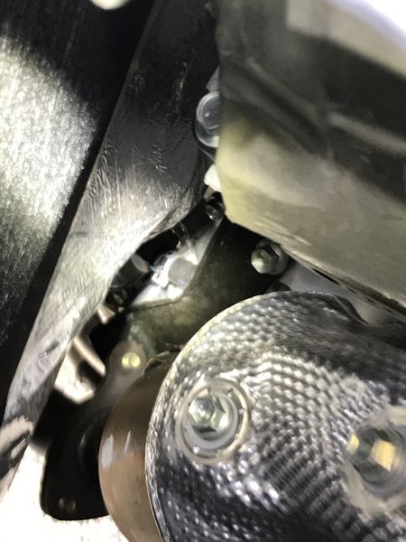

    So here is the where the coolant pink in color residue could be seen but was not dripping and this is why you could smell it sometimes dripping down bracket that connect to exhaust flange you can't see the residue anymore cause they cleaned it off it was just to the right of the bolt you can see in the light!!IMG_2028.jpg
    This is the part
    I was also told that this was a factory defect is what they said they were calling it!!
    yesmar, tonered, busticator and 4 others like this.

    no biggie, the part was replaced free of charge now its all good:thumbsup:

    These multi-headed plastic manifolds tend to get brittle and crack after a few years in other vehicle models (like the Nissan Frontier). In time this will probably become a $300 dealer-only part on 2-week backorder. :devil: Surprised yours failed so early. Yeah must have been a mfg defect.

    Finally remembered to check mine this morning. There is no clearance for me, the hose touches the bracket. At 19 months and 12,300 miles mine still looks brand new, so I'm not gonna grind anything down. I'll take a peek at it every once in a while during oil changes. Thanks for the pic of the location. :thumbsup:
