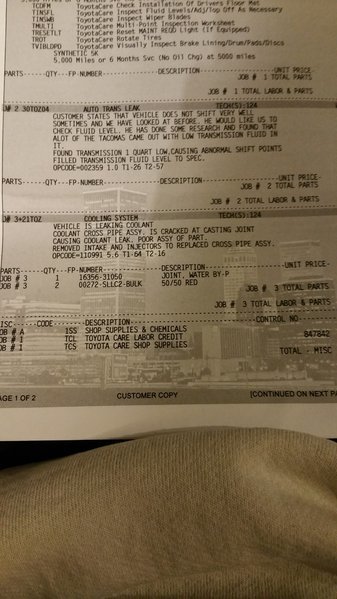

    The leak the OP had was at the back under the intake, the thread also shifted to a possible future leak caused by that bracket contacting that hose up front.

    Thanks shakerhood, I went out to look at mine and didn't see any coolant components that may require that many labor hr. But the intake manifold leak definitely would be a bad scene.
    The front bracket is a bit too close for my comfort too, mine should be ok for now, but I'll keep an eye on them as well as the oil cooling lines underneath the skid plate.

    Bad plastic "welds" from the supplier. I had the same issue at my 20k service.

    Just dropped off my 2017 with 5K miles at the dealer today. It looks like I'm experiencing the same problem as you ( rear bypass tube). Parts are a couple of days out but the dealer has been great setting me up in a Tundra til it's all fixed up. Will keep you posted
