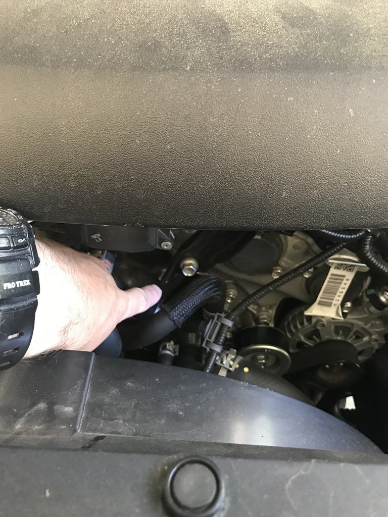

    Over the last 1000 miles, I have smelled hot coolant after driving with the engine loaded, like off roading up steep climbs. I have slithered underneath the truck a few times and have not seen tell tale leak paths or wet spots. Thanks for the picture, now I have a reference point.

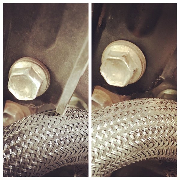

    Yes sir you have got the same problem I had. Couldn’t find the leak to small to see it. It was on the bottom bolt of the passenger side manifold. Get it scheduled to fix ASAP! Also make sure you 1255A710-5CA7-4757-90C9-C6D40DB9AC3D.jpg check the braket underneath your radiator hose. Picture below! GRIND THE Bottom corner off mine was rubbing the hose. Don’t want to get off somewhere and spill your guts lol

    I modified that bracket after 100 miles of ownership.

    It is confirmed, water bypass joint is cracked at the plastic seam. You can see the part is located at the back of the engine. Can't wait to get it back! @eurowner I would be suspicious of this part on yours since mine was leaking on my exhaust.
