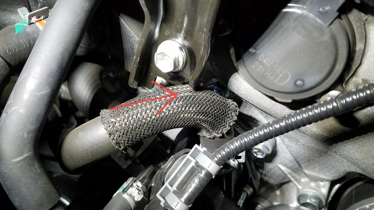

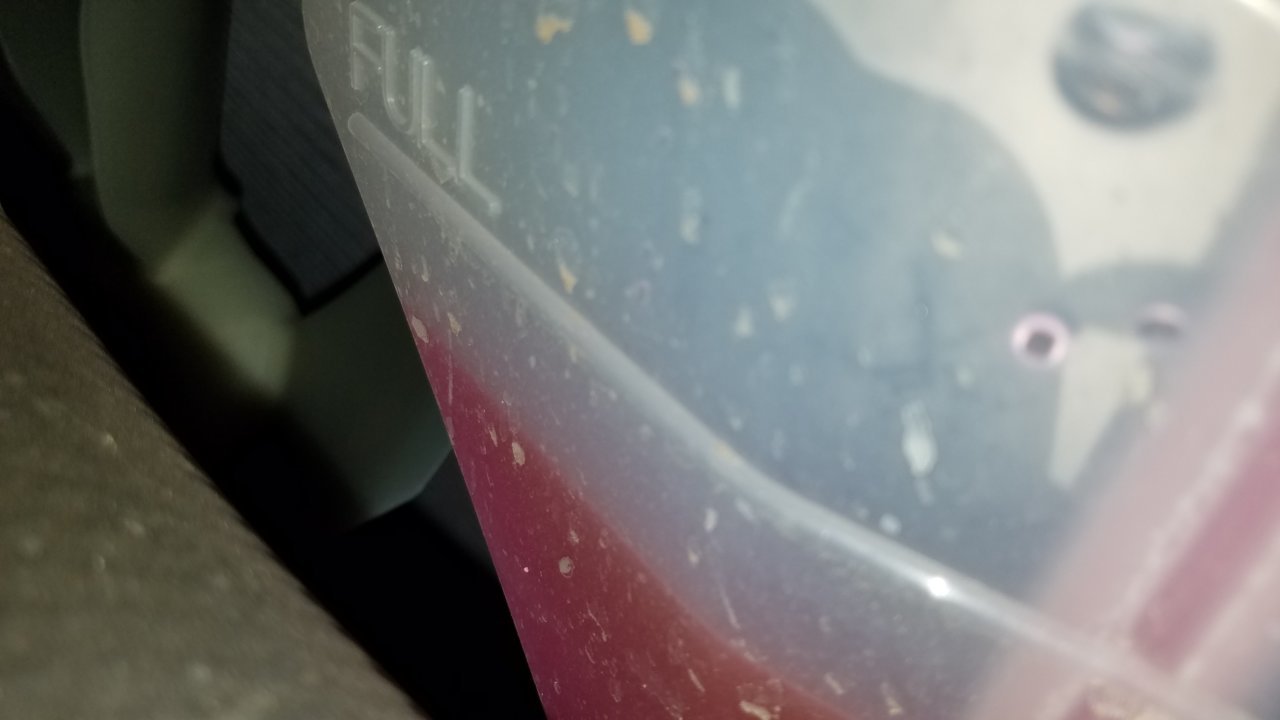

    This makes me think that i need to look for this , as i have wondered for a while now why it looks like my coolant bottle has been a 1 inch or so low ?

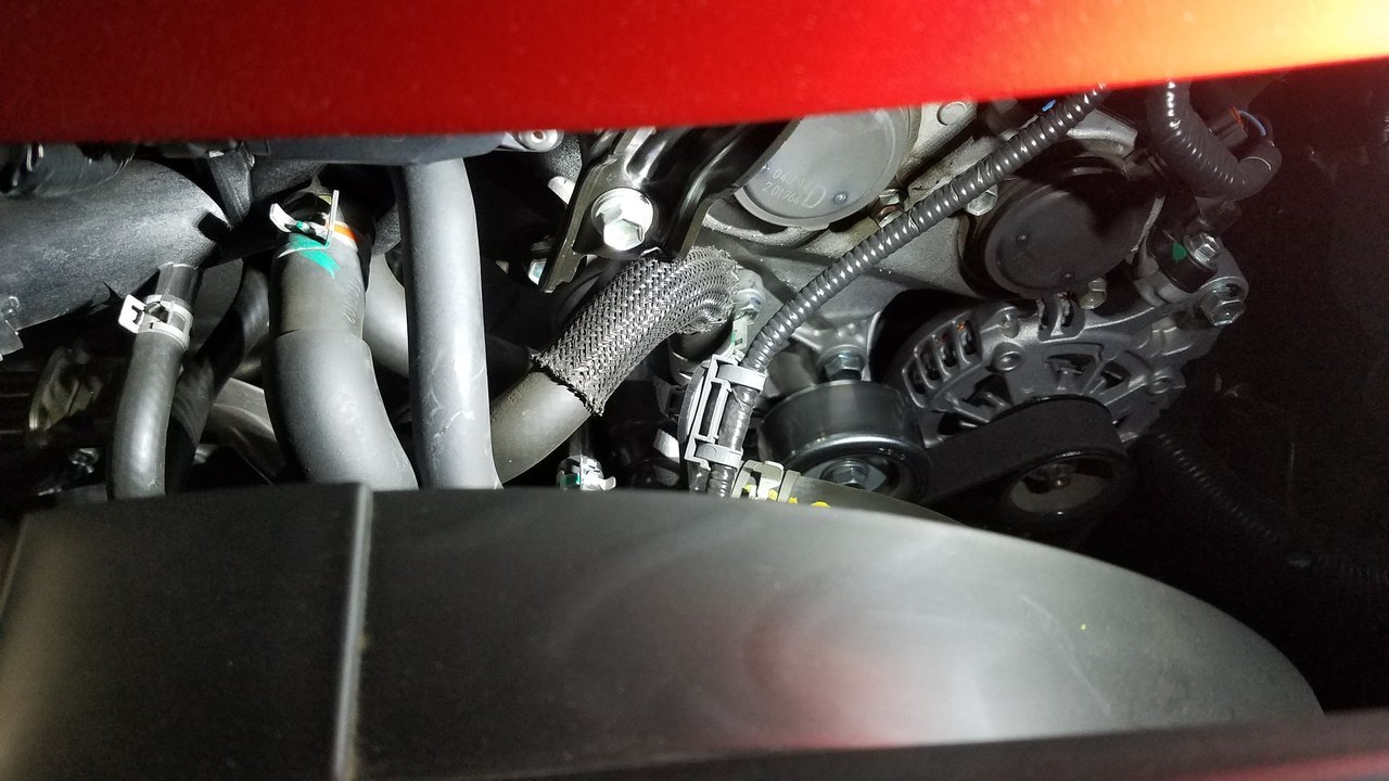

    As far as the coolant leak mine is good so
    far :fingerscrossed: and i just checked the bracket and there is a little gap in between. So far so good but defenitely will keep an aye on it...
