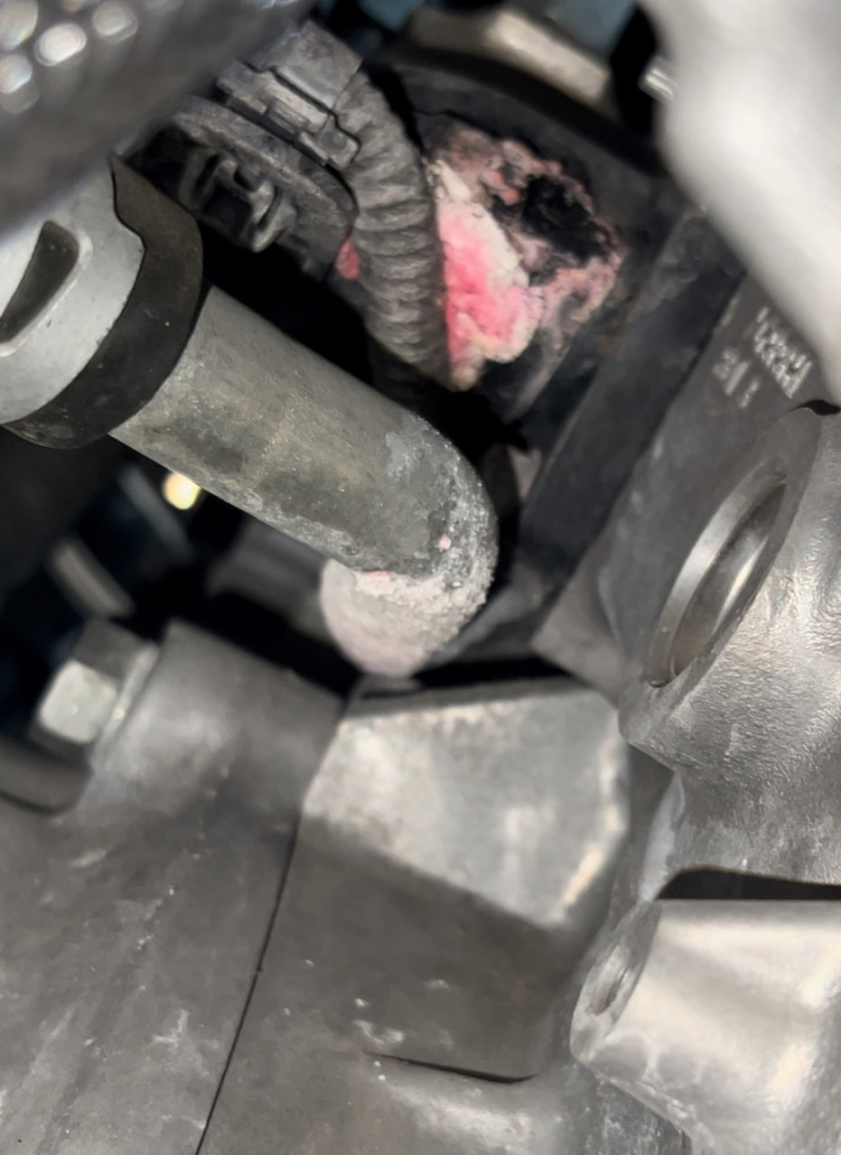

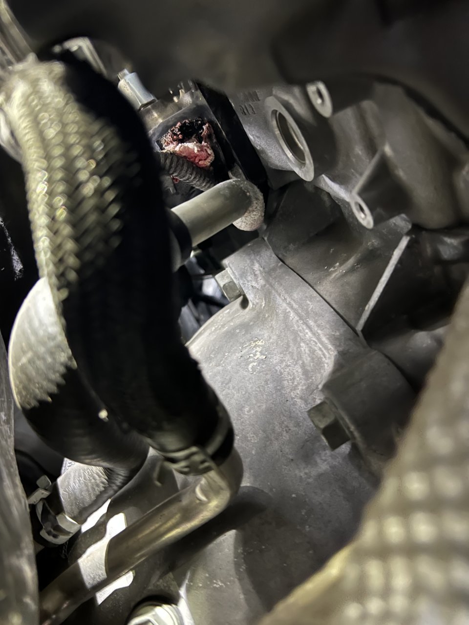

    I havent really noticed my coolant level real low. But I was curious and tried to see if I can spy anything on this rear coolant joint part. Best photo I could get from above. It started to rain so I’ll have to investigate further once the weather clears up.
    2017 with 84k miles on it. As far as replacement goes, is this a part we are going to have to replace ever so often?

    If this location is above the back of the transmission at the back of the engine it looks like the dreaded coolant crossover pipe leak. This mainly affected 2016 & 17's. I do believe there were a few other model years as well. One being as recent as 2020. It was inconclusive if Toyota issued a revised or improved crossover pipe from what I understand. Check out this video at the 14:20 mark and this Video at the 3:55 mark for more details.

    Yes sir thats the exact part I noticed due to the good peeps in this thread.
    I’ll just check w my dealer and see what the cost is. One of those things I dont want to mess with. :(

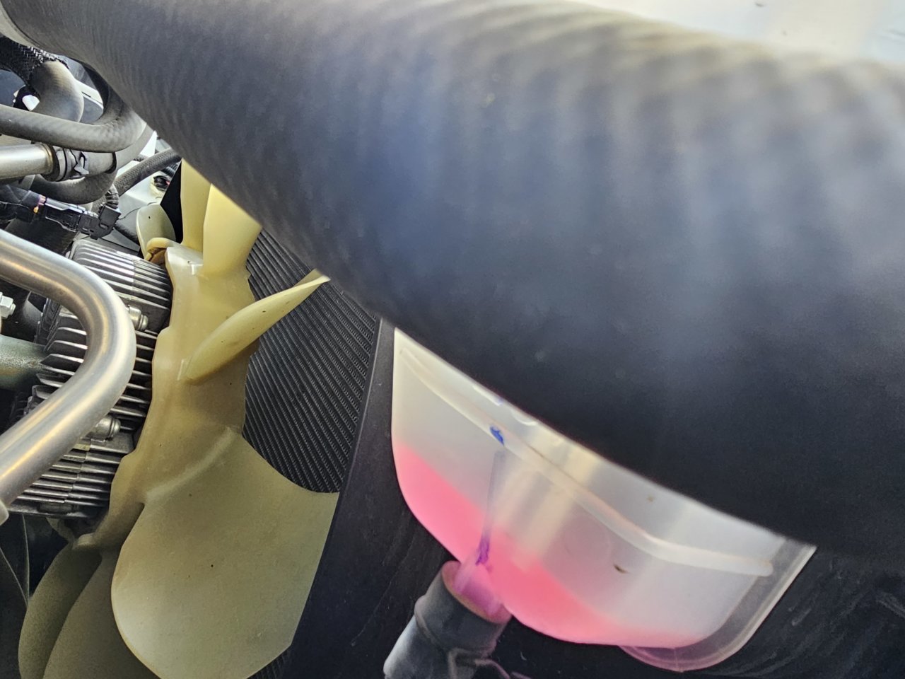

    I was changing the oil after a 5200+ mile road trip across the western states and found the coolant bottle was low. Radiator still full.
    I topped the bottle off and it is the first time I've ever added coolant since I got the truck off the dealer delivery truck in July of 2021.
    Likelihood that pipe is the culprit?
    Or could this be evaporative loss?
