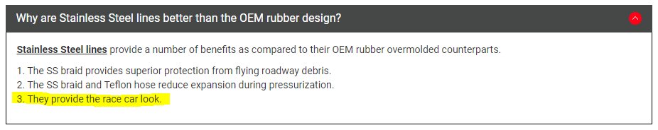

    Stainless lines don't do much of anything unless you're planning on building a Time Attack Taco. Which I mean, would be kinda rad, so please post videos if that's the case.
    Unless you *have* to change that last section of brake line for things like damage or in my case a big enough lift that the OEM line won't cut it, you won't notice any difference moving from rubber to stainless. Save your cash.
    The #1 reason people put stainless braided lines is in that article:

    No.you can't even see them so it's not a mod for looks.
    Rubber lines will wear after about a half decade of use, heat and winter road salt.
    They're also less than $200 so "save ur money" is a useless point.

    Look I love justifying spending money on pointless car stuff as much as anyone, and I've put stainless lines on a number of cars, but the brake line propaganda is thiiiiccc. I get it, I used to buy it too. It's fun to think you have the "extreme performance" problem that only a race car part will solve.
    I got stainless lines on my Taco, zero performance difference, but they do look fancy and you can see them because of my lift, so yaknow, bling bling. The only reason I did them is to get more length for lift and they came with the Maxtrac kit. If I had spent anywhere near $200 for lines just get a better pedal feel, I'd be woefully disappointed. If your brake lines are cracked and rotting, go ahead and upgrade if it makes you feel better, just make sure you quadruple check articulation and down the road, because the increased rigidity can undermine your connection. Same reason why you hear about oil coolers failing, even from OEMs - stainless line connections can be mad problematic yo. Cut a plane jane "rubber" brake line open, you'll find layers of reinforcement, it's not just a slinky rubber tube. If rubber lines were somehow bad, Lambo and Ferrari probably wouldn't be putting them on their cars.
    If the goal is a better feel, you're better off flushing the fluid, changing pads, and/or adjusting drums than you are adding stainless lines. Way less of a pain to tackle, with less risk of something going south like a banjo disconnecting from the more rigid lines binding - been there, done that. The only time a stainless line helps is in extreme heat situations, ie-track cars. On the street, off-road, or even autocross, you're never going to see those kind of constant temp loads.
