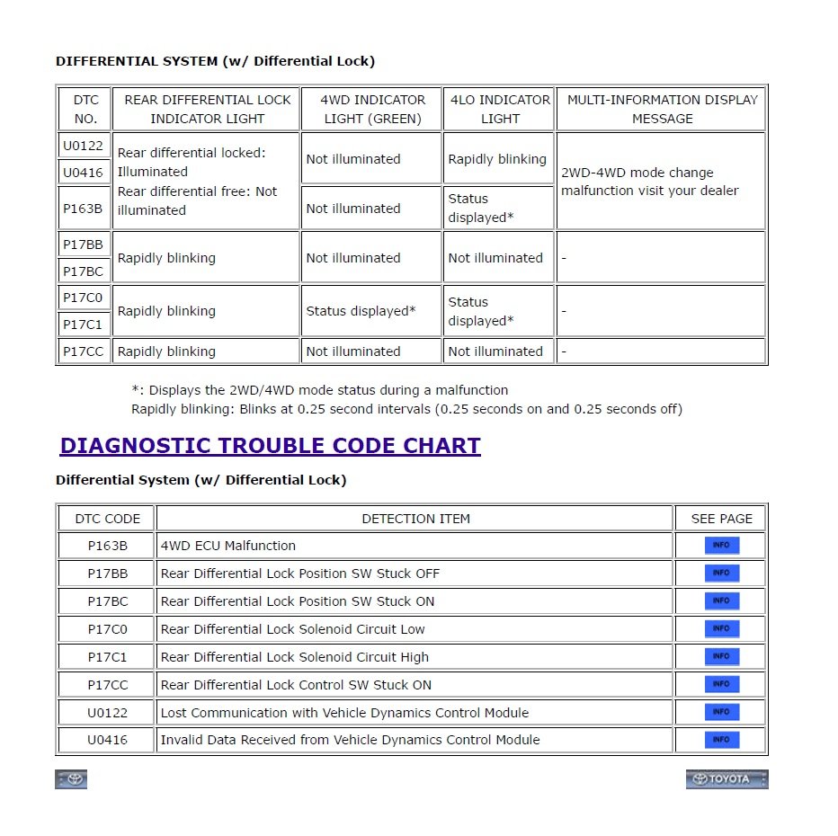

    If you don't have any other indicators, it looks like P17BB, P17BC or P17CC.
    Malvolio and shakerhood like this.
