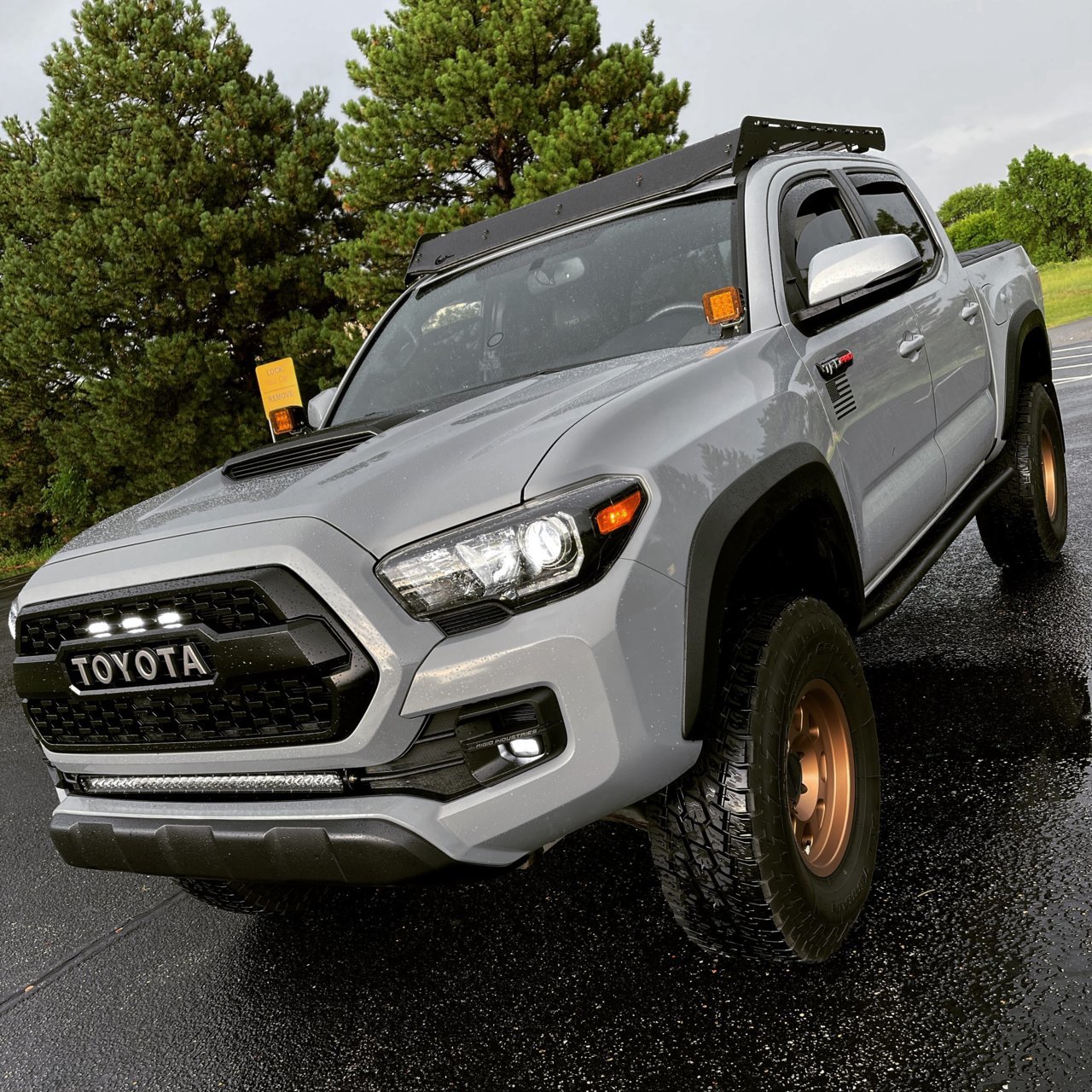

    Hi All,
    I purchased my truck last year and have been fighting issue after issue, but there seems to be one that I can't seem to fix or my local Toyota dealership or other off road shops.
    The issue is vibration between 40-50mph and being unable to break especially at highway speeds. The front of the truck will stutter and start violently shacking. If I continue to brake my breaks will lockup and I have no way to stop sufficiently. (I've had to use the E-Brake in some really bad situations)

    Since you got 33" tires, I'm assuming you have a lift? This could maybe be related to drive shaft/center carrier bearing vibration. Drive shaft vibration usually shows up around 45mph, but it wouldn't explain the other issues.

    As for your vibration, the ECGS bushing is good to do. However looking at you pictures, it looks like you are lifted pretty high. Lifting the truck too high will cause it not to drive good. Also, be sure to have it aligned above 2 positive caster. (you will need aftermarket upper control arms) This will help with wobble at higher speeds.

    Those look like method wheels.
    My Buddy had methods as well, similar symptoms. Took it to a mechanics shop, put the truck on the lift, 4 tires off the ground and threw it in drive. Literally could see the rims were not spinning true.
    Cause was bolt circle was not drilled 100% true. Wheels were not bent, just a bad batch.
    Second to above no wheel spacers installed, correct?
    You did say you tried tires… but did that mean you throw 4 stock wheels and tires?
