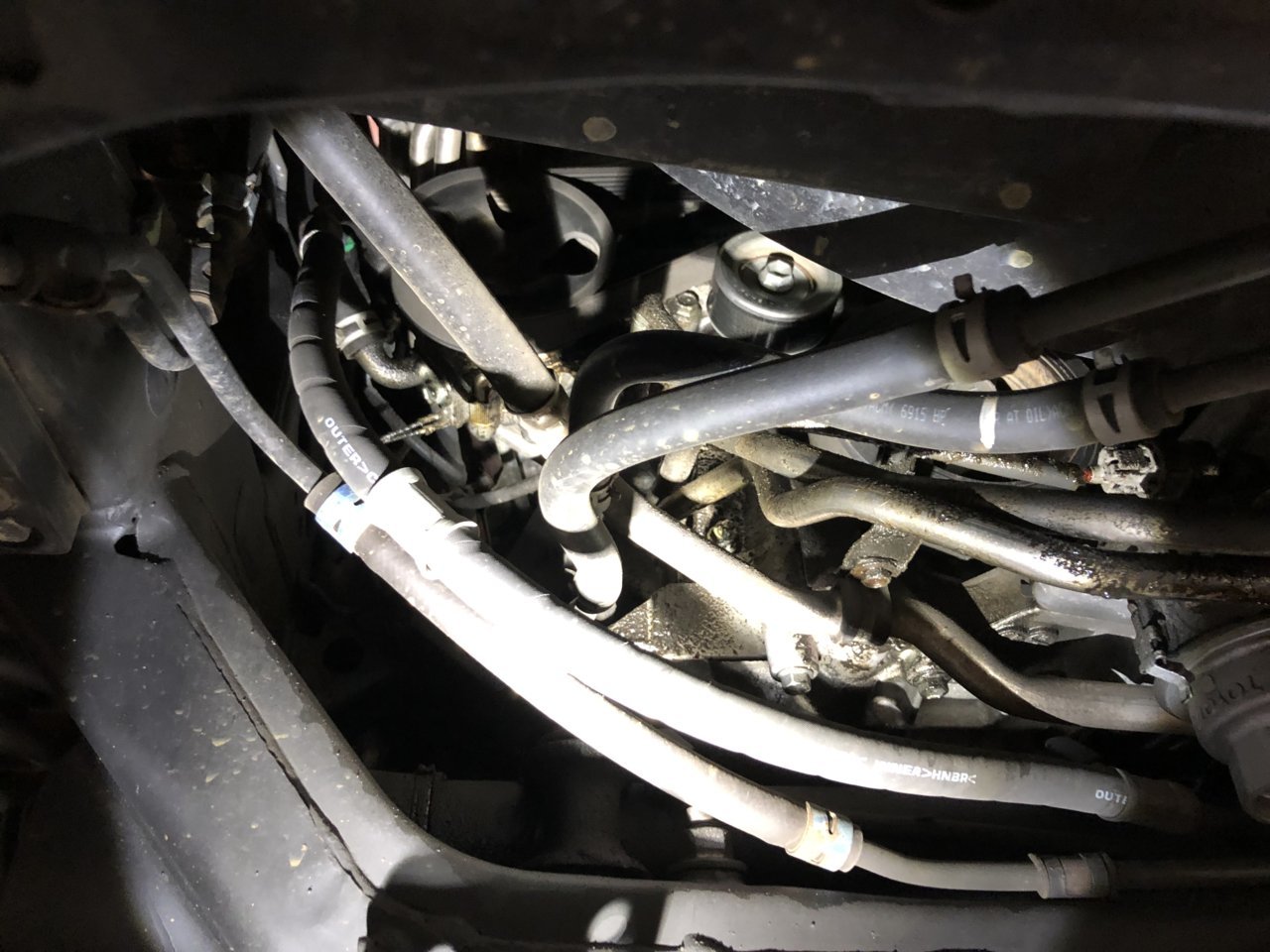

    I dropped my skid to do some maintenance and noticed oil around the power steering pump. I jumped on here to see if anyone had issues with the PSP and find out it could be a timing cover leak behind the PSP. I only have 47000 miles and warranty runs out 2/15/22. At the dealership today to see what they say and sure enough it’s the timing cover and they will repair under warranty. 5 to 6 Day job, they have to pull the motor. By the way the truck is lifted and they didn’t say anything about it.

    From what I have read there is a gap between the head and block they filled with silicone. I hope to get in the dealer when the motor is removed and I can see the area its leaking.
