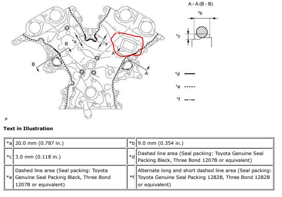

    on the edges of the tensioner cover or the opening on the timing chain cover . I would do is to seal the cover with rtv, clean the front of the engine and monitor for leaks before spending $$$ for repair.
    Toyota sealer is pretty good and take some effort to separate the cover. Plus, those surfaces are well machined and small amount of the sealer will seal it.

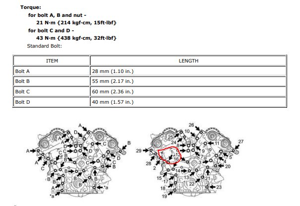

    also, most of the timing chain cover bolts are hand tightened (15 lb), except for bolts in the junction of the head and the block. If it leaks in that area (area A, B), i would just add rtv and tight bolts.

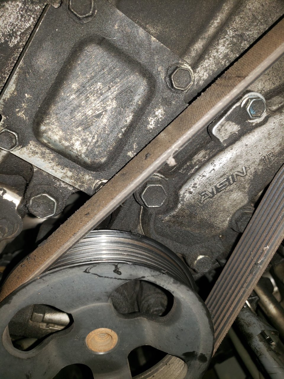

    Are you sure you have a leak? Do you see the oil drippings?
    I did clean my timing cover around the timing chain tensioner cover and did inspect the cover all around. I did tigh 4 bolts on the tensioner cover. 2 bolts were a bit loose.
    I don't see any evidence of leaks/sipping after cleanup and torqueing bolts.
