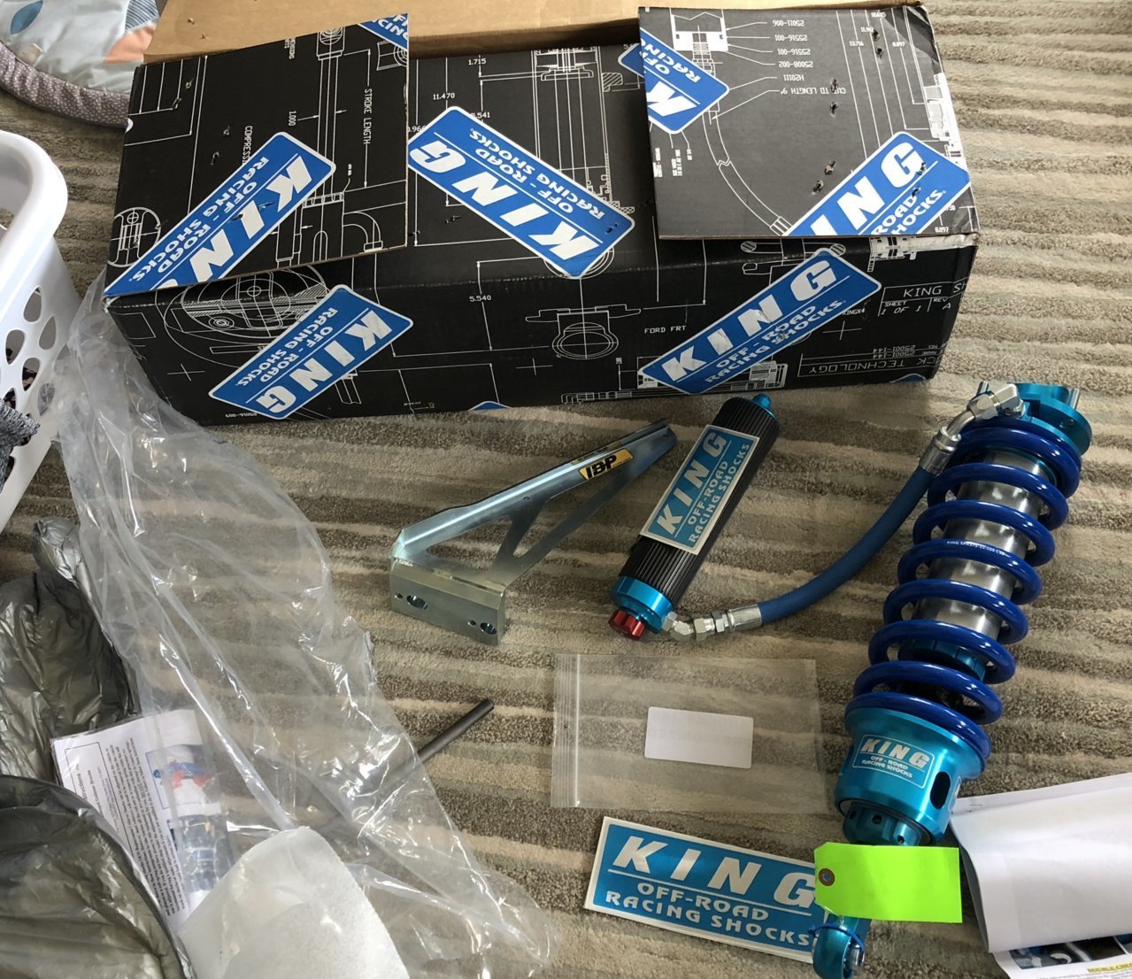

    Hopefully those Kings are sweet. Plan on getting some myself. Love the black accents with the lights btw. I would like to do something like that with mine but I cant copy. Gotta come up with something different. I don't know why I'm so anal about doing everything different.

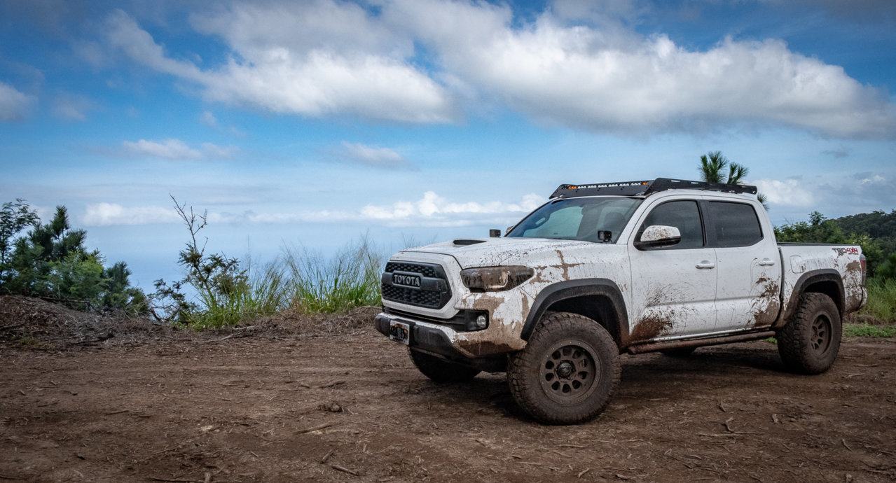

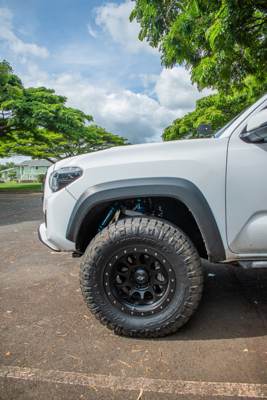

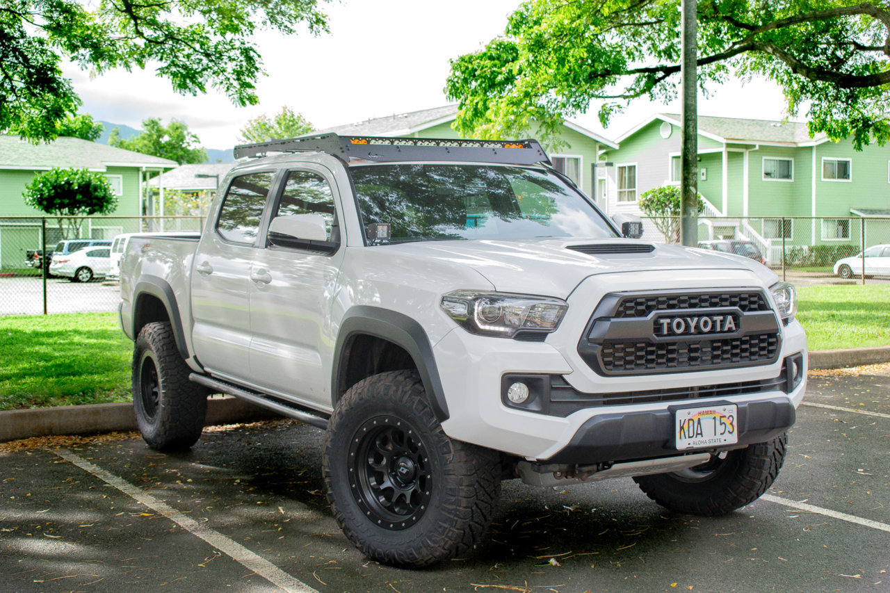

    Some updated pics. King 3.0s on, Icon Billet delta joint, Nitto Ridge Grapplers 285

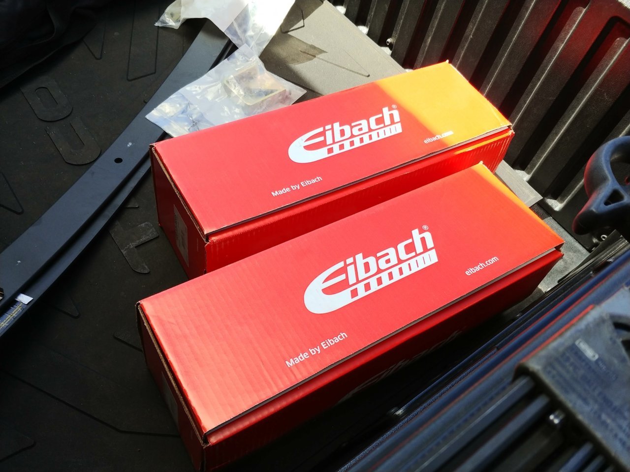

    update, ordered eibach 16" 650 coils to fix the rake, ill probably add another leave to the icon rxt to bring the back up as well, then CBI front and rear bumpers after

    why not 14” or do the 3.0’s use longer springs?

    they use 15x550s

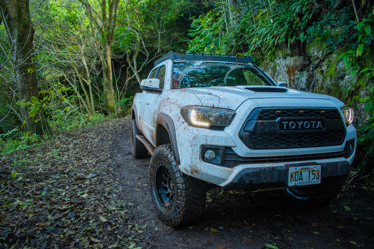

    Did some light wheeling today. Crazy to see the amount of droop these Kings give.

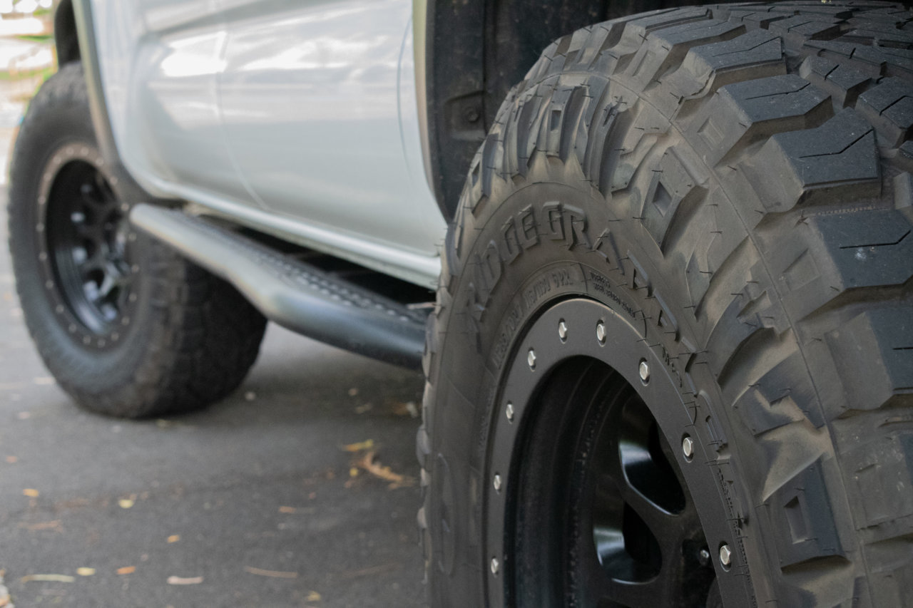

    This was the first time I had a chance to really test the Nitto RGs. I have to say I was really really impressed with them. It was reasonably muddy, I did not air down, but the truck soldiered along with few if any slip ups. Then right back on the road to a nice quite ride. These tires are amazing.

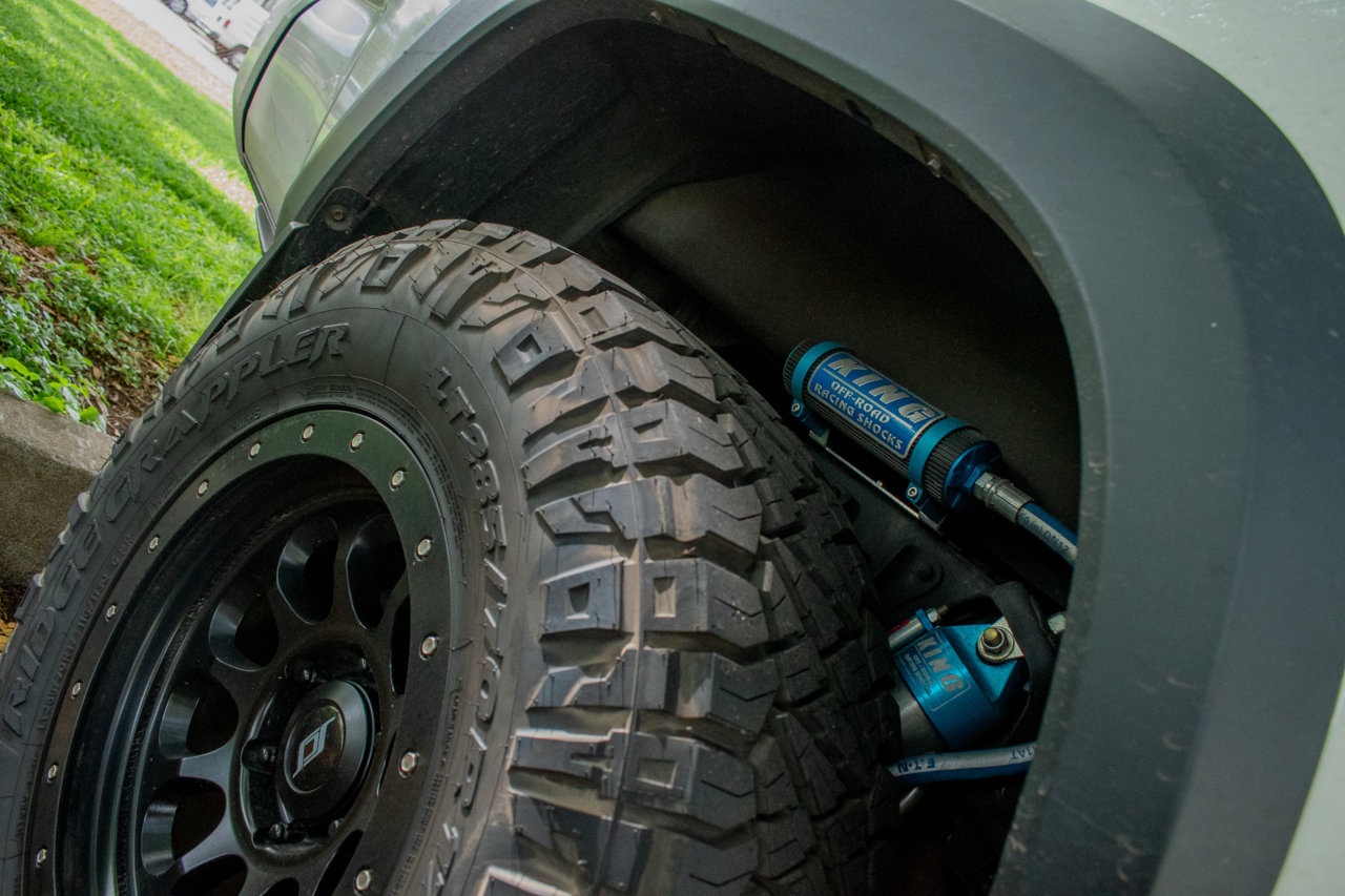

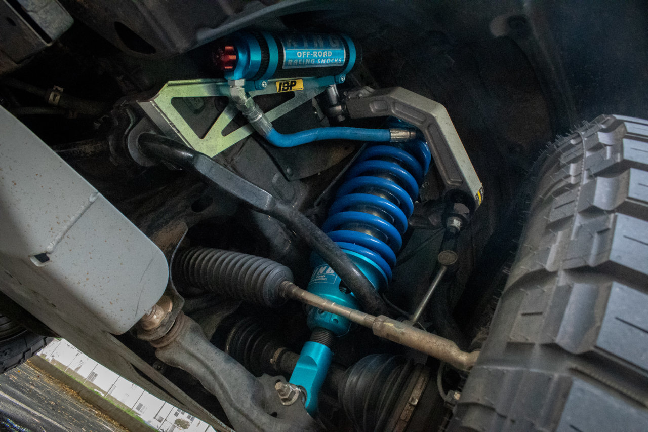

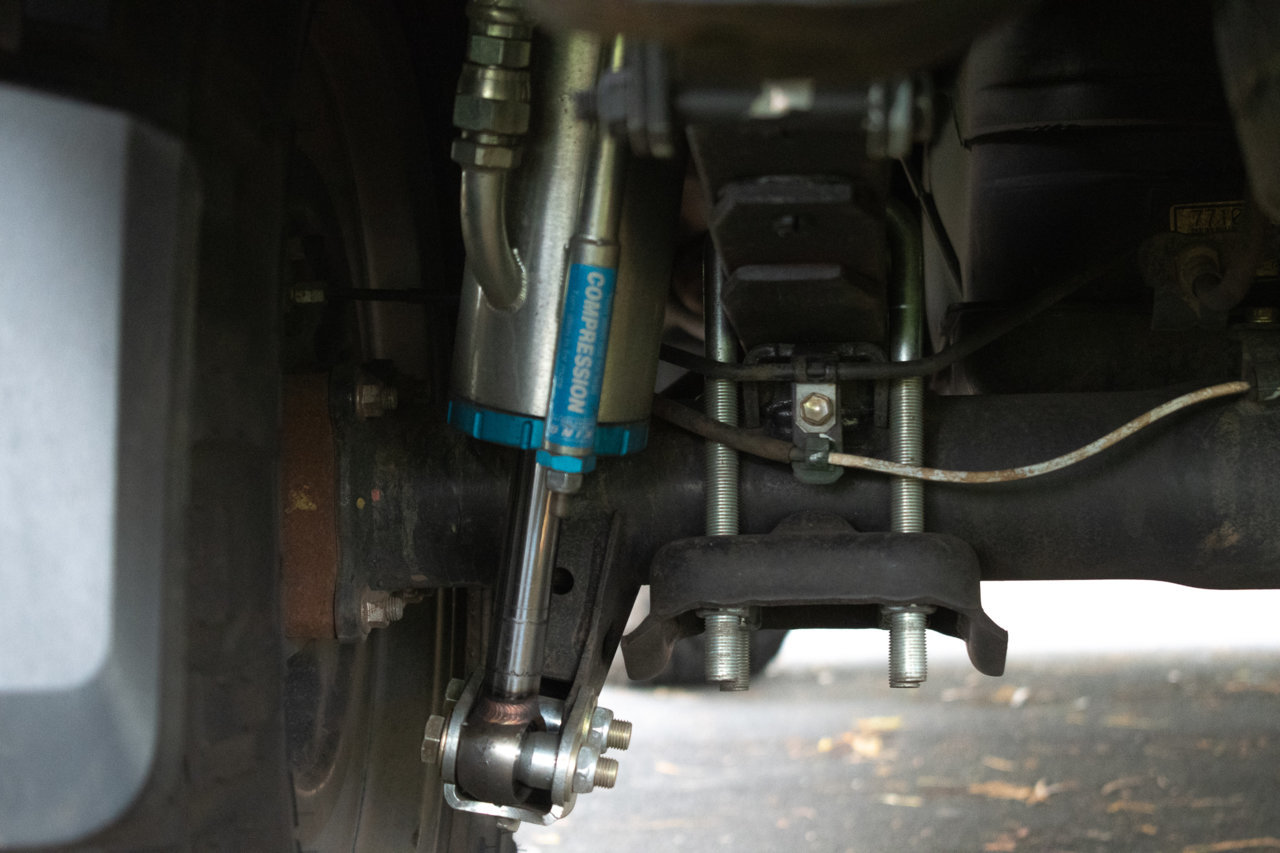

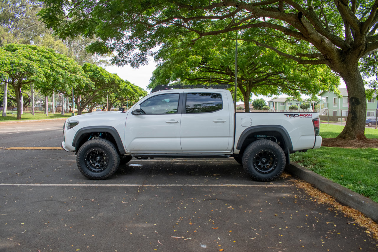

    Had the stock 550x15 replaced with 650x16 mostly to correct the ridiculous 1.5” or rake. After the install I think the front is maybe 1” higher than the rear. The springs feel pretty stiff and need some settling for sure. Will take some pics later.

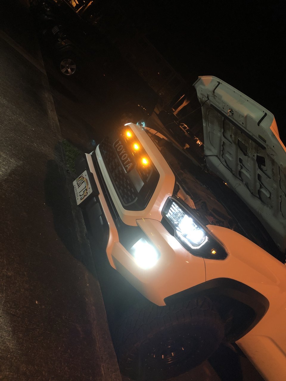

    Did the running4tacos raptor lights. This was a bitch to do. Filing down the grill was no fun. They have you tap the fuse for the driver headlight. This isn’t ideal because they only come on with the headlights. Going to figure out something else to tap later.
