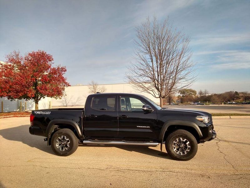

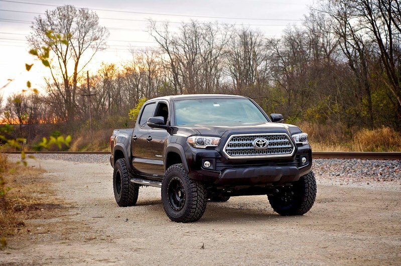

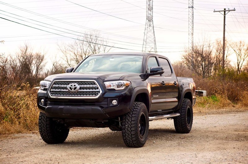

    First I want to thank everyone who contributes to TW. I learn so much from the information on this site, and appreciate everyone taking the time to explain their setups, issues, and post pictures. It's the least I can do to post information and pictures from my build for others to learn from.
    I searched high and low for a good shop in Chicago. It wasn't easy, but I kept reading good things about chitown4x4.com. I lobbed a call into Joe, and from the start he provided tons of good advice from lifts, tire selection, and fielded more questions than he probably should have. Highly recommend calling Joe if you're in and around Chicago. Not many guys that would work until 11pm on your build, send play-by-play via text, and take pics for you.
    Anyway, here's the build info:
    Truck: 2017 TRD Off-Road
    Lift:
    Bilstein 6112 - Front
    Total Chaos UCAs
    Bilstein 5100 - Rear
    Icon AAL - Rear
    1/4" space on driver side
    Wheels: KMC 17x9 XD Bully -12 Offset
    Tires: Cooper ST Maxx 285/70R17
    Was there rubbing? Yes (this is pretty consistent with everything i read on TW)
    Solution: Removed front mud flaps, minor cutting of plastic, and minor cab mount chop (nipped the corner off), they also used a heat gun to flex the plastic wheel well in the front to make a little more room.
    Just based on the highway driving this weekend, I probably lost around 1mpg (~15.7mpg).
    It's a little stiffer ride than stock, but really good overall. The tires are surprisingly quiet given the treat pattern.
    Here are some pics before/after:
