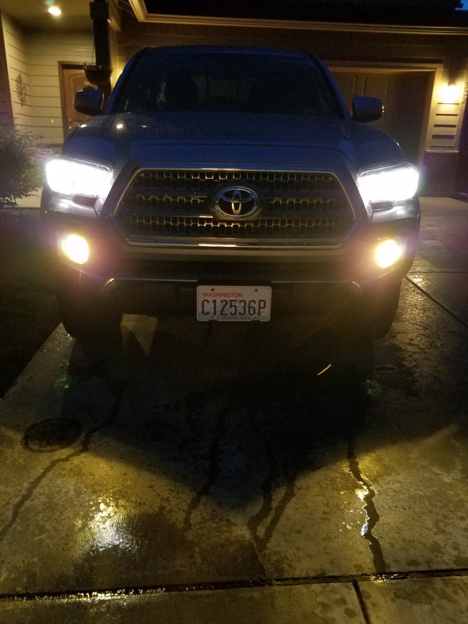

    There is a lot of discussion about putting LED’s in a fixture that’s not made for them, but with that said, I went with Diode Dynamic’s SL1’s and couldn’t be happier. Like you said the stock lights suck.

    Nope, I got some halogen bulbs at NAPA that have a yellow tint to them for the fogs.
