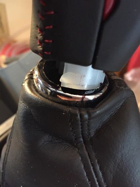

    Saw a thread on here discussing this part but none of them actually installed on a non- 2016/2017 vechicle.
    The part does not fit 2nd gen Tacomas as there is a plastic locking piece on the bottom, that my 2010 trd off-road's shift boot would not accept. Cost me $160 from the dealer, which is way too much but I needed a new one and this is the best looking knob I could find.

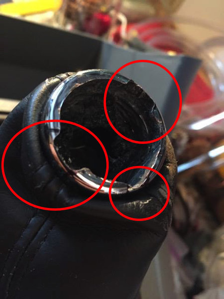

    Here is my old ripped shift knob

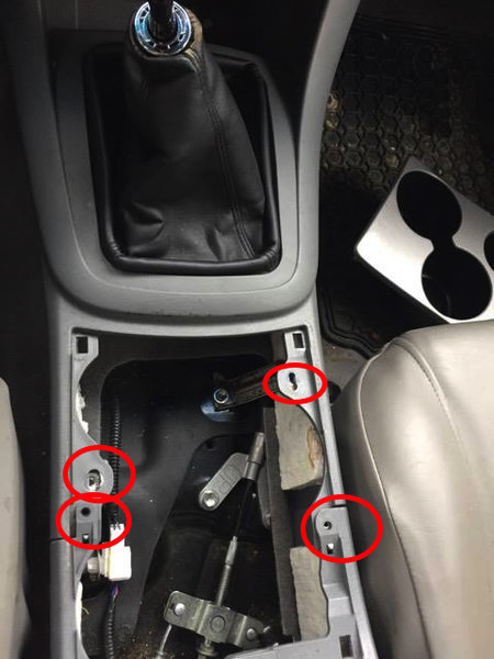

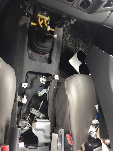

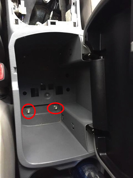

    1. Remove the center console by removing the following screws and bolts.
    17496255_10154332942935965_418983479_n.jpg 17496106_10154332943165965_2089145953_n.jpg
    always have a safe place to store your nuts/bolts so you dont lose them!17474100_10154332941470965_811588016_o.jpg

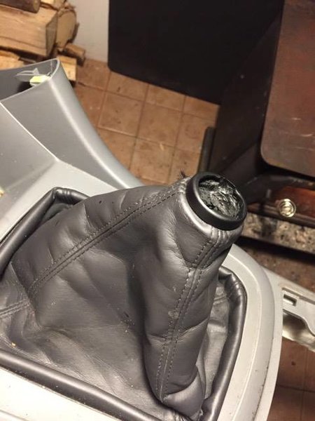

    2. Dremel the plastic chrome piece like so:
    17474748_10154332942635965_1855968078_n.jpg 17495751_10154332942460965_1151498795_n.jpg

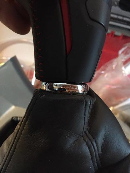

    I created a makeshift locking mechanism to accept the new knob, underneath the lip I have a groove dremeled to allowing the locking studs to twist after they go through the cut slots.
    17467722_10154332942160965_370704273_n.jpg 17495995_10154332942090965_777657957_n.jpg

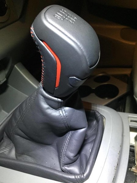

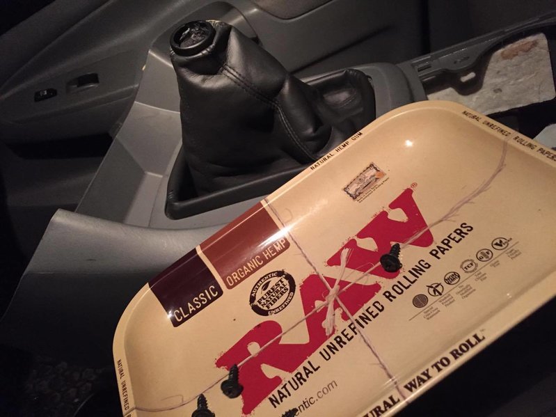

    Now put the console back together, screw on the shift knob and lock it to the boot.
    *may require and O-ring or tape on the stick itself to support the boot, mine did not.
    Finished product

    The threads are a close enough match to hold, it's the boot that becomes the problem. My knob is still going strong 6yrs later.
