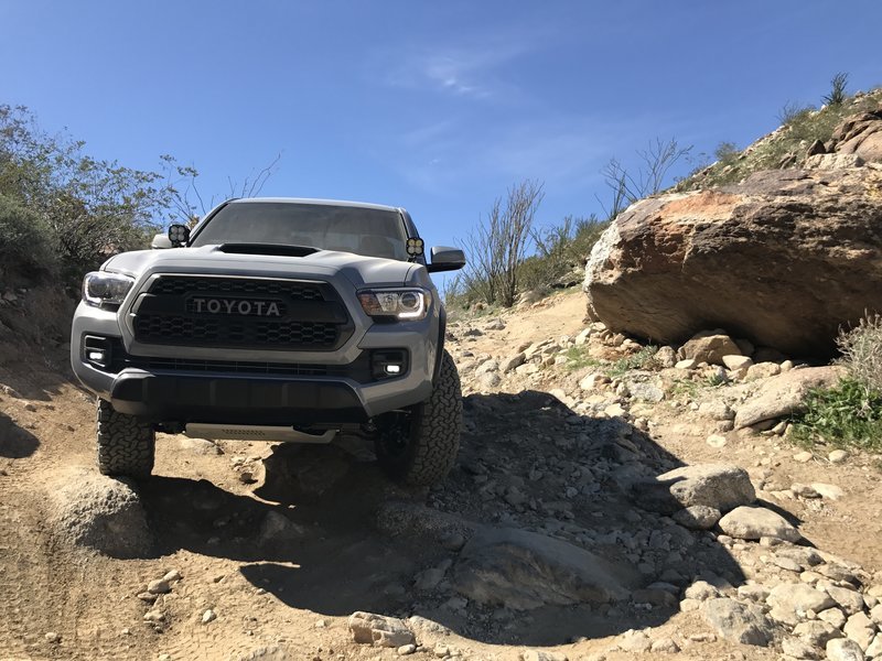

    Looks like coyote creek wash in anza borrego
