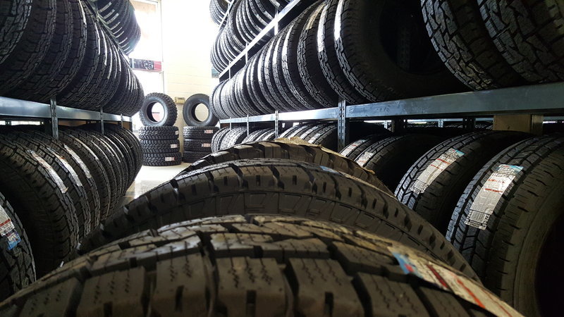

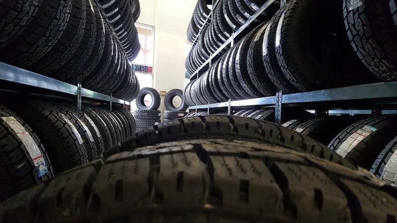

    Pics from today at Les Schwab 285/70/17s vs 265/70/17s20170425_143845.jpg 20170425_144022.jpg
    SilverII likes this.

    Maybe one is LT vs Pmetric? I know the same size in falken 285/70/17p and 285/70/17LT has the p metric 1.25-1.5" shorter.

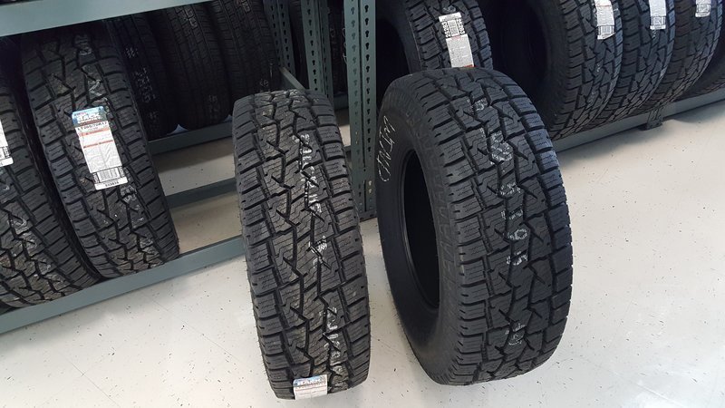

    Same tire, les Schwab backcountry SQ, here's a pic showing labels and next to a 255/85/16 Toyo mud tire

    Have to look at a les Schwab size sheet to be sure of the conversion.

    If you look at the size chart on their website... you will find that the 265 has a ply option if 10 and 6 while the 285 only offers a ply option of 10. My guess is your looking at a 6 for the 265 and a 10 on the 285...
    Also your photo is a bit off to measure actual height.
