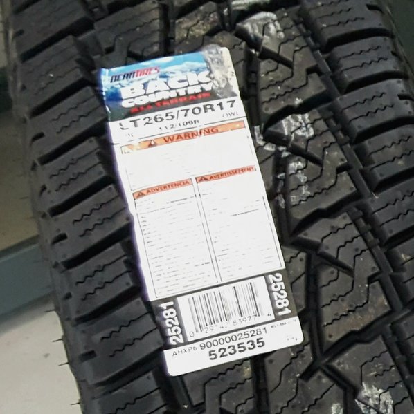

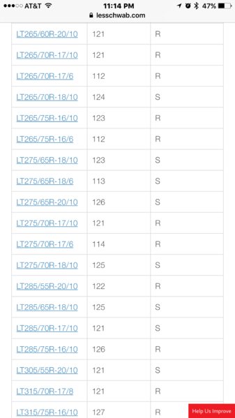

    Agree the photo sucks ass, looked at Les shwab site and can only find one load index for their "backcountry" in 265/70/17 maybe I'm not looking in the right place
    Edit look3d at size chart yes I see the C

    Your pic shows both are LT versions. 2 different plys, 2 different load ratings, 2 different tread depths would be my guess as to why the 285 is slightly taller.

    Closeup of the 265 confirms you are correct this is the 6ply20170425_231641.jpg

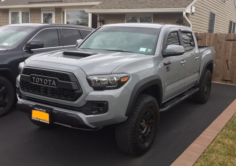

    285/17's here.. no CMC required. MINOR fender trimming.. all depends on your wheel offset though

    So if you have a 285/75/R17 on a TRD PRO with no chopping, no rubbing, I should be able to put a 285/75/R16 with little to no problem!

    17x8 5mm offset They are the TRD knockoff wheels from ebay. Excellent quality in my opinion.

    Im running them on mine too. 285 70 17. Fuel rims 17x9. Have to trim inner fenders.

    He is running 285/70/17 which is a slightly smaller tire than 285/75/16. TRD pro wheels are +13 offset.

    I'm running 285/75r16 no problem and I actually off road. If you're staying on the road you will have absolutely no problem at all.
