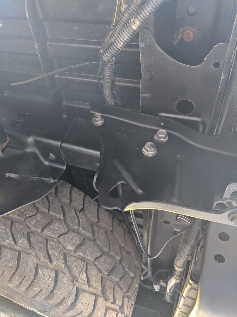

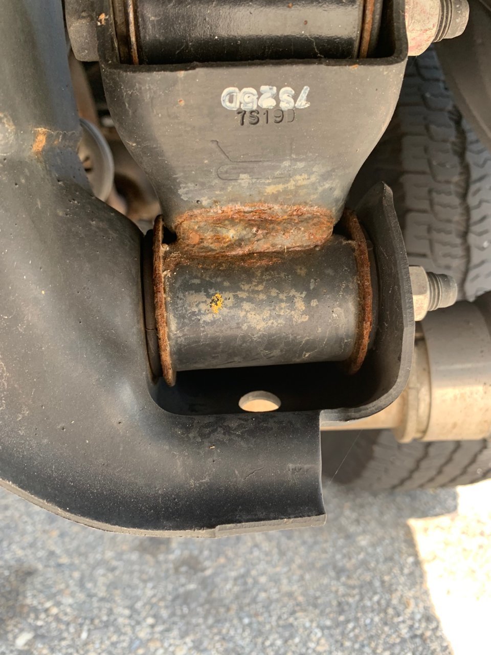

    Hello, I don't post a lot but wanted to share some undercarriage surface rust that I'm starting to get on my 2017 Taco. I'm from New England and have about 34,000 miles on the truck so it has seen a few winters and more road salt than it probably should. I bring it to a car wash often in the winter for a wash with undercarriage spraying (no idea how well that works). Anyway, I was wondering if any of you paint over your surface rust, or lightly sand it down and cover it with any product. I've heard of spraying used motor oil on the underside of the truck, but I've not tried it. Any suggestions would be appreciated. Thanks in advance.

    Paint it with chainsaw bar oil. Repeat once/mo for 3 months.
    It lasts for a couple years a bit South of you. Check it once in a while, cuz rust spreads quickly.
    Edit: scrape the flakes away. They trap water. Trapped water, like you get with any non-factory spray on "sealant", will rust your truck away in no time.
    This stopped my '05 Tundra from crumbling away. I was amazed by how well it worked.

    That's nothing to worry about. Just start using a product called fluid film before every winter.

    Probably works better because fluid film is designed as an undercarriage protection. Sure you could probably let it go longer but once a year isn’t unreasonable at all.

    When I still had my 2011 I would take a wire brush to the rusty spots on the underside about every other year, then pime and paint. Seemed to work well and I could do it with stuff I already had in my garage.

    I have a 2015 and all the frame welds are starting to show rust. I bought it last year and it’s pissing me off a bit. But I live in Maine so f me right? Just used fluid film yesterday and it’s crazy the difference I can already see.

    Mine looked similar until a couple weeks ago. Hit all the spots with a wire brush, washed everything real good and let it dry.
    Then hit the spots with rust converter, and top coat of flat paint to blend everything in.
    Final step is your rust inhibitor of choice. I chose Mavcoat for everything I can reach easy/ may be working on down the road. Fluid film will be applied soon to boxed parts of frame/ spots where I couldn't get a good shot of the other stuff on.

    A 1/4" thick hitch receiver? Me thinks not. Only thing that op pictured that I would fix immediately is the bottom pic. The shackle too, but thats easily replaceable if need be.
    +1 for fluid film. In my opinion, it trumps all other products that you can apply to your undercarriage for one reason. It seeps. Spray a little on your frame, 2 weeks later the wet spot will be much bigger. It will soon be time to spray my 04 next month. Sucks to do, but worth it to know my truck is protected.
