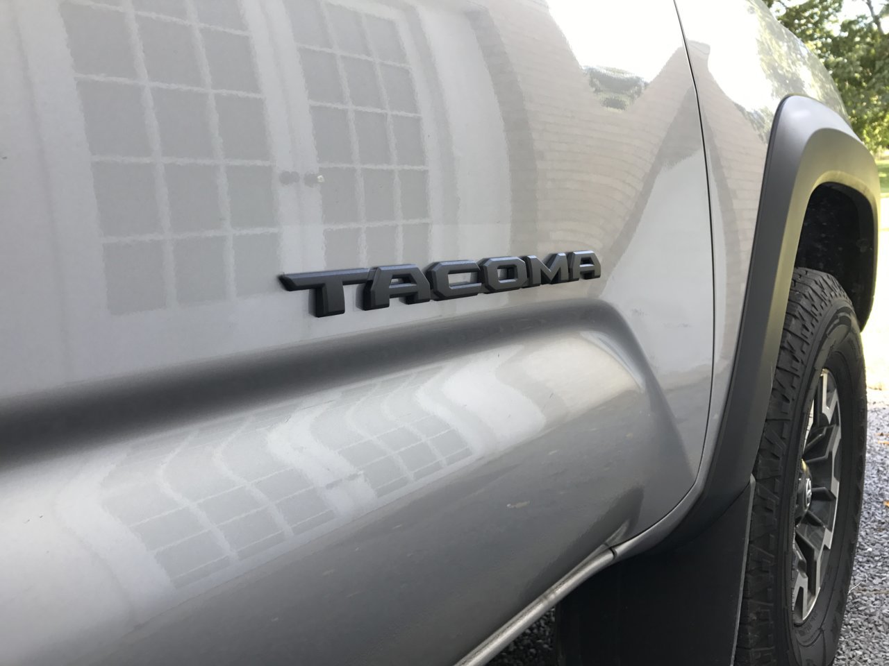

    Do not do that. If you are OCD you will regret it. Once you get them off you will be happy. Once you paint them you will be happy. When you try and put them back on, how are you going to do it? Double sided tape? Not a good idea. You will have to cut around the letters etc.
    Buy the cheapest unused set you can find on eBay or wherever. Paint them and then apply. Use tape before removing your original set to mark off every corner and reference point you can and then remove. That way you will put the painted ones on perfectly.

  15. Aug 31, 2018 at 1:50 PM

    I did like 5 or 6 coats of flat black (plenty of drying time in between) and it matches the fender flares perfectly on the OR.
