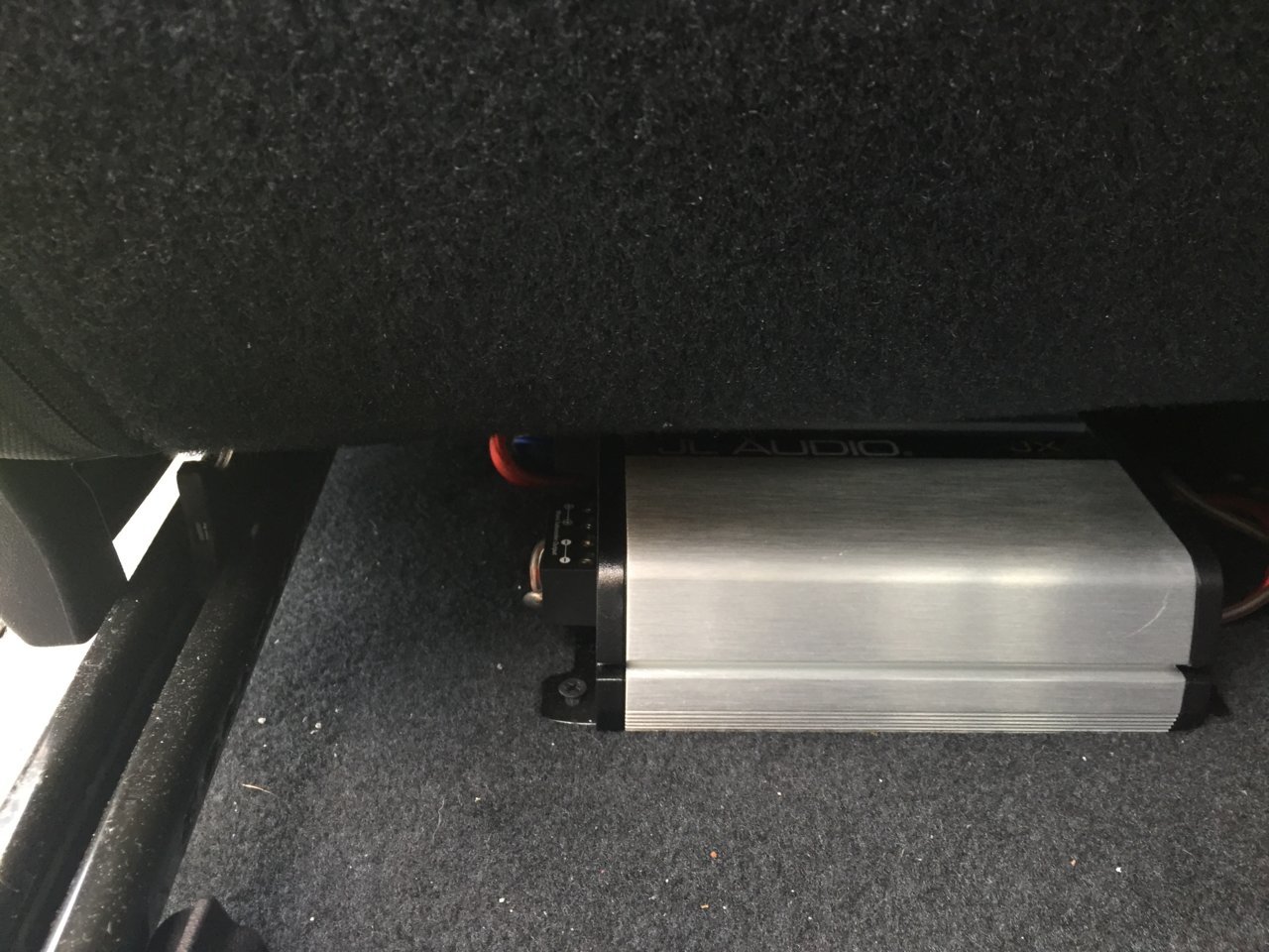

    Did you put the amp over the vents?
  8. Jun 14, 2019 at 9:24 AM
    flattie
    flattie [OP] Active Member
    Jul 1, 2018
    #257986
    44
    2018 Silver Tacoma TRD OR DCLB
    I will have to check when I get home - I had an installer do the work. I know the amp is under the driver seat but I can't recall if they placed them on top of or to the rear of the vents. I think it's the later but let me get home tonight and take a pic or two.

    Thanks man... I have the same amp and can’t figure out how I want to mount it .... I’m leaning toward the “glueing” mdf on the floor board under the seat method or possibly the Velcro idea

    Here’s some pics

    I was able to make spacers that push the rear seats forward just enough to mount my amps above the subwoofer box. The only place a decent size amp would fit without putting them in the back is under the driver seat. I pulled the last section of the floor vent tube out and taped the end going to the blower when I first installed my amp. Now they’re both in the back and vent reinstalled
