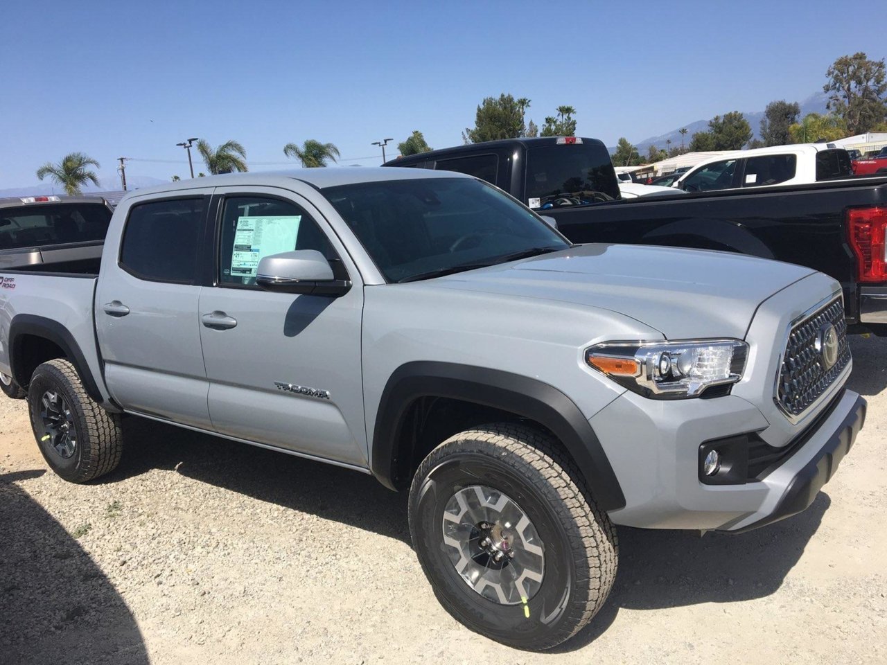

    OP: I did a build thread for my last car over 6 years and it was a lot of fun. Please follow along on both my adventures and misadventures as I attempt a mild build on my new Tacoma.
    I bought her brand new before she even got to the dealer. Cement is a tough color to get here and dealers won't go down but maybe $500 off MSRP if they even go off MSRP at all.
    This is a TRD OR DCSB RWD base. I paid $34k for it. First new car/truck I ever bought for myself. Why the RWD? I have had 4x4 trucks for over 10 years and have probably used 4x4 maybe a couple hundred miles at most. I think the rear full locker will meet my needs.

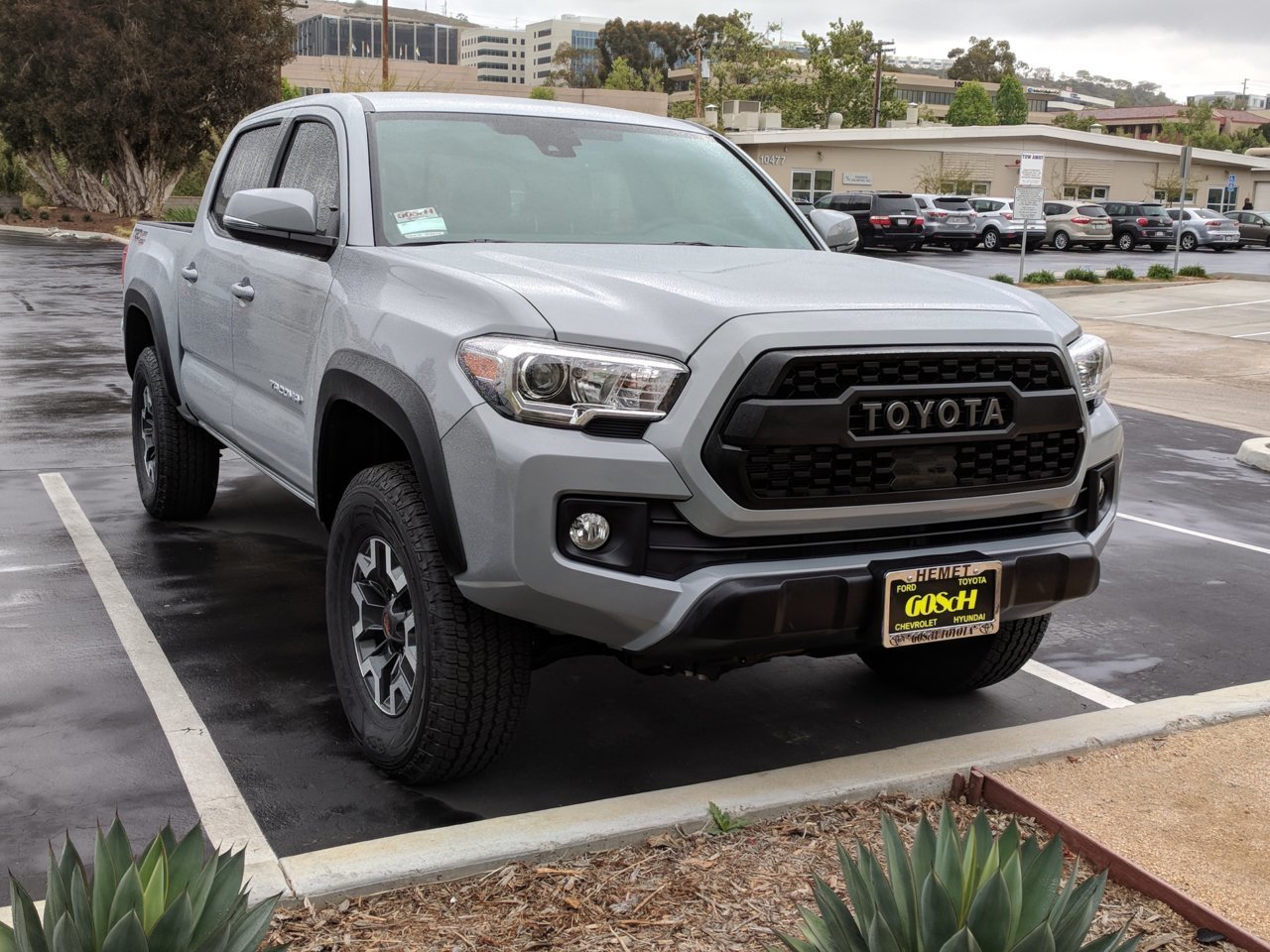

    Next up was a TRD pro grille (knockoff) with the garnish in place for the sensor. Overall fitment was good, I had to hack the grille up around the garnish to fit it properly.

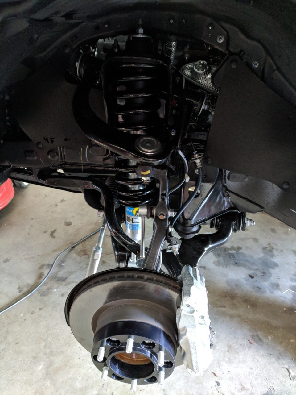

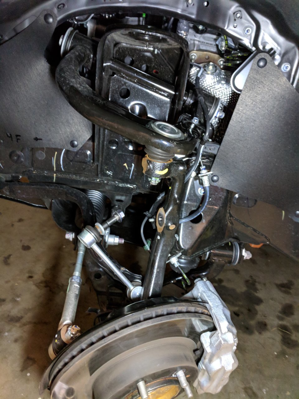

    I have never worked on a brand new vehicle before. I couldn't believe how actually enjoyable it was to pull the struts out in preparation for the new springs/struts. I usually abhor suspension work.
    DavesTaco68 likes this.
  9. May 11, 2018 at 9:00 PM
    dal3_gribble
    dal3_gribble [OP] Well-Known Member
    Apr 14, 2018
    #250494
    1,201
    Crew Cab SB TRD Offroad

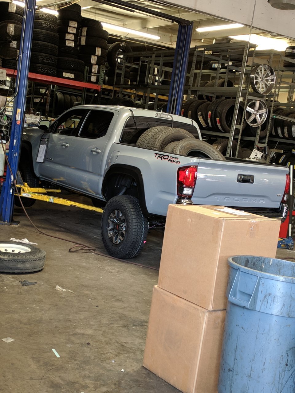

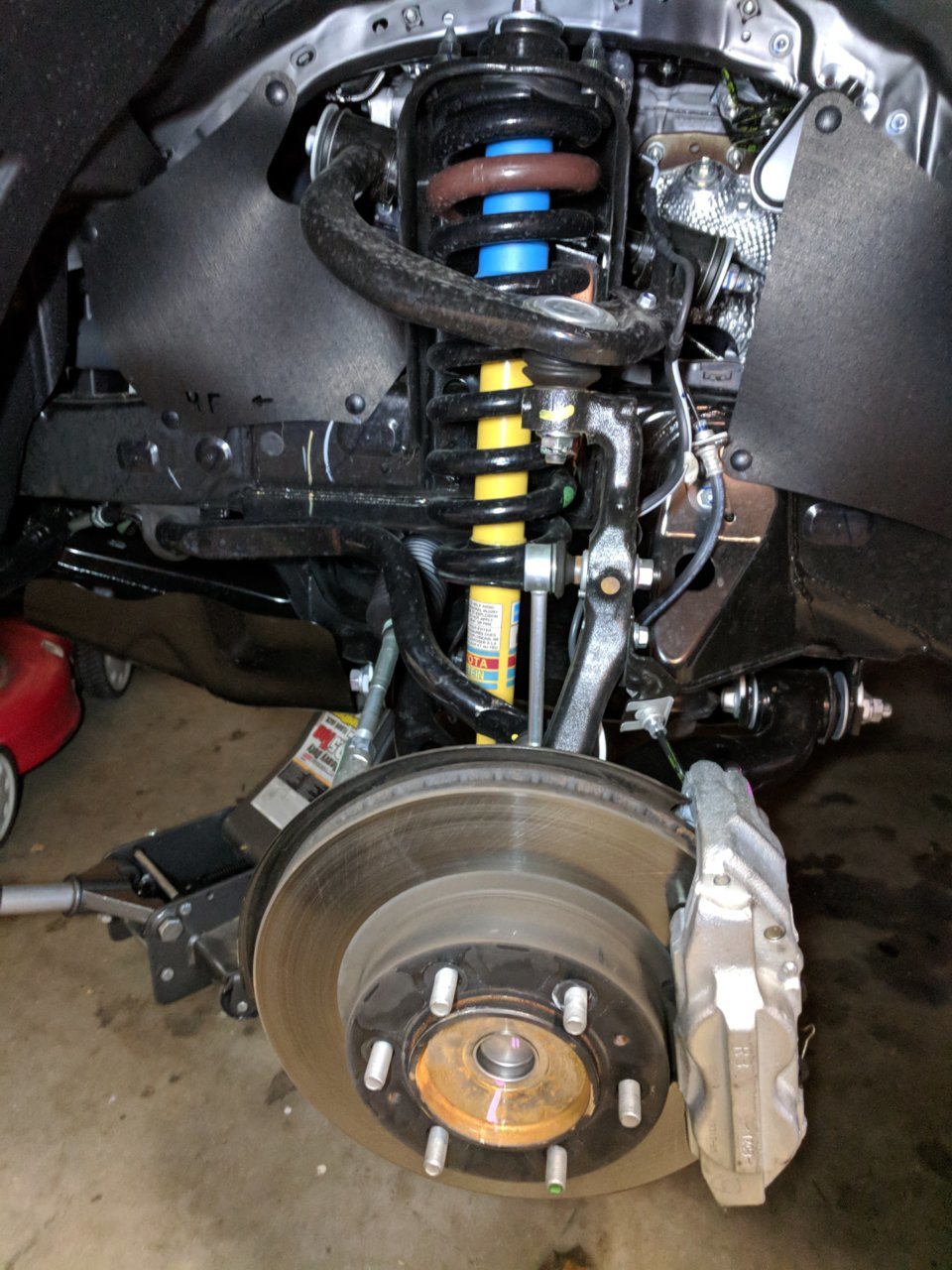

    Struts out, I'm at the age where I want to save $$$ on labor but I'm willing to throw a few bucks at a shop to do the stuff I don't want to do. So, I'll take them to the tire shop tomorrow to get the strut mounts and coil isolators moved onto the 5100s/885s. I kind of wanted to keep the stock struts together, but we couldn't find the parts for the 5100s/885s to build up a full set.

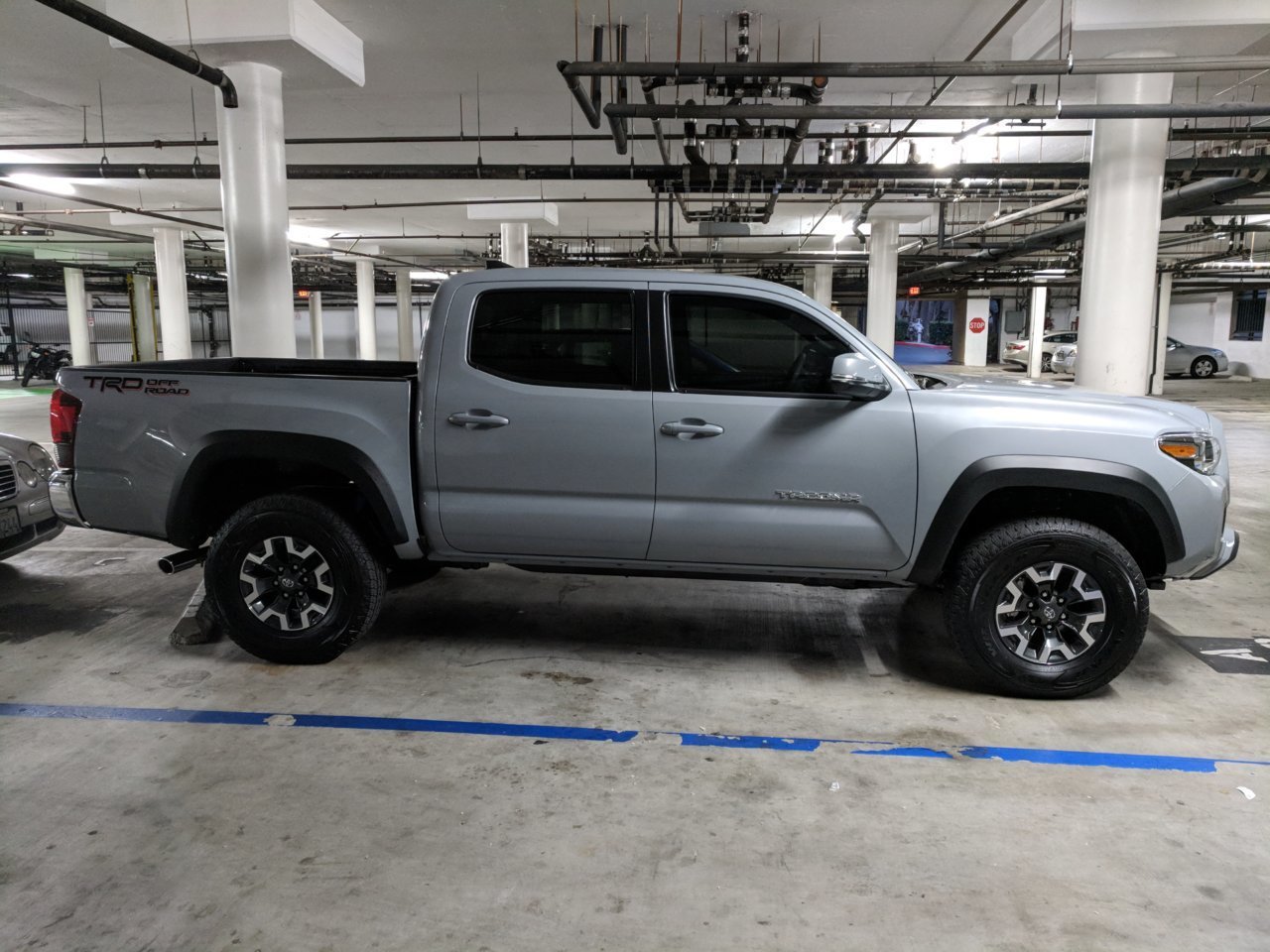

    New struts/ome 885s, rear blocks and 1.25" wheel spacers in.
  12. May 12, 2018 at 4:12 PM
    dal3_gribble
    Apr 14, 2018
    #250494
    1,201
    New fender measurements to follow after settling. This is after driving about 5 miles only.

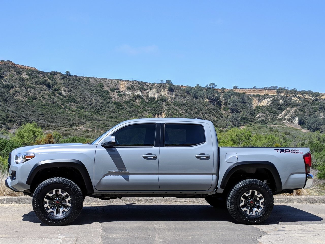

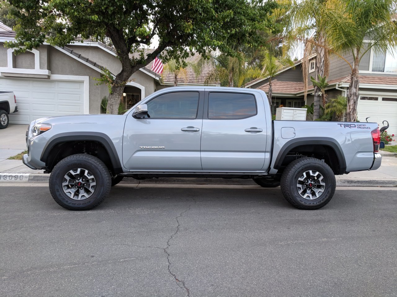

    Ok, so before/after lifting the front and rear measurements; it's dead level:
    BEFORE: Left/Right Rear 21.75" AFTER: 22.75"
    Left/Right Front 20.25" AFTER: 22.75"
    So, the rear went up and inch (of course) and the front ended up 2.5". No left to right lean to speak of. I really want the front to settle about 0.5" though. I do want a little rake still.

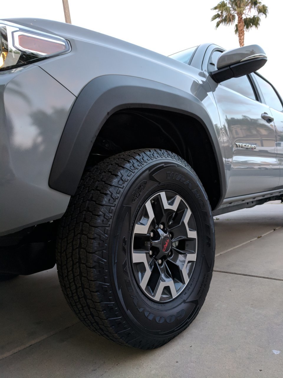

    Tires on, on alignment rack meow.

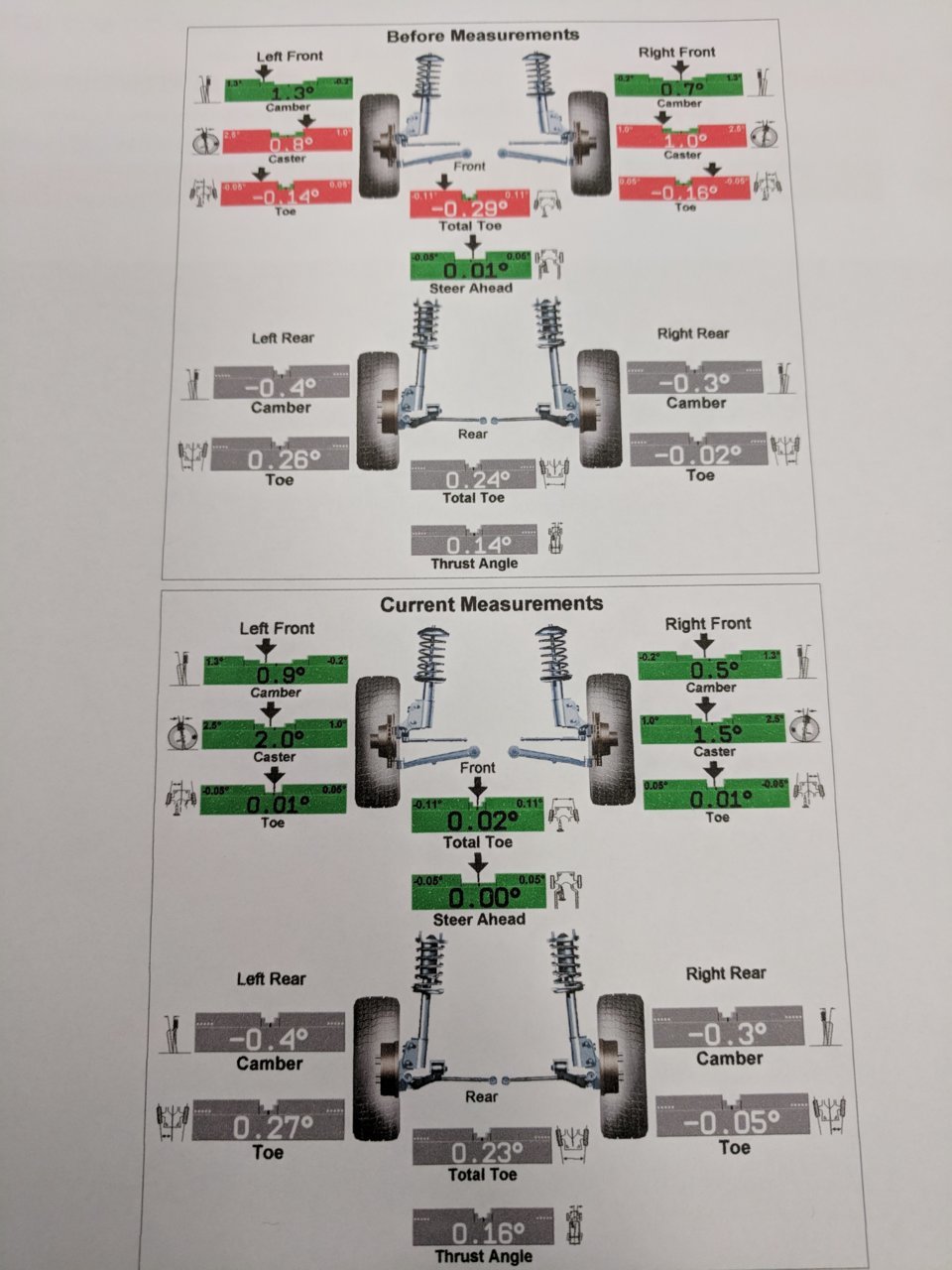

    Alignment done. Caster was pretty far off after springs.IMG_20180514_100248.jpg

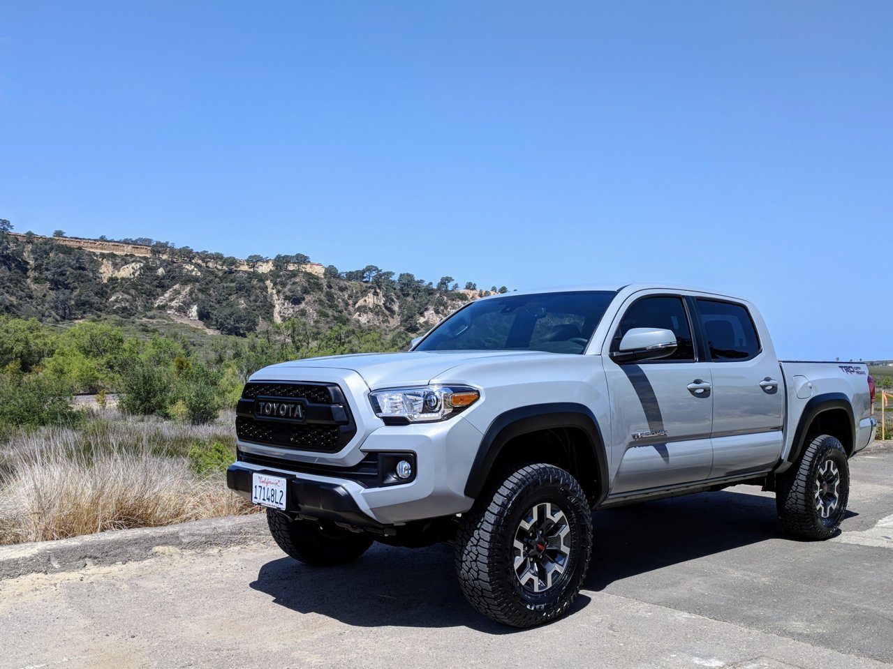

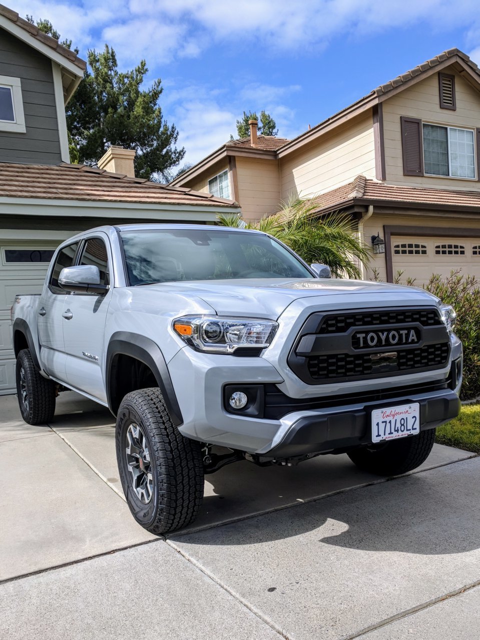

    Ok, finished product. I love it!
