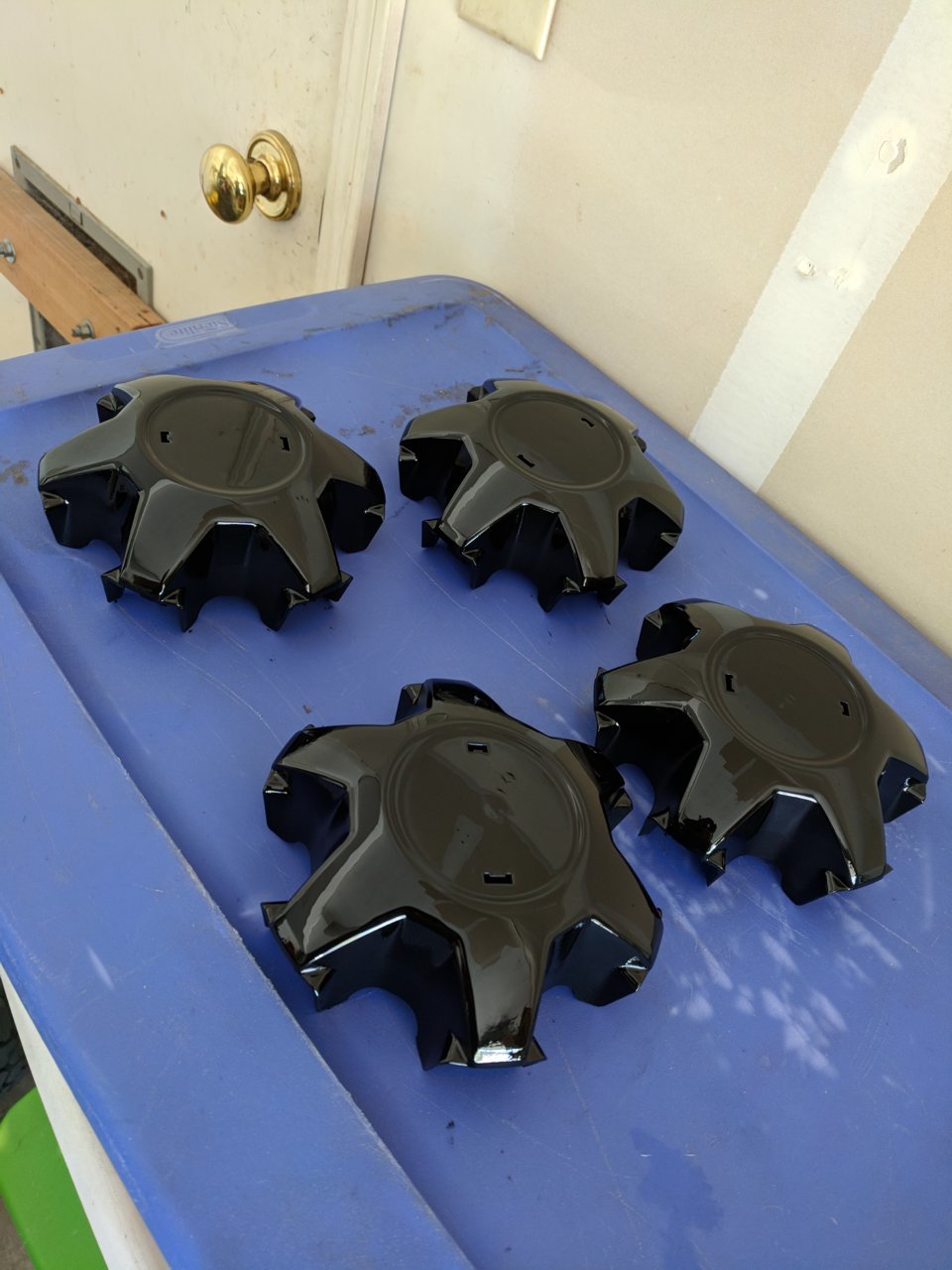

    All 4 done and drying.
    Center caps painted.

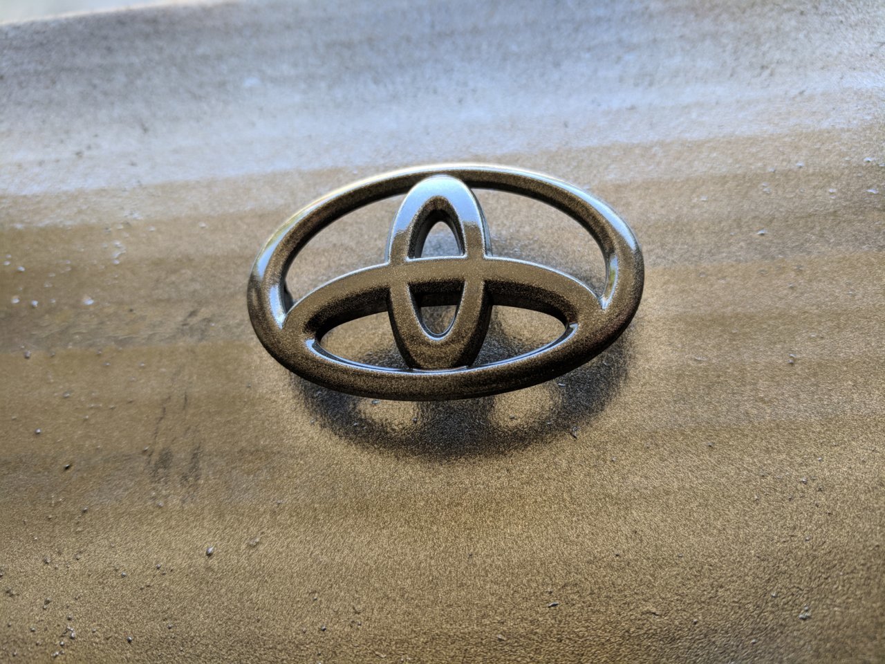

    The pièce de résistance, I painted the toyota emblems gunmetal because I think the chrome would be too much for the gloss black.
    Stay tuned, they are drying, I'll post mounted pics up later.

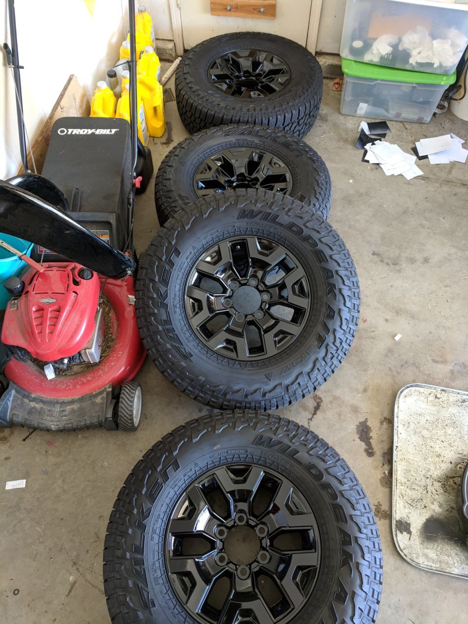

    Edit: The logos just pop off with a little pressure?
