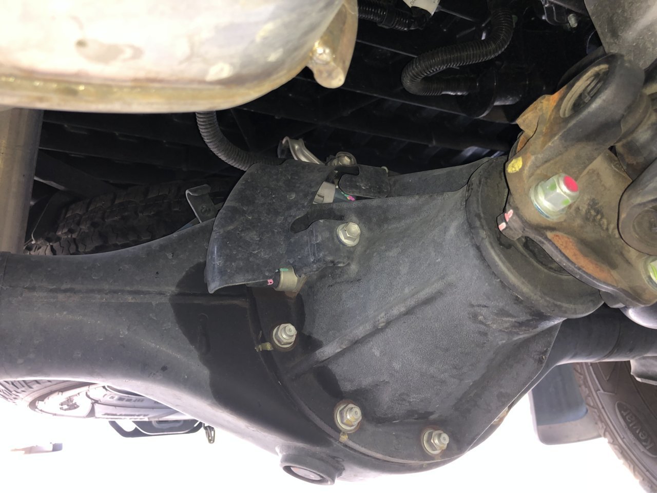

    went in for TSS recall and check my diff just prior. Of course it’s leaking, dealership agreed and are going to reseal it tomorrow. Everyone with a 2018 should probably take a look at their diff. The leak problem has not been solved yet even though the TSB is only for 2016 and 2017.

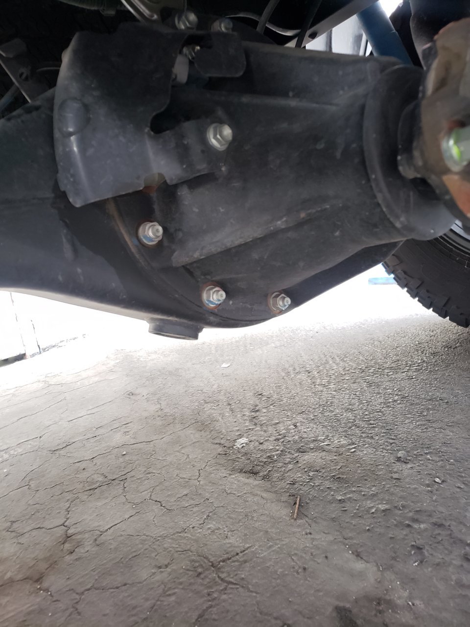

    Funny I saw this when you posted it. Finally checked my 2018 and sure enough mine is leaking too. Lovely a 1 year old truck is leaking. I've got 4 more years of payments...hope the truck makes it there.

    Looks just like mine ... looks like more of a weepage than leakage to me.

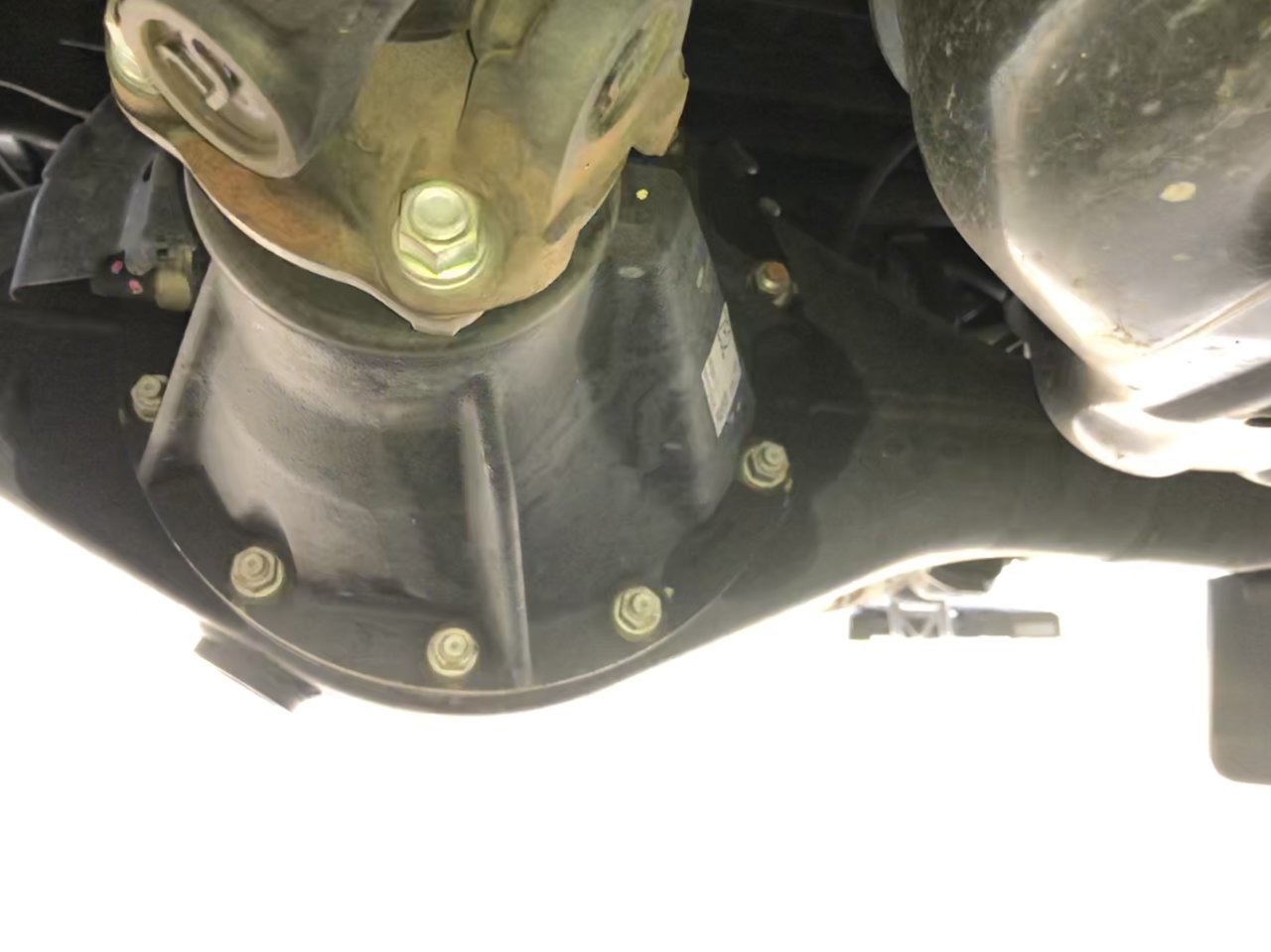

    My 2018 OR is a seeping front differential seal. I was in to the dealer today to have it replaced. Unfortunately after waiting for 2 hours they inform me that the seal they ordered in was ‘damaged in transit’ and couldn’t be used.
    They ordered a new seal and they’ll call me when it comes in. Not really inspiring confidence in the service department.

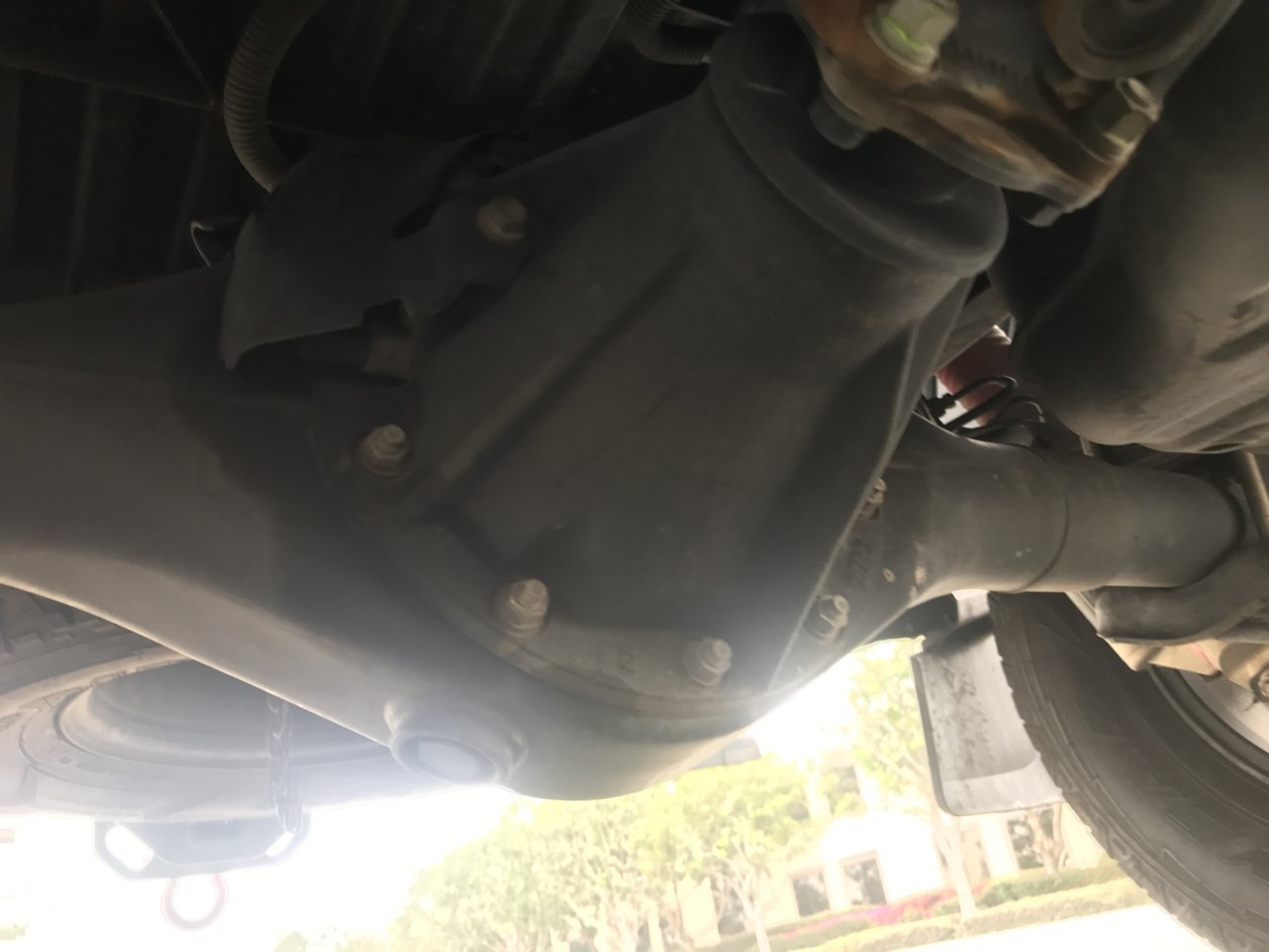

    I dunno...mine looked like some of those photos at first (0-2k miles), but it has since dried up and never come back. Seriously, bone dry. I chalked it up to seepage from manufacture. That, or my dealer tightened the bolts down at my first service and didn't bother mentioning it.
