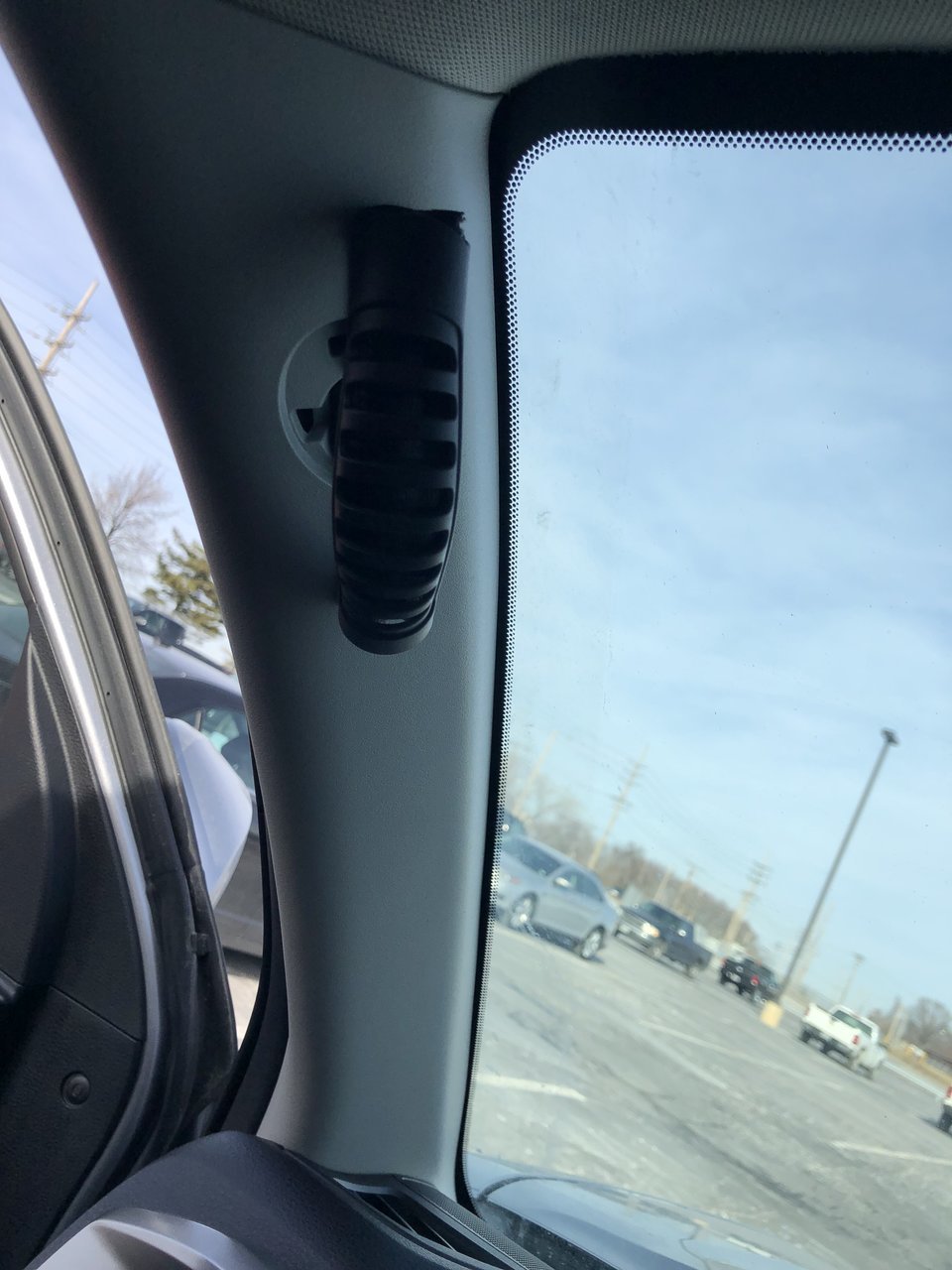

    A few people have asked about the mod. The 2015 handle will fit, but for the 2016 onward they removed the 2nd welded "nut" from the frame of the truck. So you'll have to rig something for the bolt to thread into. I just put a single nylon Smitty handle there. (underneath the SRS airbag cover) I can remove it and go back to stock whenever.

    More function over form:

    Hey nice job. Is the bolt used to mount it located under the pillar panel cap ? I Just ordered a race tech handle

    The standoff spots are there, you just need to put Rivnuts in.

    No threads, just standoff brackets with the hole.

    I believe the rivnut and bolt are in the top location under the sr5, it's the lower one that is missing and would need it if you were going for the traditional OS handle.

    So your saying the top one I want to use is threaded ? I’ll check tomorrow
