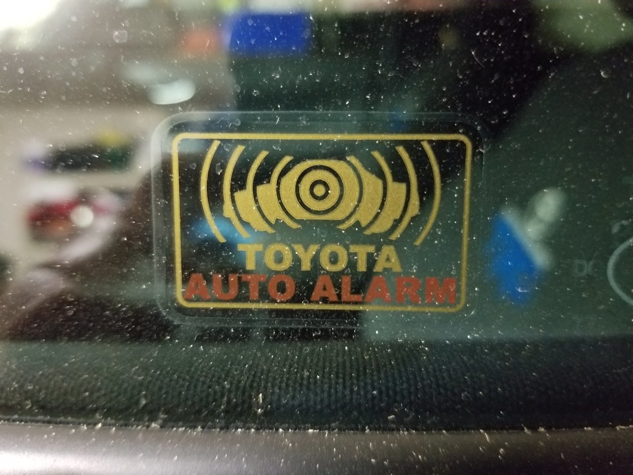

    The Toyota OEM GBS is a switch blank with a small microphone that is labeled Toyota Security. In the 2018s it is meant to be installed to the lower left of the steering wheel.
    If it's there, it should be functional without activation.
    But first step is, do you have the Toyota alarm stickers on the front seat side windows? If the alarm was factory installed, you should have those.

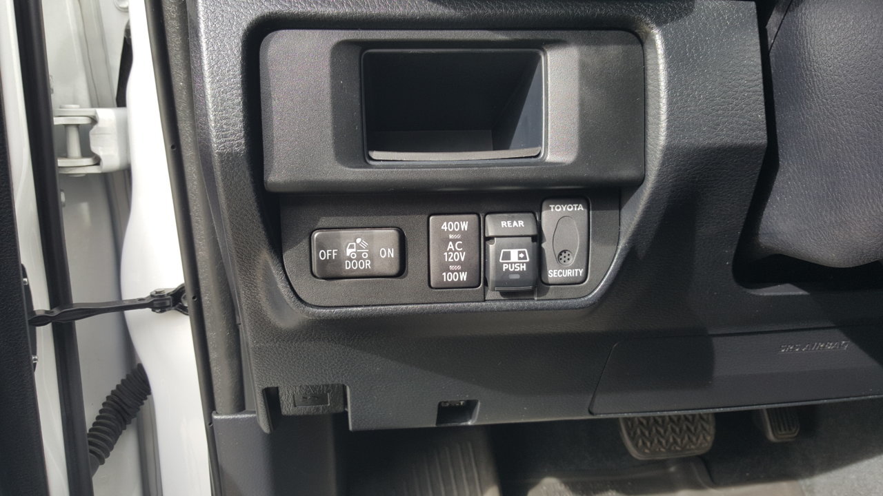

    All:
    The GBS provides an added level of security as will sound your alarm when you tap on any window with a key. The OEM GBS is installed in my 2017 4WD Limited Taco as pictured below:

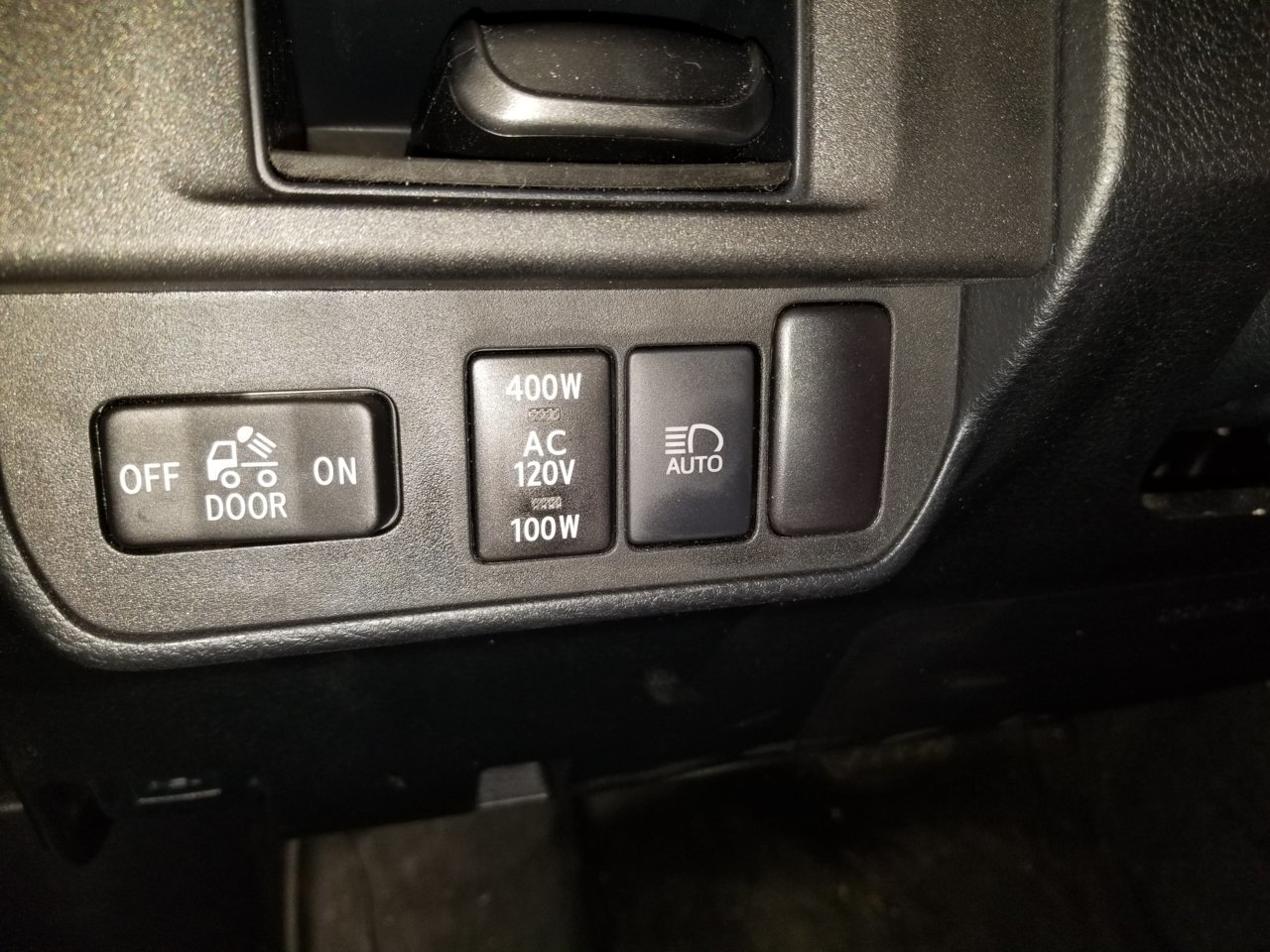

    Kinda confusing but, I think I understand. For my 2018 TRD OR, basically all we need is the GBS ECU, and whatever interface harness comes with it. provided your 2018 already has the factory alarm system. when I search the part number posted it comes up with the complete keyless security system. Amazon shows just the components of the GBS, no harness.
    I havent taken the panels off yet but I figure there has to be a connector or two unused where the GBS ECU will be located.
