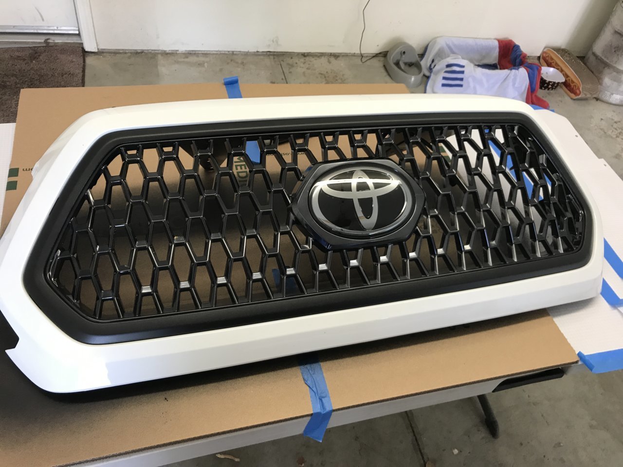

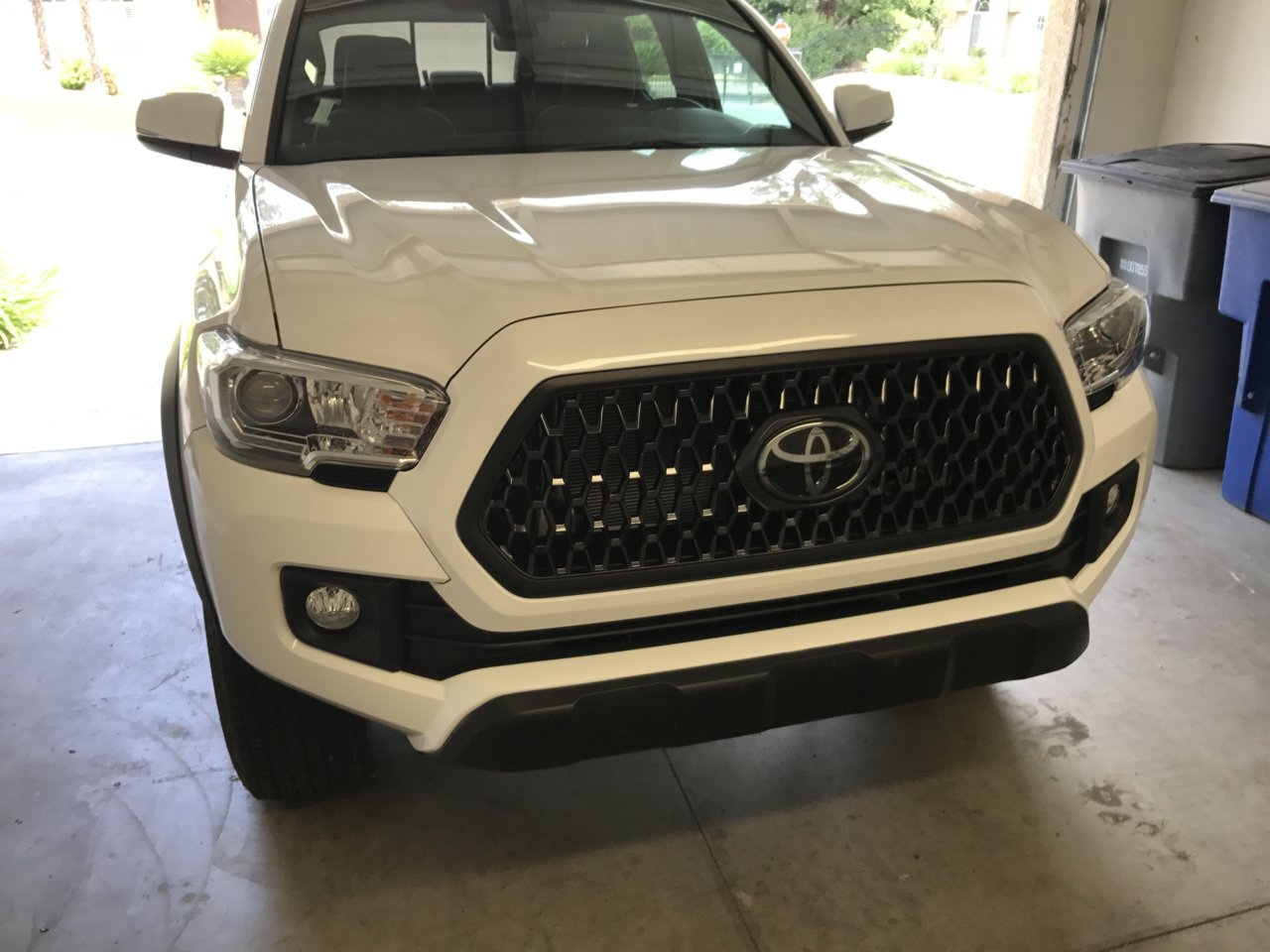

    IMG_8814.jpg IMG_8815.jpg IMG_8813.jpg Super easy to derp the chrome surround. Took me about an hour and a half with 6 coats of plastidip. 30 minutes to remove and put back together and an hour of painting.

    Any pointers removing the chrome surround from the main grille? I don't want to break any necessary clips. I'm going the SR bezel route. Yours looks dang good.

    Just do them one at a time and go around the perimeter. I used needlenose pliers, they aren't very fragile.

    dont plasti-dip it, just paint it. I spent alot of time plasti-dipping mine (did like 6 coats + satinizer) and a piece chipped off. wish i just painted it

    Like others have said, take your time on the clips. I used needle nose pliers as well. It took me awhile to figure out which clips were for the grill and which ones were for the surround. Just look up a pic/video to save some time on which clips are for what. The clips are surprisingly flexible. I didn't break any removing mine.
