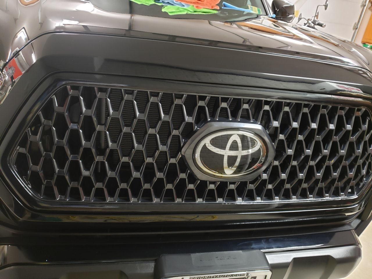

    Mine is an SR5, not an OR, but I wanted the chrome bezel blacked out so I found this thread. THANKS. I took the bezel off, didn't beak any clips, painted it black with Rustoleum "bonds to plastic" semi gloss black, and reinstalled. It looks much better. Time will tell if it is a viable alternative to replacing.

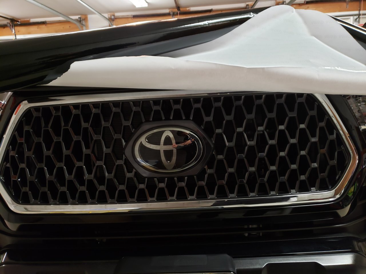

    Had some left over Vinyl wrap, so decide to
    Black out the chrome looks n so much better
