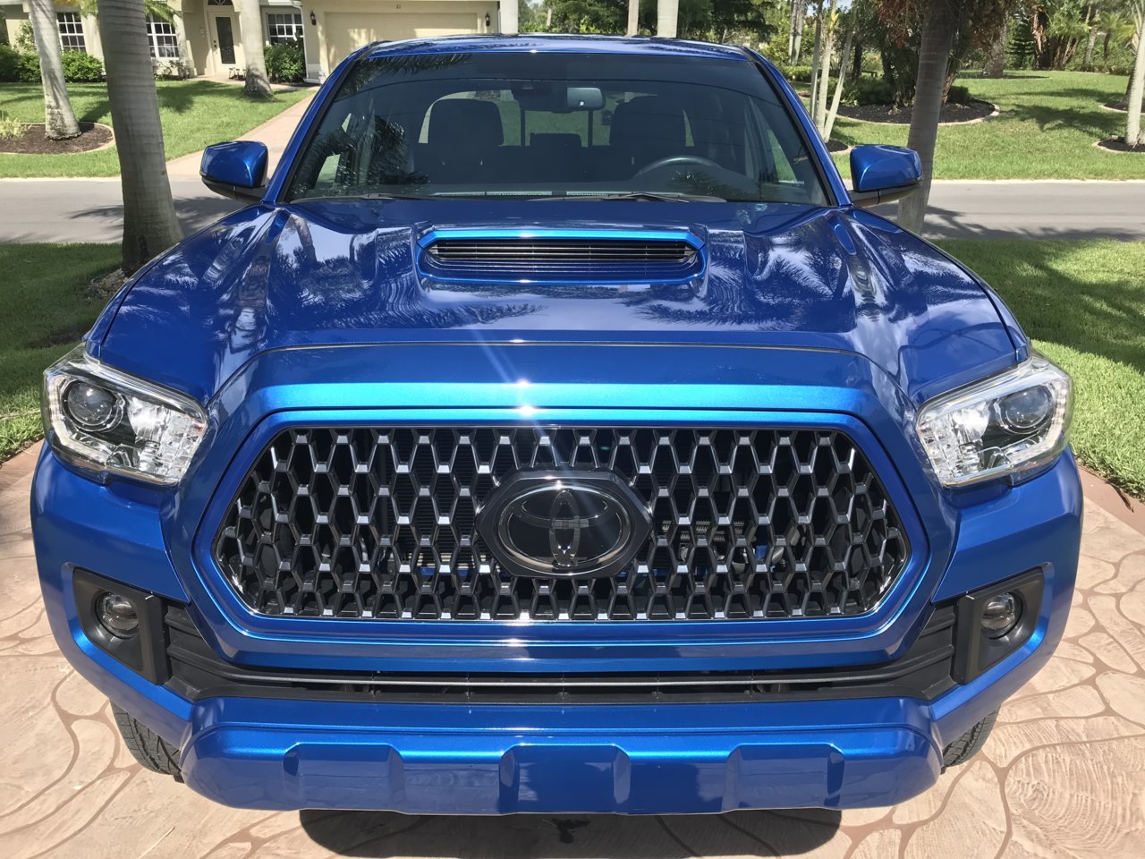

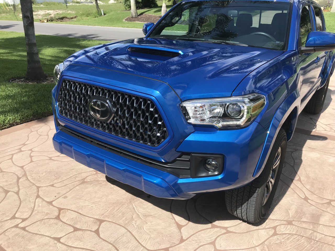

    There is a vender on here that sells painted oem sr grill surrounds . I love this look with the 2018-19 grille.

    Custom car grills sells them . You just have to pm them for a quote as it’s not listed for sale any where . Paint match was perfect as well .
