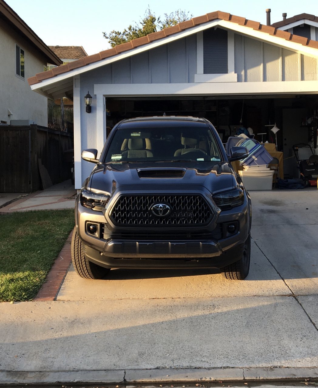

    Did this today. Ordered the SR grille bezel for about $103, with free shipping, and it got here in two days. Took 20 minutes to pull off the grille and pop the new bezel in. Much happier with this since my truck has the blackout package and that was the only chrome left. Thanks for all the tips in this thread!

    Nice. That’s what I want to do to my 2018 inferno_Only piece left that’s chrome. How difficult was it? I’m not that handy so just wondering. Lol

    Not difficult at all! Use a 10mm to get two bolts off, use a flathead screwdriver to pop two fasteners, unplug the TSS system, carefully remove the grille, then pop the chrome tabs and remove like 8 Phillips head screws. The new one pops in with its own tabs, put the screws back in, then put the grille back in and put all the bolts and fasteners back in place. Took 20 minutes.
    There’s so many videos on YouTube that make it easy for you to plan what you’re doing/look at it while you’re working on the grille. From a 1-10 difficulty, I’d honestly say 1. Super simple.

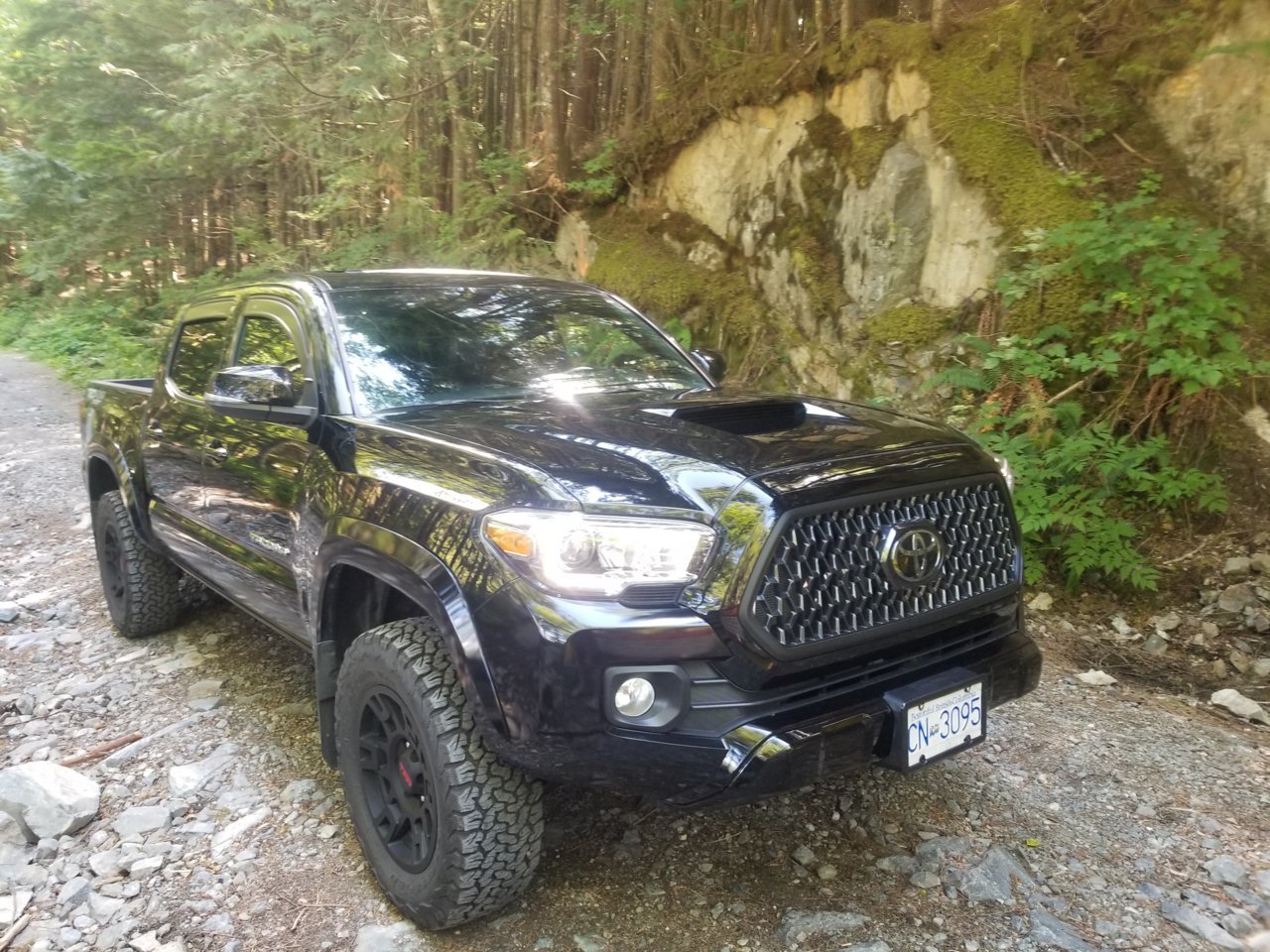

    I derped mine for now. SR bezel in the future.

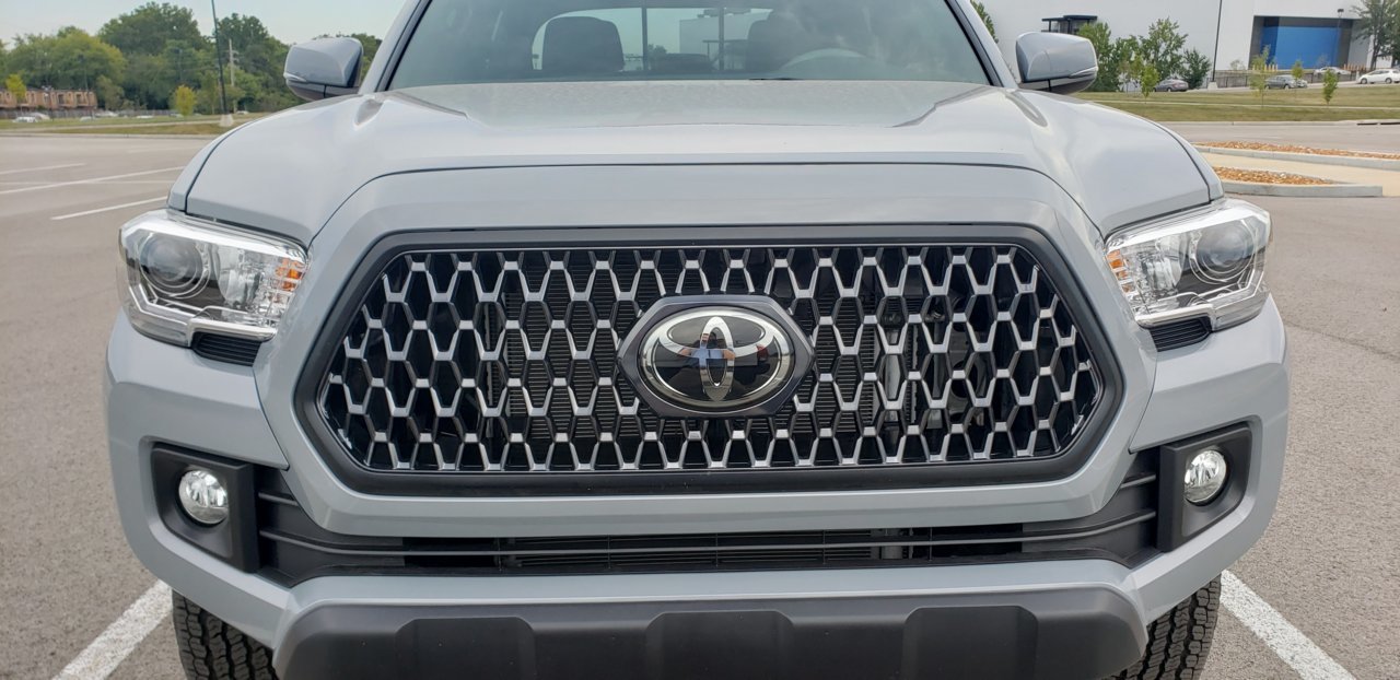

    I hope i am not too late to the game lol results: 2 broken tabs on the chrome, none on the black haha..20191009_165525.jpg 20191009_165537.jpg

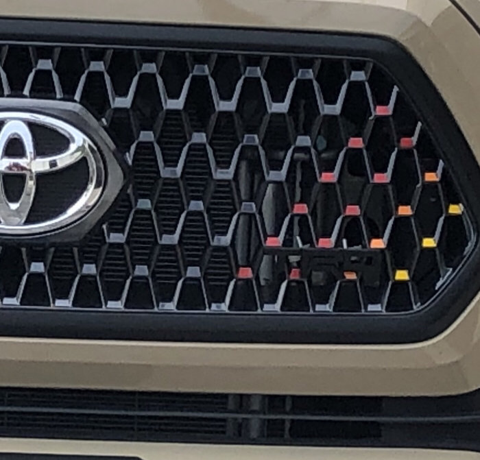

    I’m thinking in change the Toyota logo too...
    All the emblems are black with quicksand
