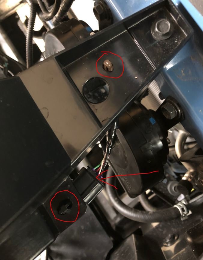

    Did it yesterday on a 19 and very happy with results. Like the stealth cheese grater!
    Good tip is to 1st release the 2 clips holding the TSS wiring harness to the supports. This allowed me to flip the connector over and easily unplug. Would have been very difficult without popping those 2 clips out 1st.

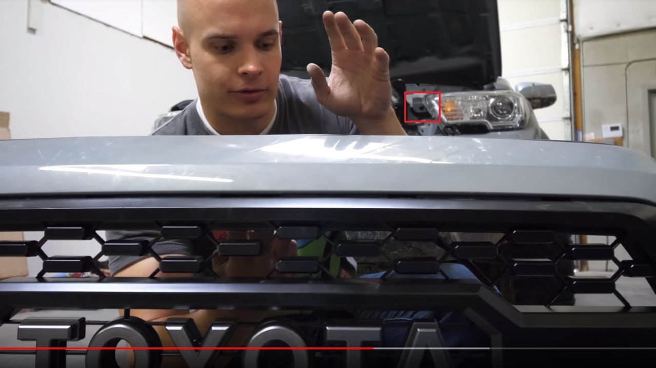

    @ 3:49 seconds in that video I posted, pause it, and look in he background and you can see the alignment holes.
