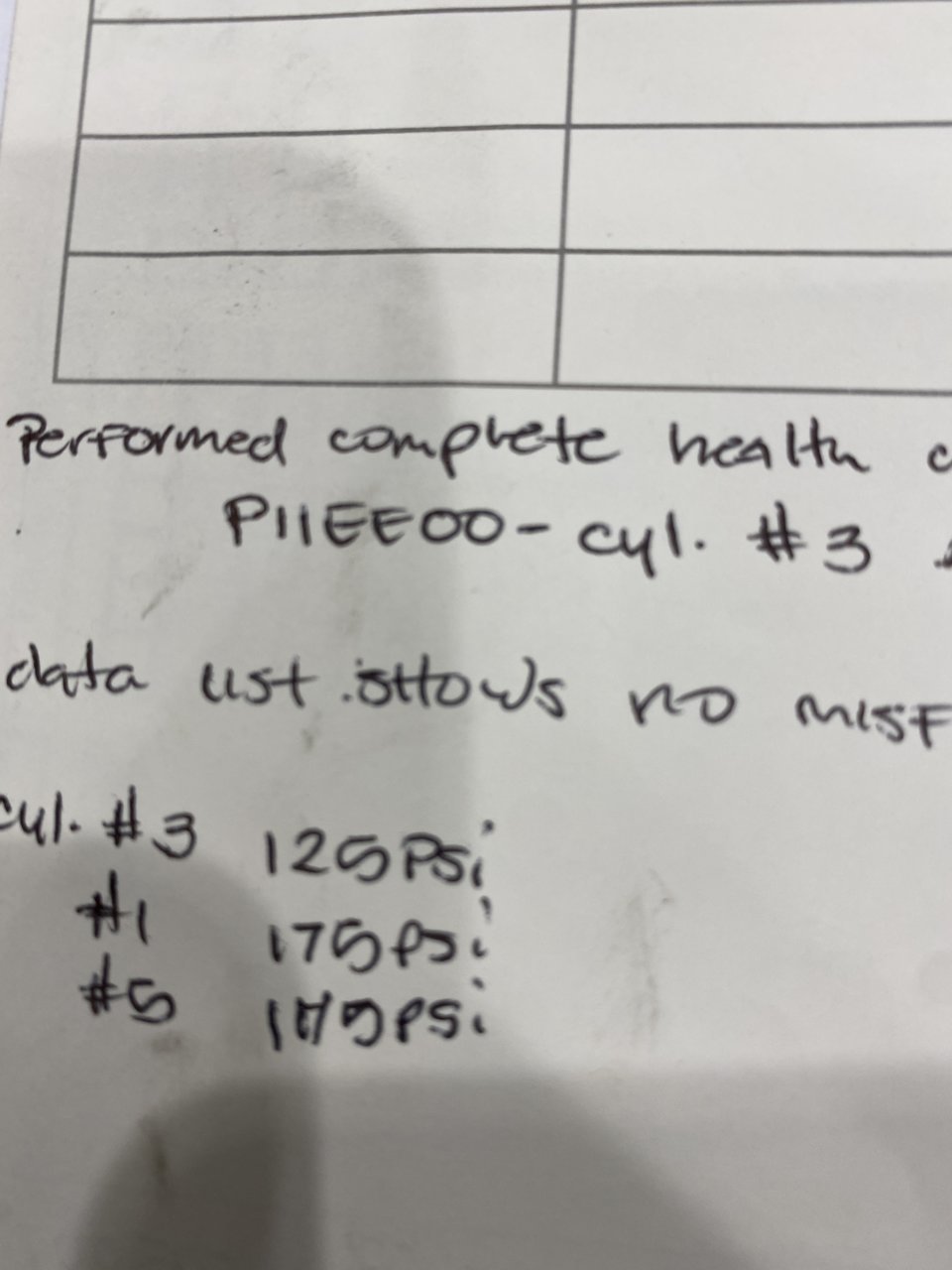

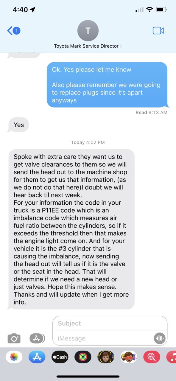

    AD8C31A8-4B62-469C-891E-79D15DAE2DF4.jpg A8D6B7EE-B184-4136-804F-2AE8F8EF37C8.jpg At 75,000 and pampered all the way only Costco gas and oil changes and all scheduled maintenance my check engine light comes on. Dealer said need to tear down engine. Week or two job. Code said one piston is getting fuel a fraction of a sec before the the other. So piston, valve , heads not sure until further test down and inspect. A cylinder Imbalance to be specific. Thank God under extended warranty. Question. Would she be just as good coming out or further issues to come. Do I clear the code and take the huge trade in everyone is offering and get something new? I Know that sounds sketchy to do. But I dont want to get her back if this is a crack in her “tacoma bullet proof” armor
    i thought these things lasted for every of treated right
    update: burnt valve
    Down 3 weeks
    Rental truck
    Repair estimate $3500
    $0 deductible
    I’m so glad I bought extended warranty
    so cylinder 3 is having issue. Not sure what code that is. Gave me 2022 Tacoma rental. I have to say. I was gonna trade mine in for a new one but after talking to the tech she’ll
    Be like new again. I had them install new plugs since she’s apart anyway.
    7/22
    Machine shop found no cracks in head but 4 burnt valves need replacement we are going into week 5
    8/15/22
    finally got case manager from Toyota to take over my case. National part shortage for head gasket set was NO ETA but revised yesterday to 8/31/22. So it’ll be on the rack 9 weeks at least before she’s back home.

    What is the code number that the scan revealed?
    Curious why what you describe as a fuel injection issue requires a teardown to resolve. There's more to the story...........

    Why would that require an engine tear-down? Sounds like an injector/ECU problem. Could also be an ground/wire issue. Relative piston position to the others is not going to change unless you break the crank (which obviously didn't happen), and the valves do not dictate when the injector fires. Strange.

    WAT??? That, if you explained what they said properly, rates as one of the dumbest dealer/mechanic things ever said. The ONLY thing I can make of it is that it's a timing thing where the timing chain or tensioner has failed and the computer caught it.

    This sounds like the P11EC problem.

    what code is it throwing?
